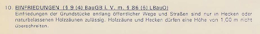

Are there any requirements for fences, retaining walls, or similar at the street side in the development plan?As far as I know, there are no planning documents from the street side; the development area is already about 30 years old. There are neither curbs nor sidewalks—the street is an extension of the old village center, which is quite narrow, so none exist there. We will inquire if anything is planned.
As I said, we will do most of the earthworks ourselves, which makes the solution relatively affordable. We have many family members who have built or helped build several houses.
We will keep the gutter/water drainage in front of the house in mind. The development plan only states the following requirement for fences:
