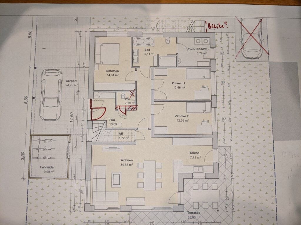

allstar832 Apr 2020 21:09Hello everyone,
I would like to share our planning for evaluation by the forum.
Last year, I already made a post here to collect initial ideas.
However, due to many different variations on my part, it became somewhat confusing. So here is everything from the beginning.
Thanks in advance.

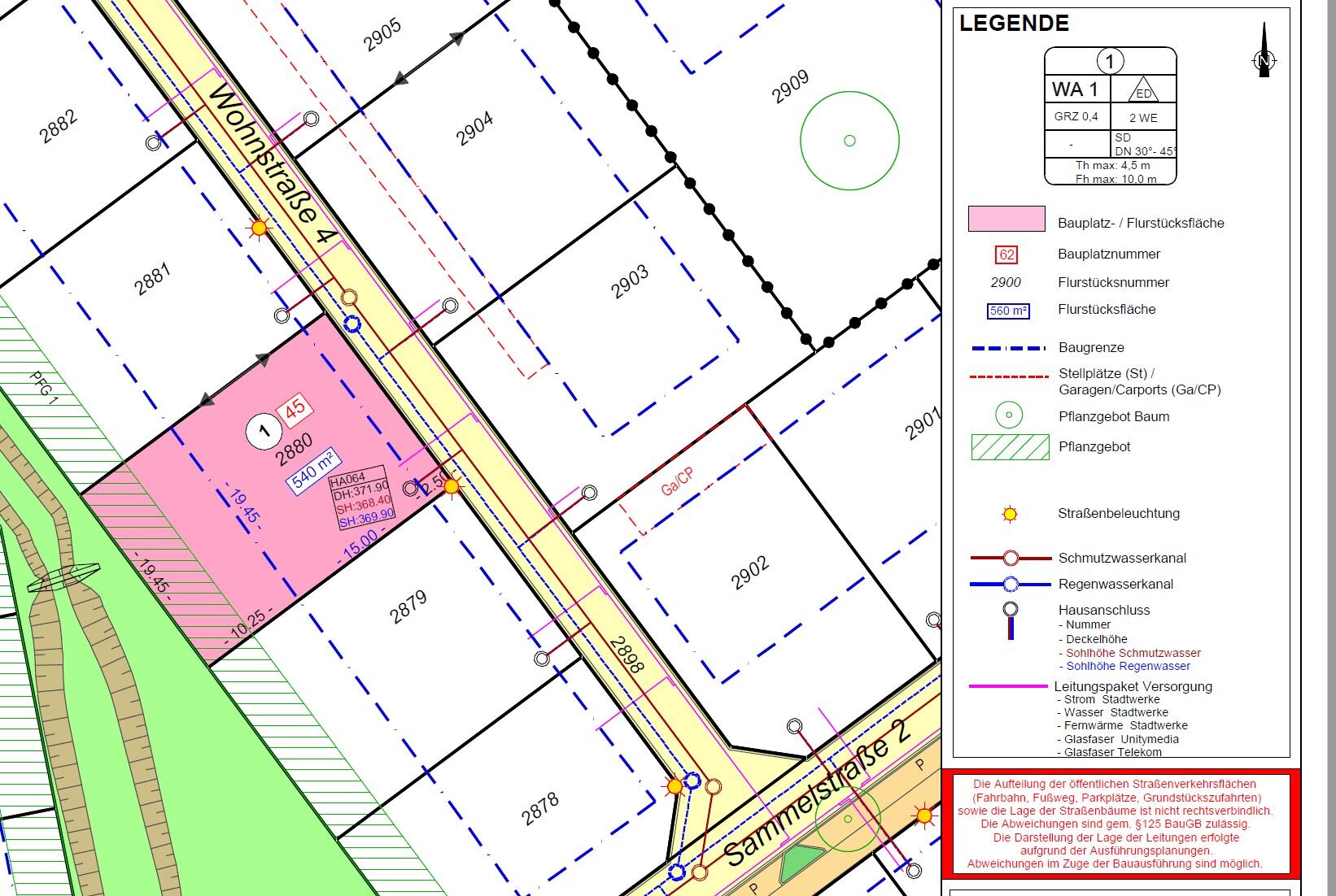

Plot size: 540 sqm (5800 sq ft)
Terrain: flat
Floor area ratio (FAR): 0.4
Gross floor area ratio (GFA): ...
Building envelope, building line and boundary: see screenshot

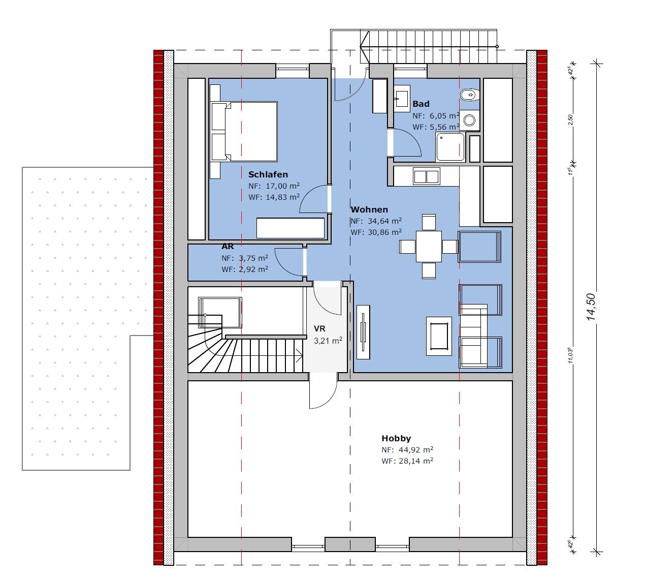

- We want to live and sleep on one level
- Hobby, office replacement or storage in the attic instead of basement
- Due to possible double access to KfW subsidies (=36k), the attic expansion as a granny flat could be an option – as the rooms are already there. This depends on final cost considerations.
- Carport with canopy towards the entrance
- A bicycle garage is important to us
- Building site in Baden-Württemberg (BW)

What do you like most? Why? No stairs for daily living
What do you dislike? Why? Entrance area might be a bit small
Estimated price by architect/planner: approx. 400k+ for KfW55 house

What do you think is particularly good or bad about it?
- I personally like the orientation towards the garden with the adjacent green strip
- There are some compromises
- The utility/technical room should be pure technical use, not a utility room (for district heating, electricity, washing machine, controlled ventilation, etc.)
- Furniture sizes, orientation and door swings still need adjustment in parts
