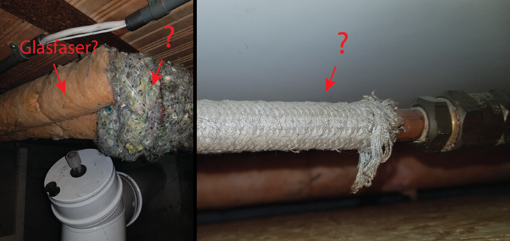

What I have already noticed is that the heating pipes are covered with exposed insulation. The heating system was replaced in 2016, but I am not sure about the materials used:
[IMG alt="IsolierungCol-01(1).png"]https://www.hausbau-forum.de/data/attachments/59/59062-1a3397cac8af18def274fe1d43738b70.jpg[/IMG]
I assume one of the materials is fiberglass; I am not sure about the grey material.
- My second question is what these materials might be (and whether they are hazardous), and how to deal with them? I would probably just cover them with wood paneling.

knalltüte5 Apr 2021 18:27The insulation on the heating pipes looks like it dates from around 1970–1980. We had something similar. Most likely, beneath the gray, fairly thick plastic covering, there is unpleasantly itchy glass wool. In my opinion, the other types of insulation are probably not harmful to health either. However, you can only be sure if a professional examines it or tests a sample.
But you don’t suspect asbestos installed 150 years ago, right? Rather, as part of a renovation? As far as I know, asbestos is largely harmless as long as it is not cut or disturbed because no dust is released. You can finish the workshop nicely with drywall (seal everything dust-tight) — and that’s it.
