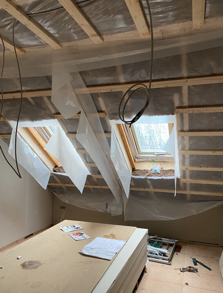

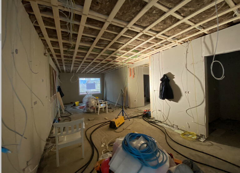

That won’t be possible. You can no longer thread the cables from hole to hole. The drywall panels are screwed onto metal studs. So, there is always a break in one direction. The cable for the recessed lights must already be installed during the installation of the substructure. That’s a shame, but thanks for the information. We wanted to do it ourselves as well. Do you have any idea why they charge so much for it? I don’t think it’s such a big deal.

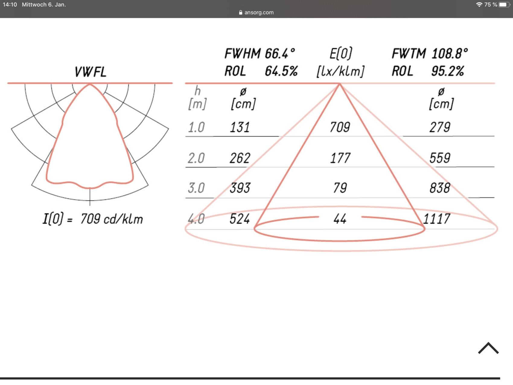

hampshire6 Jan 2021 14:20We installed 3000K high CRI recessed downlights with VEFL (very wide flood) reflectors in 130mm (5 inches) diameter holes and 150mm (6 inches) depth in the entrance area, featuring the following characteristics:
We are very satisfied with these. The same type of luminaire with a different 2700K color temperature is used in the patio roof and as spotlights on a track in the living area; here again 3000K but with a narrower beam angle. Of course, this does not replace ambient lighting.
Since the fixtures produce 2800 lumens of light output each without dimming, it can get very bright when needed – for example, during cleaning.
Have a look at ansorg...
