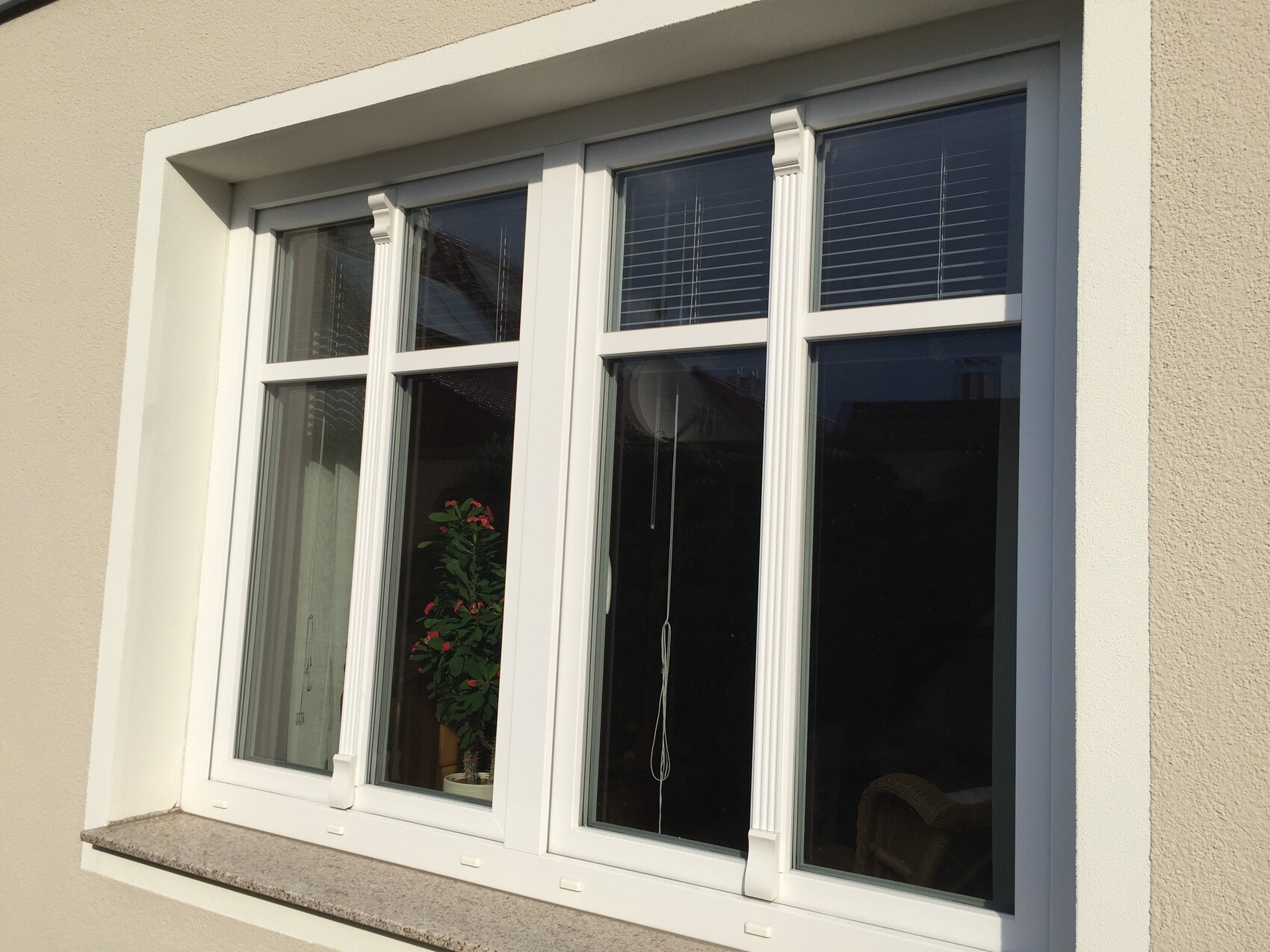

Hello Pinki, you asked for more tips to create a nostalgic charm. In addition to the decorative moldings, we decided to use so-called window capitals, which are also available for uPVC windows. They significantly enhance a standard window. Additional cost for all windows is 1000 EUR.
Exterior view of a three-part white window frame with columns, sky reflection in the glass
White window frame on beige wall; plant with pink flowers visible through the window.

That’s a really great idea and truly exceptionally appealing. It’s going straight onto my list. Thanks.
