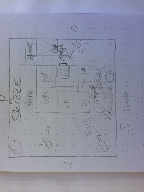

@ypg you are right, I will have to redraw a site plan based on your suggestions. It seems a complete restart/redesign is unavoidable. I would like to involve an external planner, but the problem is the costs – our budget is very limited.
Thanks also for the sketch, that is a good idea – we were also unsure about the overall shape (square versus rectangle). Should we really move away from considering the south side as the main facade and rather plan to focus on the west? What is the most practical way to arrange the rooms? Should the north side not be neglected entirely? In our case, the neighboring properties have their south sides facing north.

My sketch is a standard floor plan that you can get inexpensively from many home builders.
A west-facing garden gets enough sunlight. The north side will also receive sunlight, but natural light will be somewhat reduced in those rooms. An office and a west-facing living room can still work well in such locations.
Draw your plot including neighboring buildings and consider where you want natural light inside as well as quiet or social areas in the garden.
