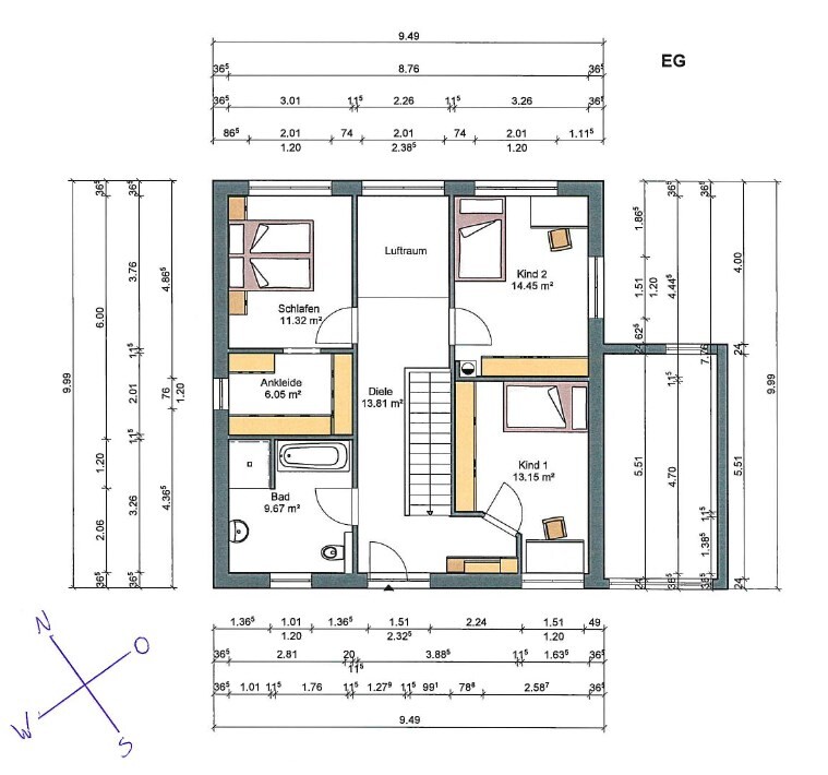

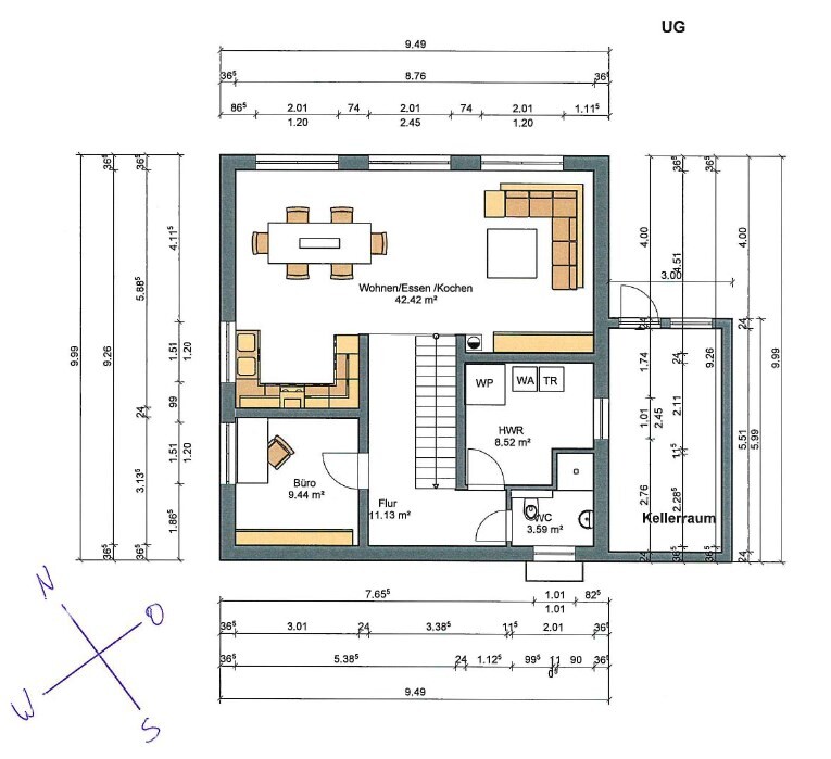

ᐅ Floor plan for a house on a hillside (ground floor and basement living area) with a maximum of 150 m²
Created on: 2 Feb 2019 14:27
Pamiko
we are currently working on the floor plan for our house. We already have the plot, which is on a sloping site.
We have decided to build a two-story house, with the upper floor (sleeping area) providing access to the street and the lower floor serving as the living area with garden access.
We want a manageable house size, but due to the requirements for the living floor, a minimum of about 140m² (1505 sq ft) is necessary. However, it definitely should not exceed 150m² (1615 sq ft).
We want a modern touch or something distinctive. For example, because of the great view, we considered a window seat. Ultimately, we decided on a small open space with a large window facing the backyard.
We really like the lower floor; the ground floor is not yet one hundred percent right.
Since I have been a long-time forum reader, I want to mention upfront that optimizing every last bit of available space is not a must for me. I am aware that, for example, a lot of space is used for corridors. Given the house’s orientation (there are no alternatives here), I think this is necessary to avoid a cramped feeling.
I would appreciate any feedback or suggestions.

Style, roof form, building type: city villa style with the special feature that, due to the slope, the entrance is on the upper of the two floors. The lower floor is fully embedded at the street side and opens to the back.

Room requirements on ground floor, upper floor: living floor must have at least one (small) room. Living, dining, kitchen combined approx. 45m² (480 sq ft), guest toilet with shower

What do you particularly like? Why?: like the lower floor; open space, room sizes fit well
What do you dislike? Why?: children’s room next to the garage

- cannot give up: room sizes of lower floor; open space

How can the ground floor be changed so that the children’s room is not next to the garage? I can’t find a suitable solution with the current plan. The staircase cannot be moved due to the basement (the guest toilet and utility room would otherwise become too small).

Actually, the goal is more to steer you away from your floor plan. I don’t find it good, especially the kitchen/dining/living area, then the location of the children's rooms, the layout for the parents... and above all, more than 20m² (215 sq ft) for the hallway, stairs, and open space on the upper floor.

I just feel like I’m being pushed toward this floor plan in the recent posts.Yes, I feel that way too, and that was never my intention.However, I don’t really like the new floor plan either. The kitchen just looks really ugly—air space or not. And the living room feels very cramped, doesn’t it?
Regarding the daylight spot, I would suggest you look it up again to see what it is exactly. It’s a great way to bring natural light through a hip roof.
What about that storage room under the garage? Would it be an option to include it within the thermal envelope of the basement? It would have to be founded anyway, and I don’t see thicker walls and connecting it as a big problem or much more expensive. Although I’m not an expert on that.
That would give you a lot more options—for example, placing the guest room there. For the ground floor, I think it’s important to keep the full-width opening to the garden in the living room.

Including the storage room within the thermal envelope is out of the question, mainly because we need the storage space. It is basically our basement substitute.

Hmm, think carefully about what should and can go in there. A basement is usually connected to the thermal envelope of the house and doesn’t freeze. Basically, an unheated room without insulation can only store garden tools, trash, or things like bikes and similar items. What won’t work here are all kinds of fabrics, most foods, most liquids, paper, etc.—basically anything that can’t withstand weather conditions over time. In my opinion, this is not a substitute for a basement. In the end, you end up with an expensive storage shed that you could have placed anywhere in the garden as a simple wooden shed without a building permit / planning permission for around 1000 euros.Similar topics
