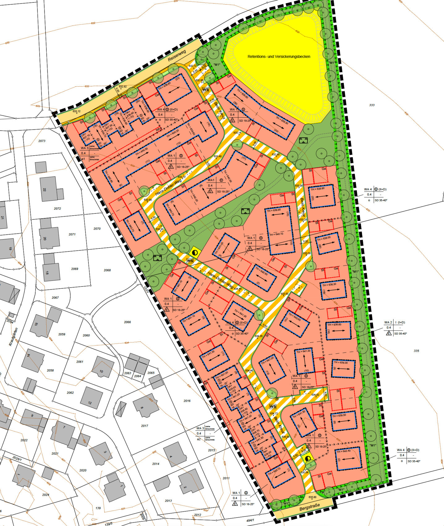

What exactly do you consider a "comfortable" garden size? When plots are limited and demand is high, I wouldn’t hesitate to make the most of the available space. However, don’t expect a garden large enough for a soccer field.
The north-south orientation is good, the building plot isn’t huge but acceptable, the size is probably still affordable. The planned tree from the city to the south offers protection and possibly some shade. A downside might be the long street frontage, which should be factored into the planning. Both the hedge and decorative fence will need to be paid for. Snow removal in winter will likely require a snow blower if you don’t want to be late for work.
It would also be helpful to know more about the immediate surroundings to make a better assessment. For example, is there a gas station, daycare, playground, landfill, etc. nearby?
K a t j a26 Jul 2024 07:03
Addendum: The excerpt does not even show the entire property. In addition, the details of the zoning plan / building permit are missing. The surroundings are also not visible. You should provide us with a bit more information.

One possible drawback might be the long street-facing side. This should definitely be factored in during the planning stage. Both the hedge and decorative fence will need to be budgeted for.
That would be the biggest issue for me. To feel comfortable, I would need to plan for plenty of privacy measures, like a hedge and so on. But people’s preferences vary :-) Otherwise, it’s definitely doable and sufficient, depending on individual requirements and wishes.

The residential area borders an existing neighborhood. There is a daycare in the village; a playground or play area is planned further north in the residential area. There is no landfill nearby. Here is a larger excerpt from the land use plan:
Overview map of a residential area: red blocks, yellow basin, green spaces and trees.
