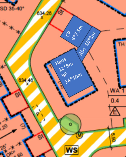

My girlfriend and I have reserved the following building plot through a selection process within a development area:
We are still considering whether to ultimately take the plot. We have until early September to decide. We are still at the very beginning of the process. Regarding the orientation of the plot, it is actually quite good (the main entrance could be placed on the north side, with the garden on the south and west sides). What do you think about the feasibility of building a single-family house on this plot?
Plot size: approx. 552m2 (5940 sq ft)
Slope: no
Floor area ratio (FAR): 0.4
Gross floor area ratio (GFA): not specified
Edge development: no
Number of parking spaces: 1
Number of stories: mandatory 2
Roof type: gable roof
Architectural style: modern
Orientation: see screenshot
Maximum heights/limits: eaves height 6.41m (21 ft)
Other requirements: roof pitch 18–25 degrees
Homeowner Requirements
Basement, number of floors: 2
Number of occupants, age: 2, aged 34 and 35
Space requirements on ground floor and upper floor: not yet finalized, aiming for a total living area of 180m2 (1940 sq ft)
Office: family use or home office? Both, both working from home
Number of overnight guests per year: 2-3
Open or closed layout: open
Open kitchen, kitchen island: open, kitchen island
Number of dining seats: 4-6
Fireplace: yes
Music/surround system: 5.1 system, but should be integrated into the living room
Balcony, roof terrace: yes, if possible
Garage, carport: garage
Utility garden, greenhouse: possibly a greenhouse at a later stage
Additional wishes/particulars/daily routine, also reasons for certain preferences or exclusions
Are there any factors we should additionally consider in our evaluation and decision?
Is the desired house size compatible with maintaining a pleasant garden area on this plot?
Thank you very much for your input in advance.

hanghaus202326 Jul 2024 18:25H
hanghaus202326 Jul 2024 19:23Is it the
Development area 'Krautgärten II' 88400 Biberach

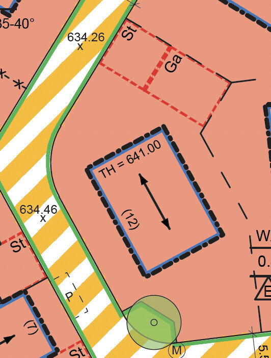

nordanney26 Jul 2024 19:40re4p3r88 schrieb:
The eaves height should be around 6.21 m (20.4 feet) for all of them.How do you determine the eaves height? In the development plan, the eaves heights are specified relative to sea level. So for your location, it’s 641 meters (2103 feet) above sea level.
hanghaus2023 schrieb:
I probably would have chosen a different one. But most likely, you rarely get a choice. If you really had the luxury of choice.
Just out of curiosity: which one would you have picked?
hanghaus202327 Jul 2024 10:26nordanney schrieb:
How do you determine the eaves height? The land development plan specifies the eaves heights relative to sea level.
So in your case, 641 meters (2103 feet) above sea level.There are reference elevation points at the roads.M
Just out of curiosity: which one would you have picked? Number 7, 1, 5, 4. In that order.
