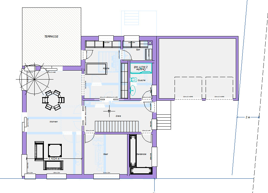

We have placed the house “diagonally” within the building envelope so that it fits flush with the diagonally shaped right edge of the building area, as stated above in the checklist. The house walls run parallel to the right neighbor. The reason is that, while we want to enjoy the southwest sun coming from the left neighbor side, we also want to slightly turn away from visibility from the street and opposite neighbors. Another reason is to build as far away as possible from our higher left neighbor who casts long shadows in winter, so more sunlight can reach our windows. For brightness reasons, I also planned the garage detached from the house on the left southwest edge; it should be built as low as possible and in winter not cause significantly more shadowing than the neighboring buildings already do.
The terrace, visible from the street through the gap between garage and house, will be screened with a hedge.
My design was partly inspired by the floor plan of a used property we visited. There, as a striking feature upon entering, you looked at a tall plant growing through a 1x1 m (3.3x3.3 feet) ceiling opening next to the left end of the stairs reaching to the upper floor. The idea is to plan the ceiling opening large enough to allow the retrofitting of a vertical lift in the future. The gallery/open volume was positioned in that house similarly to ours, which we liked. The entrance vestibule (windfang) is primarily intended to avoid drafts, since our terrace door is often open. I initially placed the cloakroom behind the vestibule, open to the living area, so that the vestibule door would not interfere with a possible lift solution and its required maneuvering space.

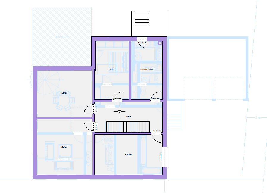

On the ground floor, a wall is drawn next to the staircase (above it on the plan) which I assume might be a necessary load-bearing wall due to the large open living-dining “hall.” This wall continues through the basement and upper floor and also serves as practical room separation there.

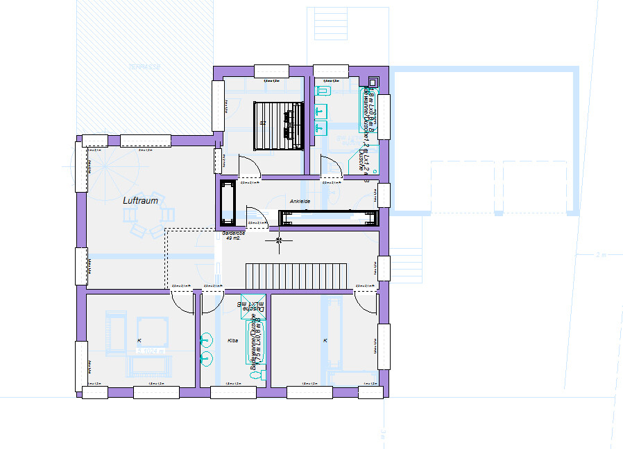

In the upstairs plan, I placed the walk-in closet between the bedroom and bathroom, intentionally separating it again from the bedroom by a door. The reason is our current experience where our bedroom is only separated from the bathroom by a thin wall, and even with the door closed, there is still too much noise from the bathroom. I still consider this solution slightly imperfect but would not want to reduce the open volume too much. The very large bed planned for the bedroom should be a 2.7 m (8.9 feet) wide family bed. Space next to it is somewhat tight. If I place it on the opposite exterior wall, it would conflict with the wish for windows on the sunny side, wouldn’t it?
The open volume is a long-standing wish we don’t want to give up, even if it requires, for example, soundproof doors for the children’s rooms.
Since this is only a semi-finished draft of the room layout, I would greatly appreciate any critiques and ideas so I can incorporate them into the architect’s planning from the beginning. We would also like to save a few square meters if possible and sensible.
Thank you in advance for all suggestions!
Site plan of a building plot with house, garage, and terrace
Floor plan of a house: open living-dining area with furniture, kitchen, guest WC, office/guest room, terrace
Upper floor plan: parents’ bedroom, dressing room, bathroom, hallway, child 1, child 2, children’s bathroom, open volume
Floor plan of a building with 7 rooms: pantry, storage, office, corridor, technical room, laundry cellar, cellar

In this case, it might be your air space with the plant: the plant is shown, but the air space itself isn’t marked anywhere. Why not? Could it be that a winding path is created upstairs to go around the plant — in other words, around a crooked air space?????
ltenzer schrieb:
The air space is not fully outlined in the upper floor plan; you just have to imagine the continuous line starting as a wall on the left next to the door to the master bedroom.
ltenzer schrieb:
- It’s not a corridor; maybe I should have drawn a partition wall there. Between the stairs and guest/office room, we want to add two built-in closets. One accessible from the living room in the left half of that niche, and one accessible from the hallway on the right side.
For this: just draw a box representing a closet; the program will handle that too. Then you roughly have one built-in closet about one meter deep (big enough to crawl into?)
ltenzer schrieb:
I first placed the coat rack behind the entrance area, open to the living space, so the entrance door would not block a possible elevator solution and the required maneuvering space around it.
This can work, but then everyone wears their street clothes right into the dining area. Won’t that likely lead to jackets ending up on a chair instead? They’ll be worn again the next day anyway. What I don’t understand here is the argument about an elevator that doesn’t even exist.
ltenzer schrieb:
We now have the dining room as a passage between the kitchen and living room, and we actually like it that way. No strangers pass by, and we usually don’t spend too much time at the dining table. We prefer to lounge on the couch in daily life and sometimes eat there as well.
We also have a dining area as a central point. But we don’t have children. With kids, I would definitely want to give the dining area some peace, since it’s also used for early schoolwork. When everyone’s crafting and the table is in use, chairs just get in the way wherever they stand... they’re a nuisance.
ltenzer schrieb:
We don’t want to separate the areas so that everyone can maintain visual contact.
Yes, you like each other, you love each other — and eye contact is nice. But if the wife wants to host a social evening, the husband has friends over, or one of the children invites multiple friends and each family member deserves their privacy, and the teen invites three girlfriends for a pasta night, then it might become a burden that everything is so open.

Yes, you would have to go around that “planted open space with potential elevator” area. I hadn’t decided yet how large that shaft should be or from which side the elevator would be accessed. Such an elevator could be planned within the large open space in case stairs become difficult or a wheelchair is needed. In that case, the dining table would just have to be moved.
I really liked the centrally placed multi-story plant visible from the entrance in the house we toured, so I wanted to include it visibly in the plan. But it’s really a nice-to-have feature and we could manage without it if necessary.
That’s possible, but then everyone would be walking through the dining area in their street clothes. Won’t that just turn into a chair where the jacket gets hung? It’s usually worn again the next day anyway.
That’s exactly what’s happening now because we have a very small cloakroom, which is usually blocked by the stroller and car seat. That’s why I made the cloakroom area larger so I can store everything right when I come home (backpack + jacket + shoes) plus anything I want to take in the car the next morning (e.g., reading material for break + snacks). Right now, all that stuff ends up scattered on the dining table.
Of course, in a fairly open floor plan you could consider the entrance area part of the dining space, but for me it’s far from that. Also, after work, I sit in the living room still wearing my street clothes; we don’t have a ritual of immediately changing clothes upon entering the house, aside from changing from outdoor shoes to slippers.
What I don’t understand is the “elevator” argument, which doesn’t even exist.
The idea is just to consider that option in case it becomes necessary later. Cutting through a ceiling afterward would be quite involved and messy. The elevator would fit in the large open space, and hopefully we’ll never need it.
We also have the dining area as a central hub. But we don’t have children. With kids, I would definitely want to give the dining area some quiet space, since it’s also used for homework. And if crafting or working at the table is happening, the chairs are always in the way, no matter where… they’re a nuisance.
For us, dining and living areas belong together. When we sit at the dining table, it’s with the children too, or the kids play around us. We only eat as a couple when the kids are asleep, and then usually in the living room in front of the TV. While the little ones are still noisy, they have to be supervised anyway. The idea of being able to eat separately and quietly away from them spatially doesn’t seem realistic to me, nor do I want that. When they move out, the house will be quiet enough. Until then, we enjoy all of it, including the associated hustle and bustle. But the dining table in my plan definitely didn’t have enough space to push chairs aside, so I need to fix that. Kahos’s suggestion to change the stairs will help me with that.
Yes, you like each other and love each other. Eye contact is fine. But if the wife wants to host a party, the husband has friends over, or one of the kids invites several friends for dinner (where everyone deserves privacy), such an extremely open plan can become a burden.

Here’s another experiment with the kitchen separated and the dining table included in the living room:
Floor plan of a house: Central hallway, living area on the left, terrace top left, guest room, bathroom.
Floor plan: Staircase, corridor, bedroom, kitchen, bathroom, walk-in closet, open space.
Basement floor plan with cellars, hallway, utility/technical room, and stairs.
