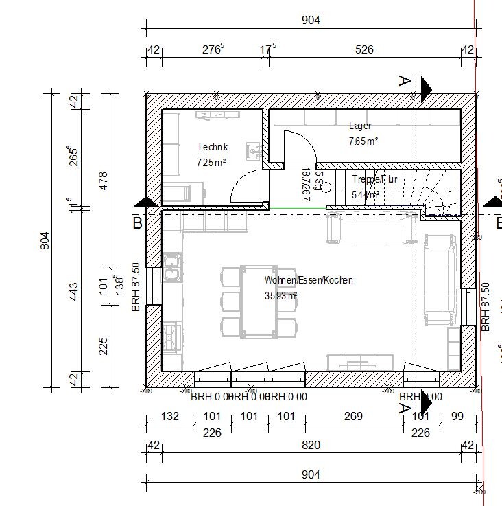

Ground floor plan, house size 8x9m (26x30 feet), oriented north.

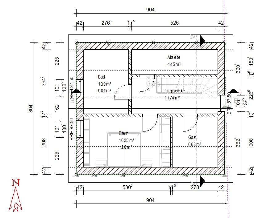

Upper floor plan, knee wall currently 1m (3 feet), but will probably be smaller.

Ground floor: living, dining, kitchen, guest room, shower bathroom with washer-dryer
Upper floor: 3 bedrooms, bathroom
Basement: workshop, storage room, possibly utility room; due to the gentle slope, the guest room could also be placed on the south side of the basement with exposed basement windows. I grew up like this and really liked it.

The upper floor is not quite right yet:
- The "hallway" upstairs is a windowless micro-room with four doors due to maximum space optimization.
- The children’s rooms are about 12m² (130 sq ft) very small; I would prefer them to be 2–3m³ (70–100 cubic feet) larger, at the expense of the bathroom and master bedroom, but I don’t know how.
- I don’t like sloping ceilings where I can hit my head. That would drive me crazy.

Basement with
- Living/Dining/Kitchen
- Utility room
- Storage room
- Staircase leading upstairs

Attic floor with (floor area and calculated living area indicated)
- Parents’ bedroom
- Small guest room
- Bathroom
- Storage space for suitcases, etc., mostly under 2 m (6.5 ft) in height

Possible floor plans:
Elevations and section:
Which of the windows on the east side could actually be built would need to depend on the design of the adjacent semi-detached house.

[…] Staircase... everyone first has to walk through the living area (how are you supposed to place sofas, etc., there?) to get to the upper floor.
Yes, the idea was a clean apartment with a “communicative,” central living area.
kbt09 schrieb:
The staircase will also fail because the headroom below the landing is probably too low.
You are absolutely right about that.
kbt09 schrieb:
Here’s a quick design to give you realistic proportions.
Thanks, I really like your idea! I saw something similar in a single-family house during a viewing and have to say it left such a good impression on me/us that we still talk about it today.
