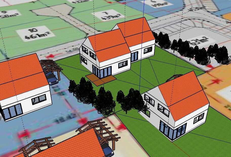

The surroundings could look like this, but nothing has been built yet. No houses, no trees.

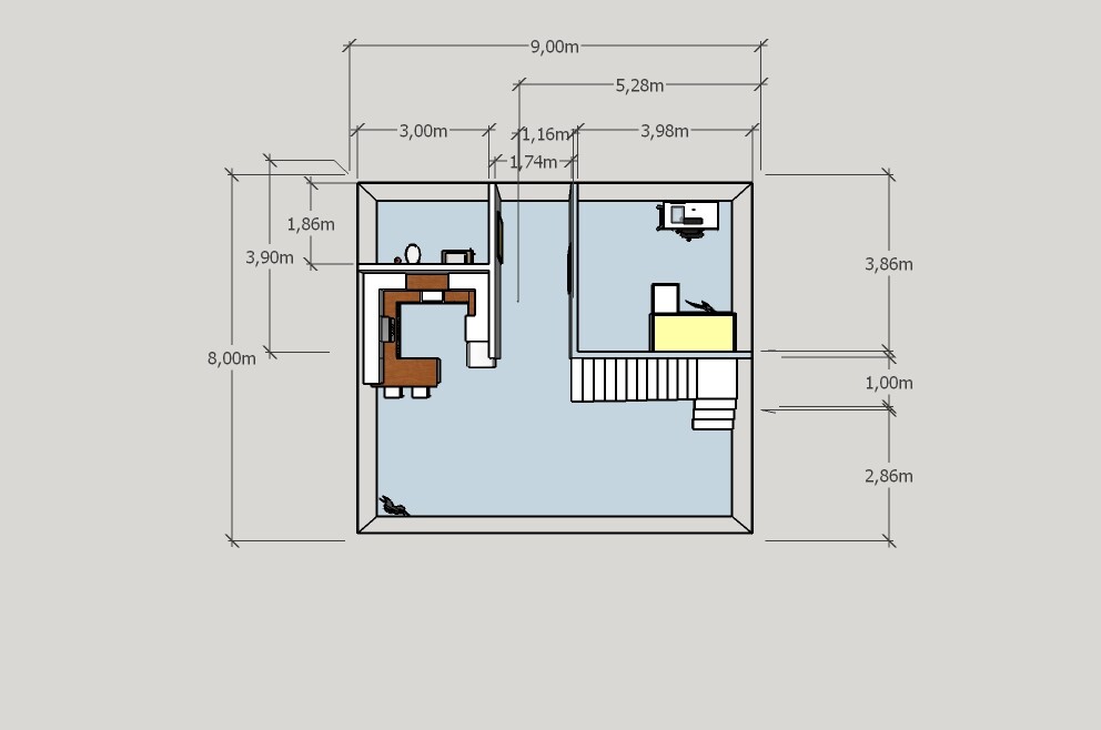

Ground floor plan, house size 8x9m (26x30 feet), oriented north.

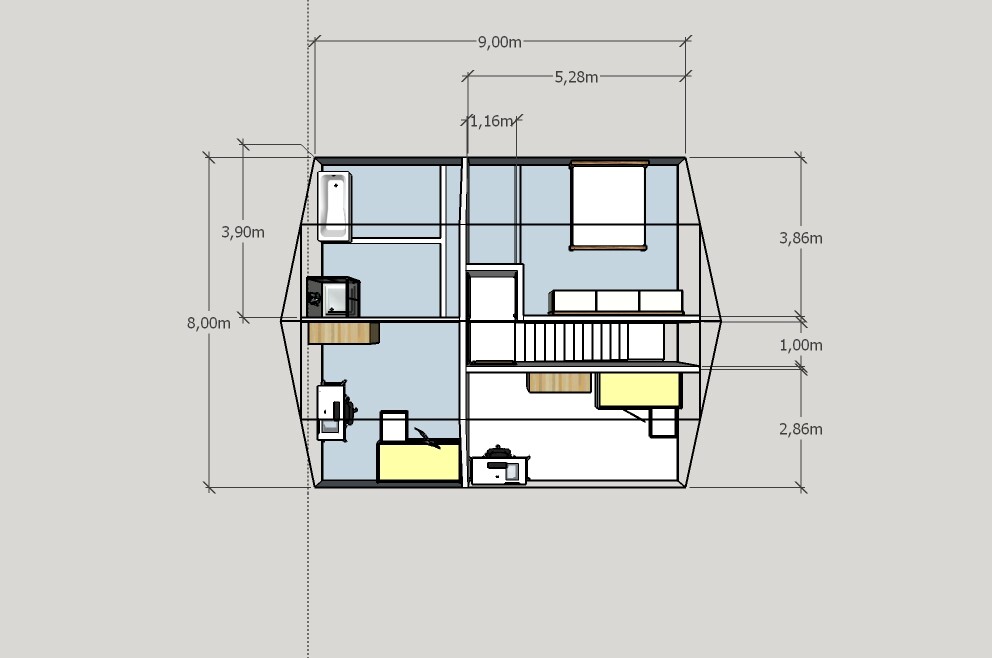

Upper floor plan, knee wall currently 1m (3 feet), but will probably be smaller.

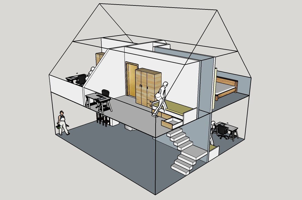

Isometric view from southeast.

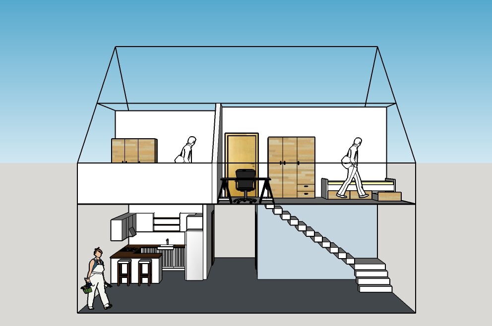

South elevation.

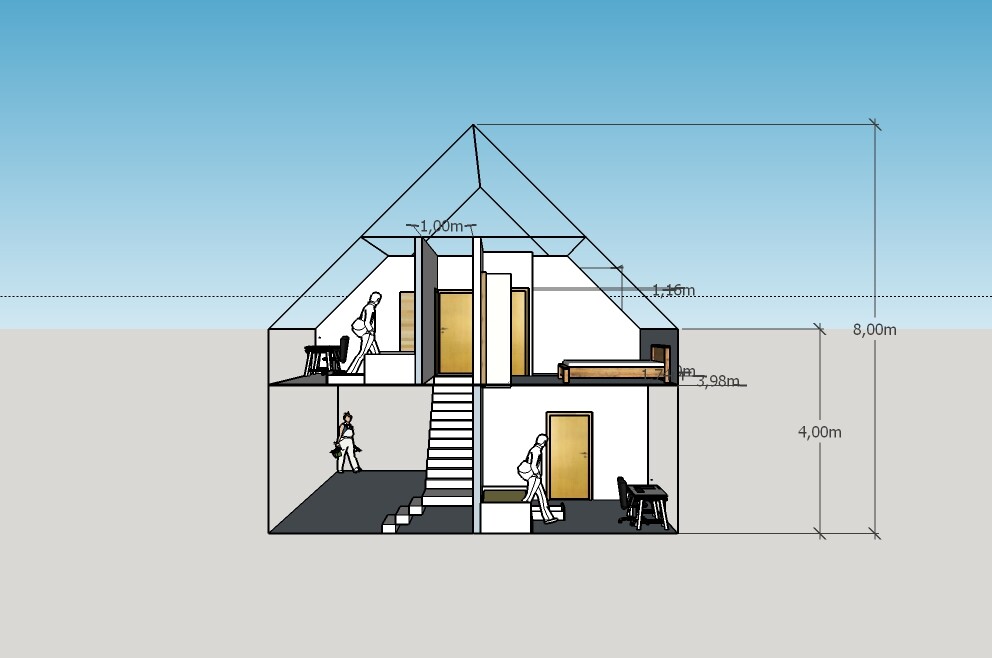

East elevation (obscured by the second semi-detached unit).
