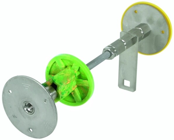

Trying to install such a component in the foundation slab is a doomed idea.Yes, this type of penetration is only intended for walls and obviously doesn’t work in foundation slabs.I was thinking more of something like this.
It is also designed to connect to reinforcement and grounding, as shown in the pictures, so I would actually say this is for a foundation slab.

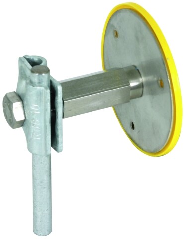

Why make it complicated when it can be simple? A stainless steel wire with clamp, properly installed, provides a better seal in my opinion and is also rated for a lightning current of 200 kA.
This grounding anchor point is designed for above-ground use and certified according to DIN EN 62561-1 Class N, with a lightning current rating of 50 kA.
The extension rod is completely unnecessary and a "hazard," as someone might step on it while pouring concrete.
