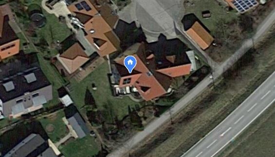

You can see it here.
icandoit schrieb:
You can see it here.That's quite interesting. I was actually thinking of plans and had a "standard" house in mind. Now, with intersecting ridges at an angle, I'm even more curious to see more of that :-)https://www.instagram.com/11antgmxde/
