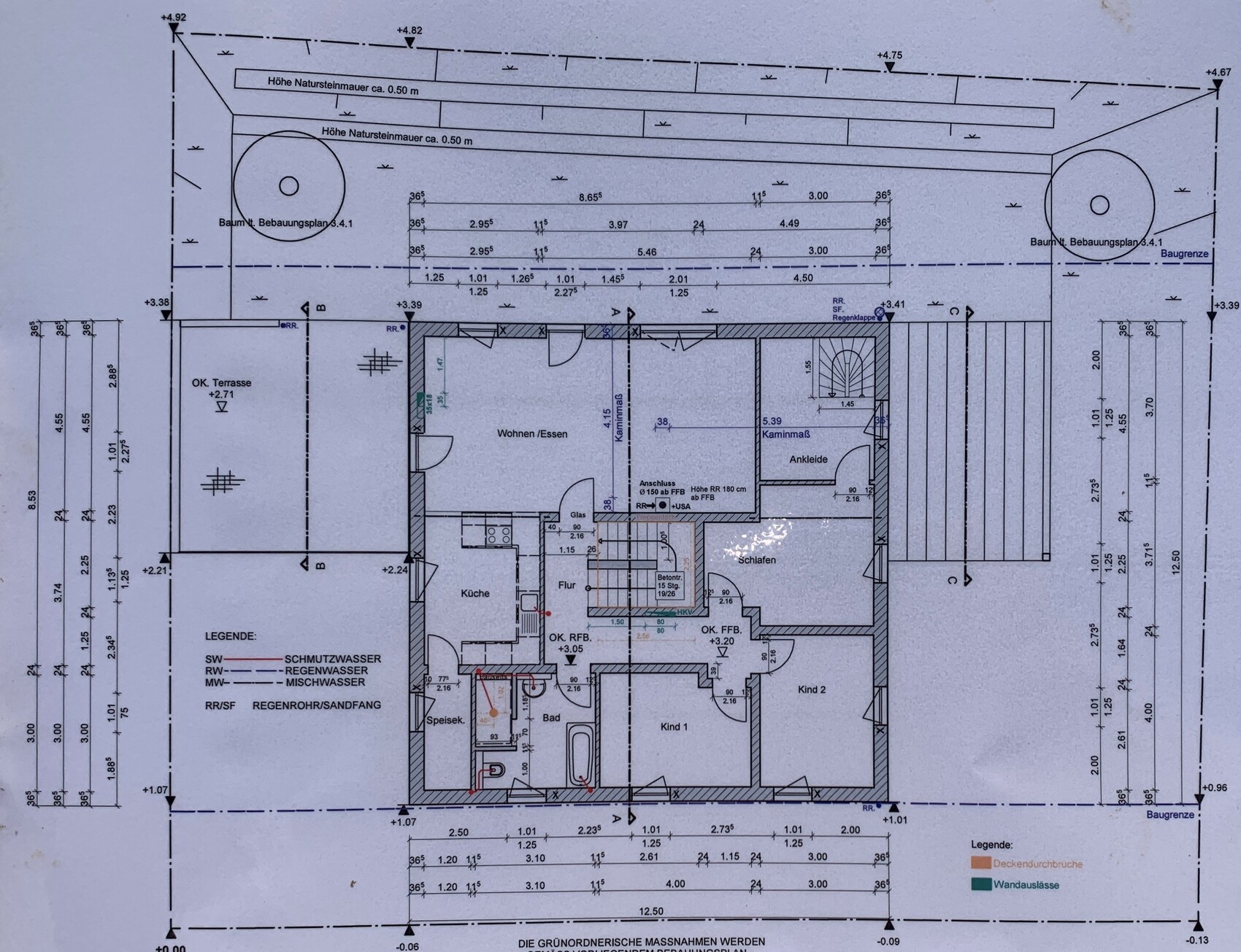

I have an example image from our friends. Is this plan from design phases 1-4 or phase 5? (Unfortunately, they don’t know either.)
Piotr198113 Apr 2020 13:52Familie HV schrieb:
We have an energy consultant (KFW supervision) who determines the materials. Isn’t that enough?
I have an example picture from our friends. Is this plan from service phases 1-4 or service phase 5? (they don’t know themselves, unfortunately)An energy consultant will NEVER determine the materials. Primarily, the structural engineer specifies what needs to be done (depending on many factors to consider). The energy consultant may suggest increasing the insulation thickness. Often, collaboration between the energy consultant and the structural engineer is recommended.
They don’t know?
That’s unfortunate! They should!
I can’t answer that.
Why don’t you ask your architect?
