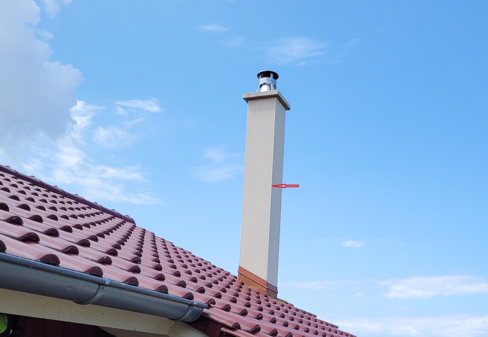

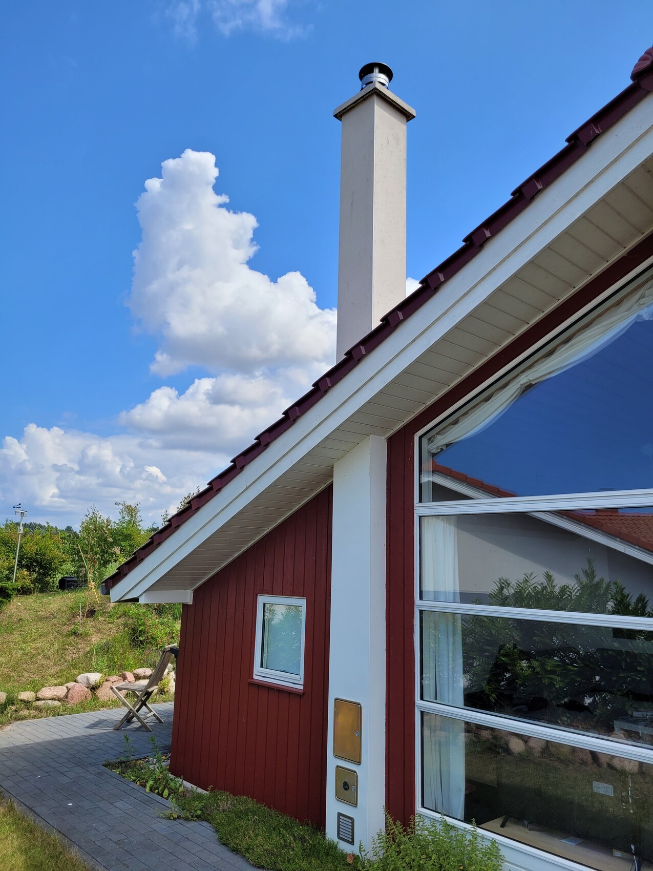

Ulfert202531 Aug 2025 13:35Hello,
in 2019, we built a holiday home where a chimney was installed in front of the wooden house. The chimney was nicely painted white by the construction company, but only below the eaves. Above the eaves, the plaster was so light that we didn’t notice it wasn’t painted there. Now it has been exposed to the Baltic Sea air for more than 5 years and is turning gray, and I can also see some small cracks.
My question: after this time, how should it be sealed? Would a simple pretreatment with primer followed by facade paint be sufficient?
Thanks in advance for your advice!

Ulfert202531 Aug 2025 19:15Hello and thank you for your reply.
How does the paint protect the plaster without sealing the pores?
Photos are attached; the cracks can be seen in one of the pictures. I would describe them as hairline cracks.
Unfortunately, the material is not clear from the building description, it only says “plastered.”
Regards, Ulfert

Unfortunately, I can’t see the small crack at all on my phone.
If it is a mineral render, I would simply clean it and apply a mineral-based paint (silicate). Then you can get a better idea of the crack’s exact condition. It could also be a construction defect appearing now – or possibly the result of frequent use of the fireplace, causing minor cracking due to heat.
