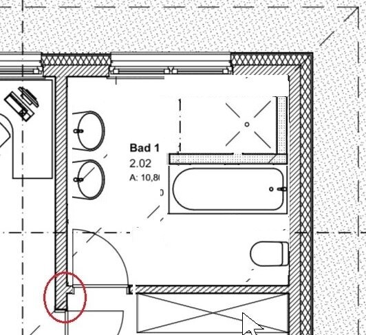

j.bautsch16 Aug 2017 11:26Well, as close as possible, as far away as necessary :P He often goes to the bathroom at night, and I don’t really see the point in having to walk past the bathtub and shower. I also don’t understand the idea of hiding the toilet, as some people want to.
j.bautsch schrieb:
Well, as close as possible, as far away as necessary :P he often goes to the toilet at night, and I don’t find it practical to have to walk around the bathtub and shower. I also don’t see the point in hiding the toilet, like some want toWithout flipping back now: I can’t recall having to walk around anything.
Across the bathroom, yes! Sometimes it’s shorter than walking around an open door.
I agree with you about the unnecessary hiding. I don’t understand it either. That’s why I would always prefer the L shape (compromise) in front of the T. [emoji2]
J
j.bautsch17 Aug 2017 07:42You somehow have to walk behind the bathtub here, which would bother me, even if a one-meter-wide (3 feet) space was planned.
I would probably do it more like this, but a solid wall blocks light, so definitely with at least partial glazing:
Shower by the window? Do you really want to have to wipe the windows every time after showering?
In the end, we decided against having a continuous wall and door between the bathroom and the dressing room (for reasons different from this), so maybe that could be an option here as well? I don’t quite remember now—do you have a mechanical ventilation system planned? If so, humidity wouldn’t be a problem.
And if you remove the door to the bathroom, you gain more options within the bathroom.
Personally, I don’t mind having a bathtub in front of the shower; it can actually work quite well:
The shower is located in the back right corner here.
Could that be an option for you?
