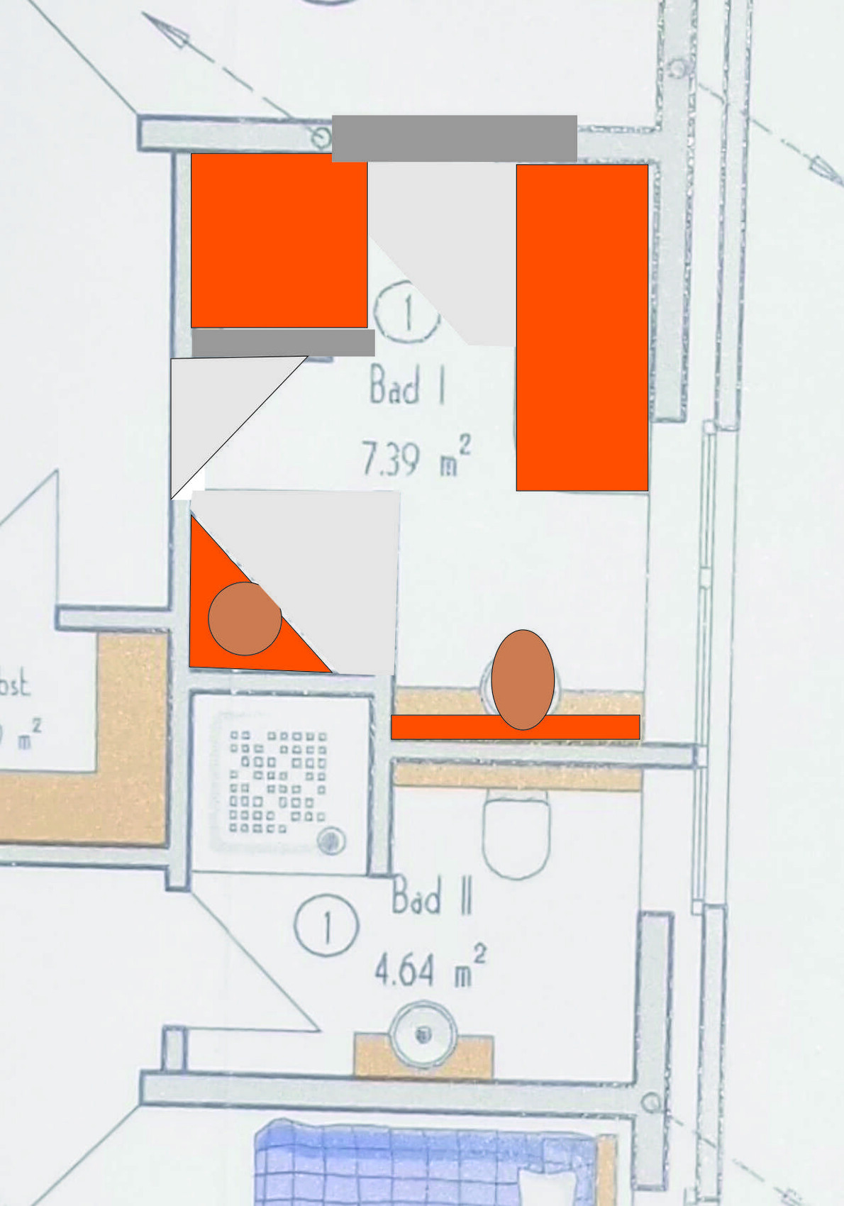

Bussibaer3 Feb 2016 20:31Hello,
I have a suggestion to share.
This way, the toilets (children’s and parents’), the washbasin, and the shower in the children’s room would share one drain, while the shower and bathroom in the parents’ bedroom would use the second drain.
I would place the washbasin at an angle, as in my opinion, this makes the room feel more open and inviting.
The partition wall of the shower could also be built using glass blocks, which would let in more light, and they are also available in colors if you want to add some accents.
Maybe you’ll like it, or it will inspire new ideas.
Have a nice evening.

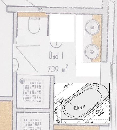

…that’s what I meant. Between the shower and the bathtub, a stylish, custom glass panel can be installed on the edge of the tub. Bathtubs come in various sizes, or you can choose the standard version under the window. Next to the toilet, add a towel holder. For a tiled shower (without a shower tray), it can even be adjusted precisely to the centimeter (about 100cm (40 inches) wide shower), fitting perfectly.
Good luck
Jens
Good luck
Jens

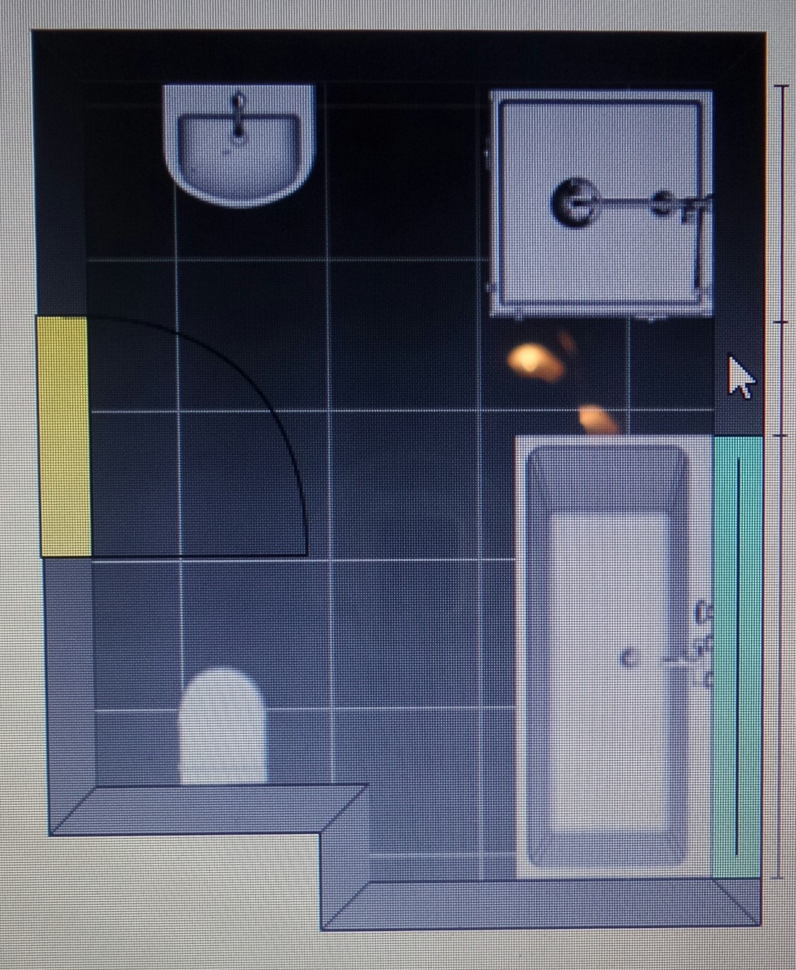

Thanks for the great ideas!
We have now found an online bathroom planner and moved everything around and considered different options.
I’ve attached the result.
There is about 45 cm (18 inches) of space between the shower and the bathtub.
A shelf could be placed there.
Or we might choose a larger bathtub and also enlarge the shower, so that there is no gap between them.
If anyone has comments on the idea, feel free to share them ; )
