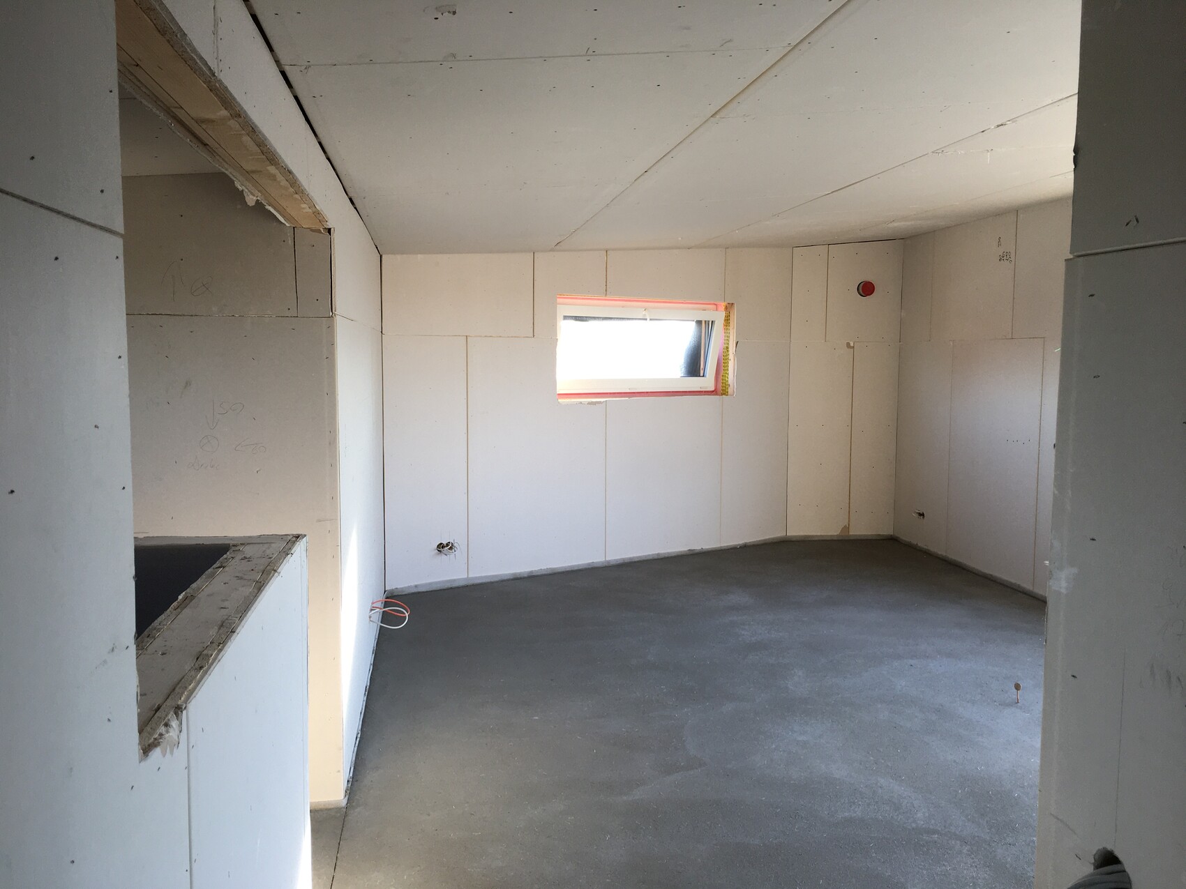

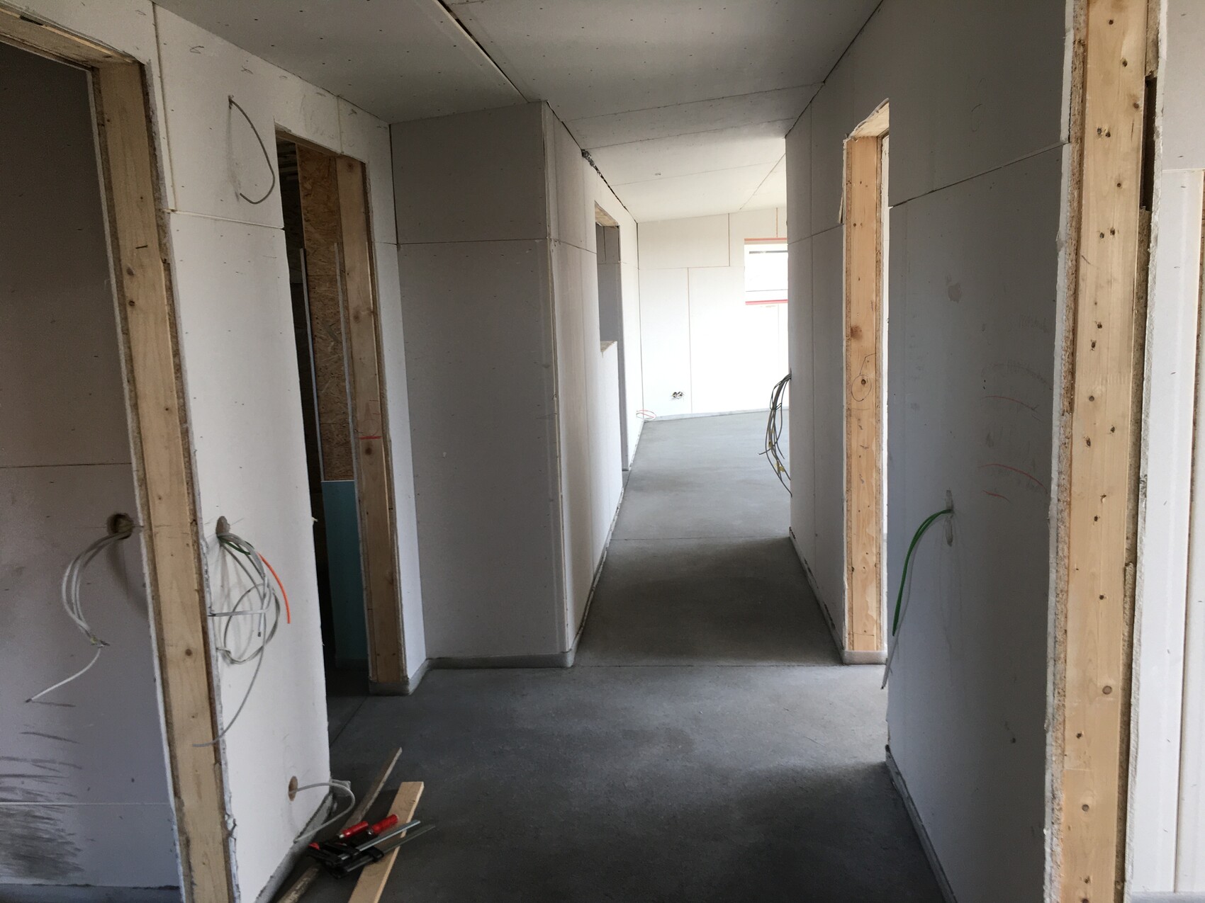

Here are some impressions of the upper floor apartment, which is shaped by the south-sloping single-pitch roof.
The house was built as a single-story structure. The ceiling height in the kitchen corner, utility room, and bathroom is 2.17 m (7 ft 1 in) at the lowest point, and 2.77 m (9 ft 1 in) at the highest point in the living, bedroom, and children’s rooms.
Olli
