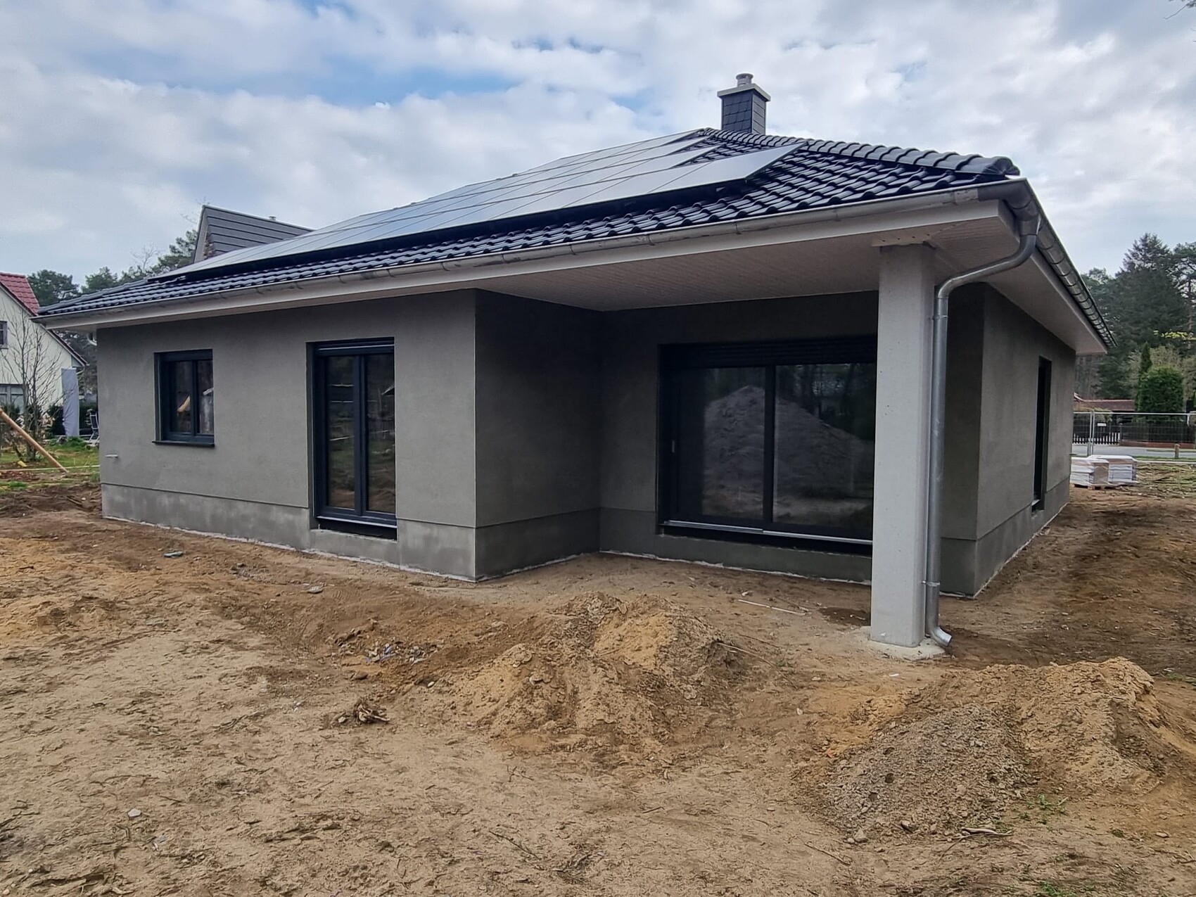

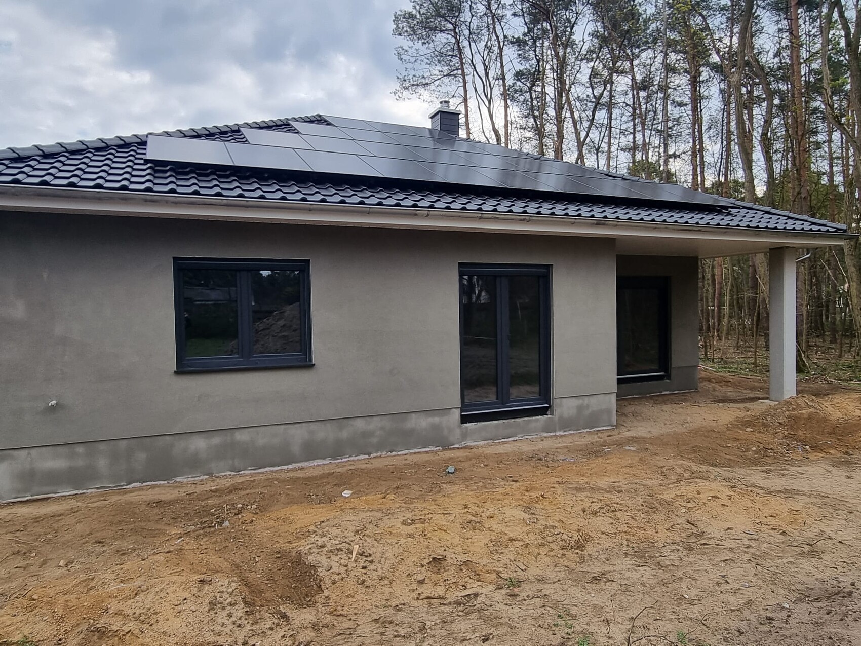

Neubau202229 Apr 2022 18:50Snowy36 schrieb:
I don’t have around 40,000 lying around, and I have an electric car with only 30 kWh (18.6 miles) battery capacity, and that will stay that way.
I ordered 9 kWp with 1,400 € per kWp and a storage system of 7.7 kWh (4.8 miles) for 530 € per kWh (all net prices).
The garage is going to be completely full anyway, and I don’t really want to have that thing installed in my bedroom, feeling-wise … maybe a woman’s thing (-:
We are helping out too, so there might still be some discount when it’s installed in the end.Honestly, I don’t think the modules look ugly. We have 13.26 kWp and I think that will increase over time since only two sides of the roof are fully equipped.
