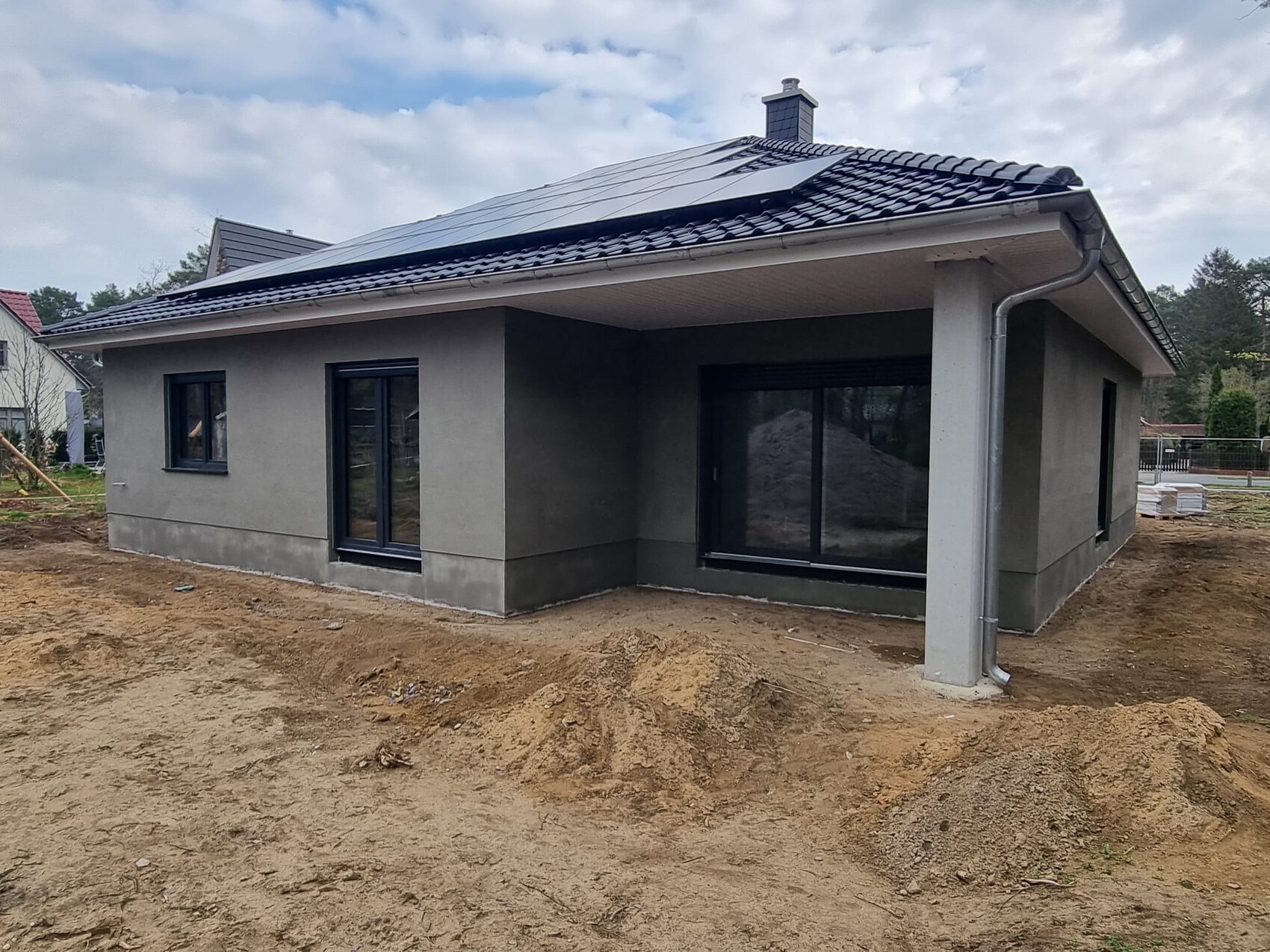

Best regards, EliasWe are paying €16,500 for the G8 system including power optimizers, fully black, plus installation, connection, and a free inspection after one year. The system size is 13.26 kWp. However, the offer and acceptance are from last year.
Deliverer24 Apr 2022 14:22If the power optimizers are not already installed, leave them out! Microinverters with shade management are more cost-effective and better.
Neubau202225 Apr 2022 05:37Deliverer schrieb:
If power optimizers are not already installed, leave them out! String inverters with shade management are cheaper and better.As far as I know, they are already installed 😎
