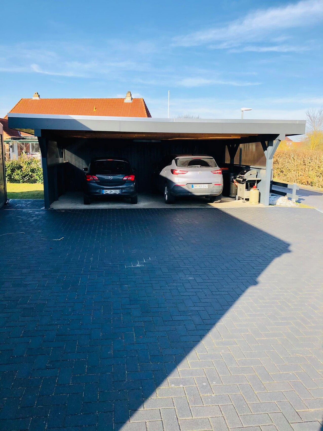

Nordlys schrieb:Well, in winter that does have advantages. No need to scrape, no snow on the car. And generally, I tell myself that the car benefits from being under a roof 😉
we bought it already painted, not bare metal

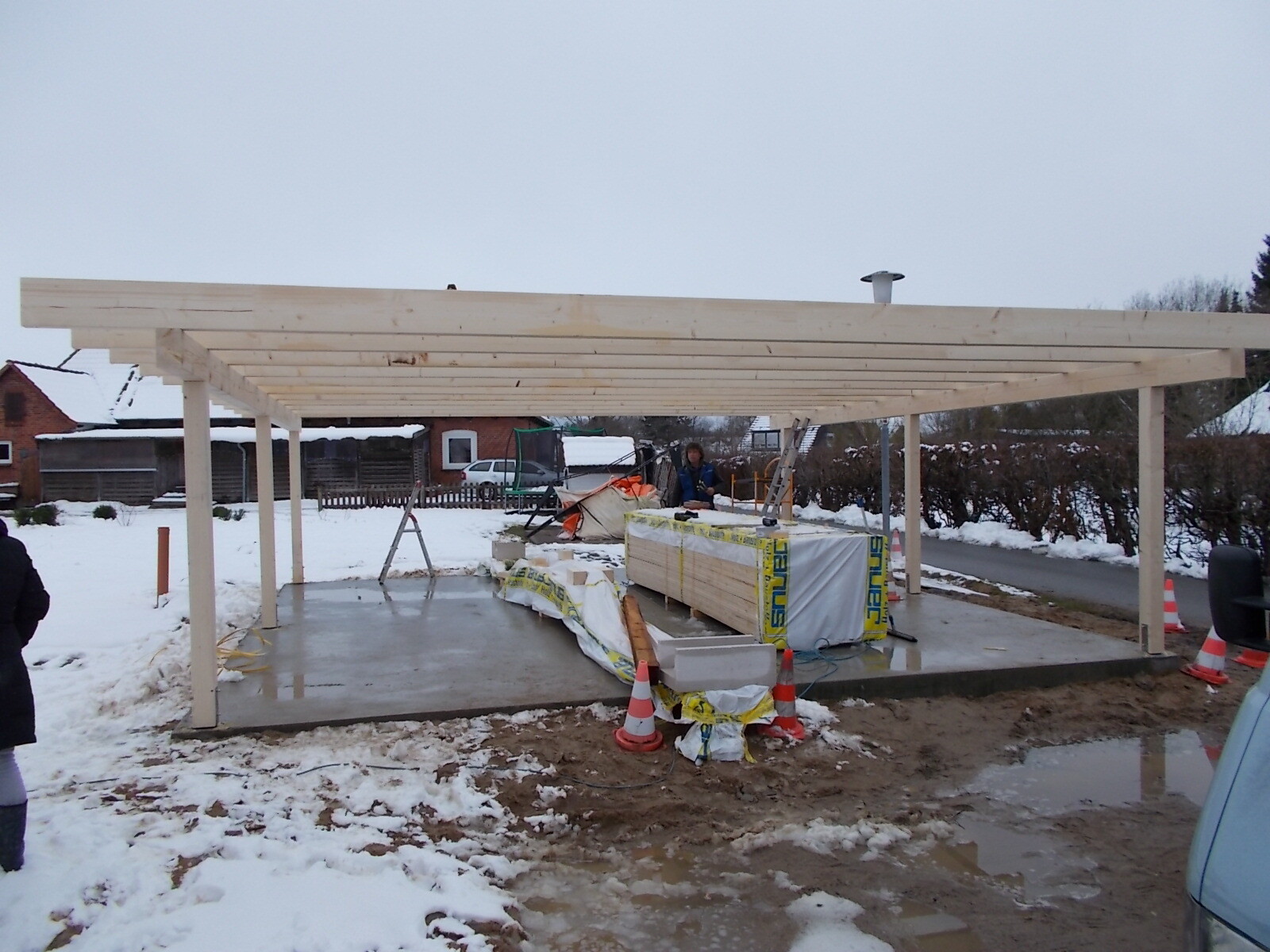

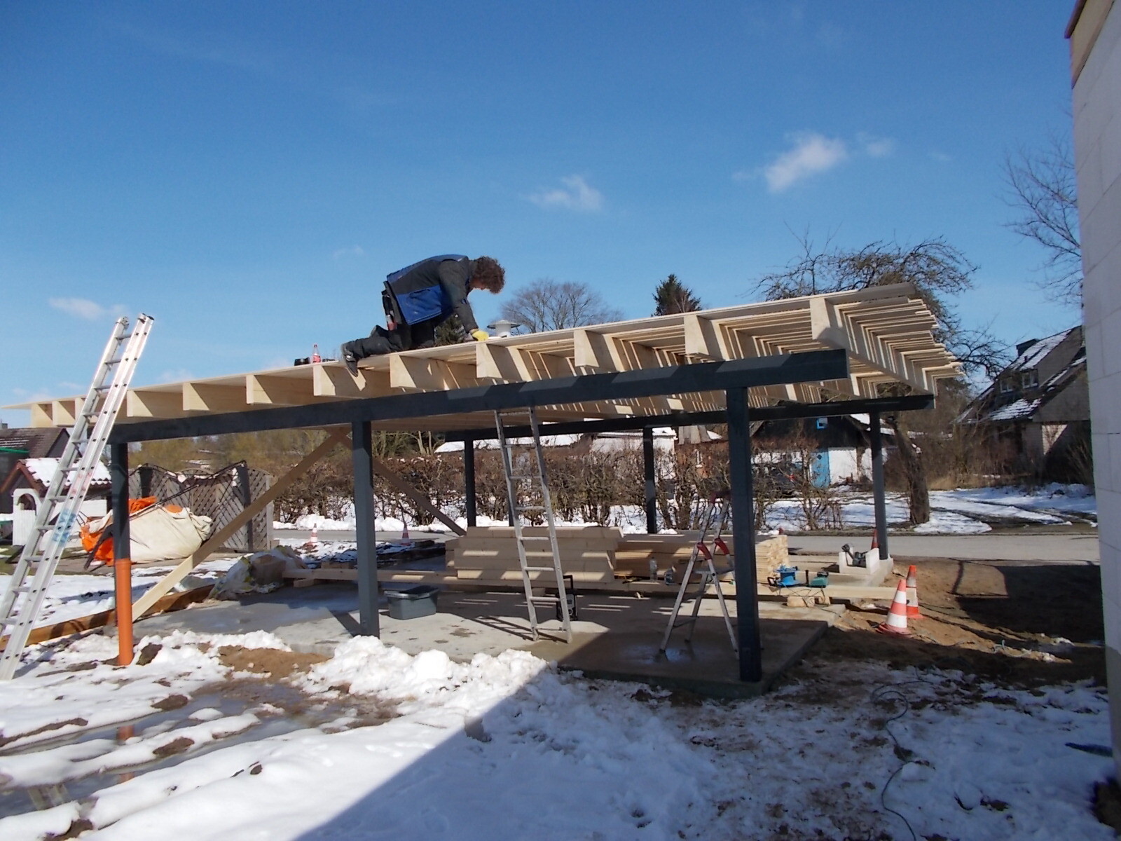

I am aware of the roof pitch, but the concrete surface is new information for me... and now, of course, I'm curious about what that involves...Exterior surfaces that are paved should always have a slope. Ideally, even 2% is better.Have you ever considered a concrete slab? We installed a 7 x 7 meter (23 x 23 feet) concrete slab with C30 concrete, and then placed the carport on it, measuring 8 x 8 meters (26 x 26 feet) to allow for roof overhang. The price, including materials, was about 8,000 euros. This estimate is for doing everything yourself, including the concrete slab, electrical work, and so on.

It still looks great at your place... but the paving in herringbone pattern... I always find that a bit "creepy," especially watching HGTV (please don’t take it personally) when it’s used very often on floors or on bathroom/kitchen walls... and then always praised as something amazing.
