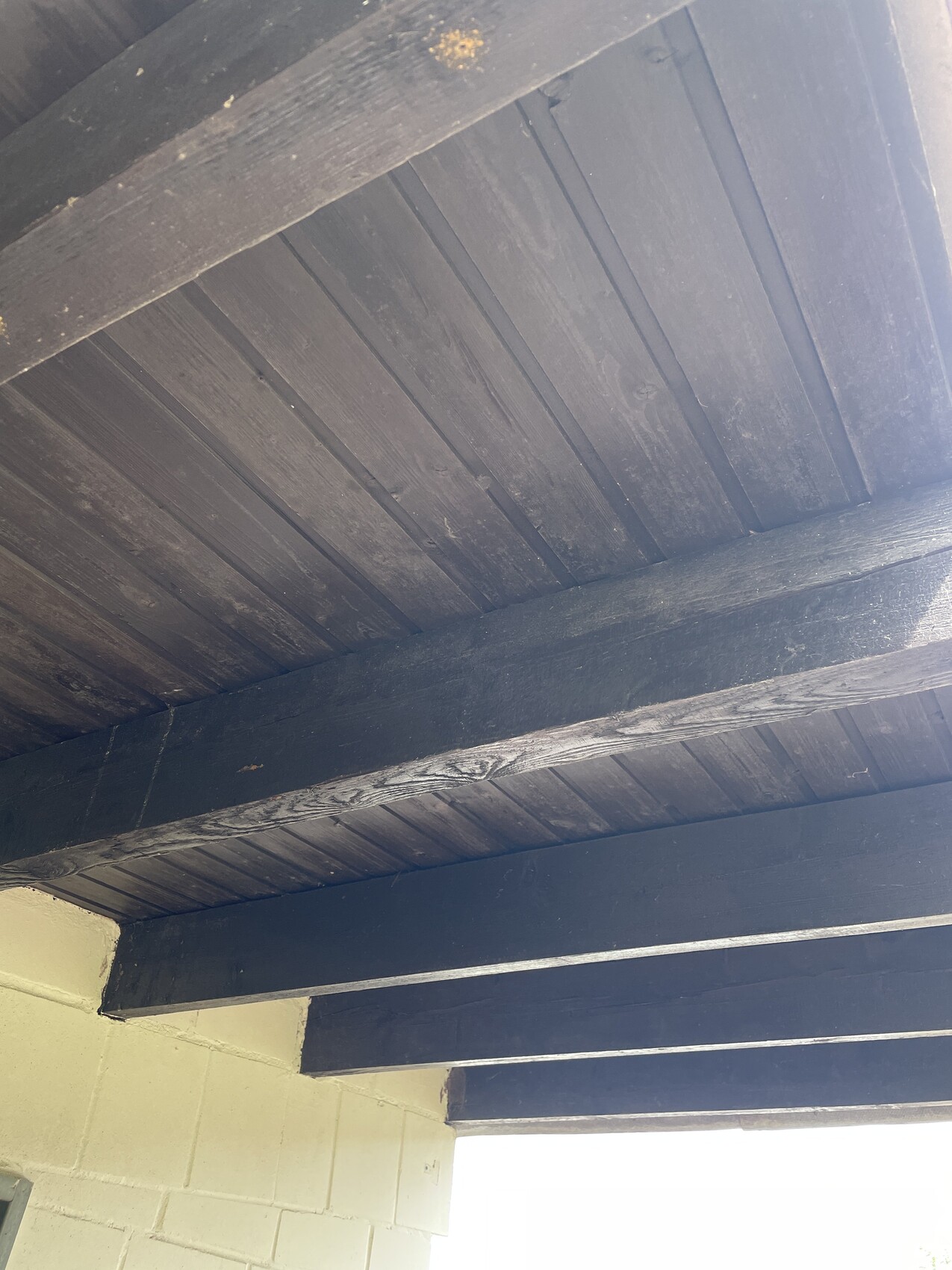

we want to refresh the color of my parents’ bungalow and garage. The paint is about 30 years old now.

The roof overhang is made of wood and should be painted a lighter color. Our question is whether all the wood needs to be sanded first or if it can be painted in its current condition. Of course, we would prefer if there is a way to paint the wood without sanding.

Buchsbaum06621 May 2024 18:23You can’t really tell from just a picture. To me, it looks like your wood has been treated with carbolineum. You could try smelling it to see if it has a tar-like odor. If it does, then that’s likely what it is.
I wouldn’t sand it off. It could contain harmful substances.
First, you should clarify what kind of wood treatment it is. After that, you can and must decide on the next steps. Sanding off carbolineum doesn’t make sense because it penetrates deeply into the wood. As you can clearly see in the picture, it holds up well.

rennschnecke21 May 2024 19:32Buchsbaum066 schrieb:
It looks to me like your wood was treated with Carbolineum. You could try smelling it to see if it smells like tar.Unfortunately, we can no longer ask the person what it was treated with. However, it does not smell like tar. In our opinion, it was a wood preservative stain.H
