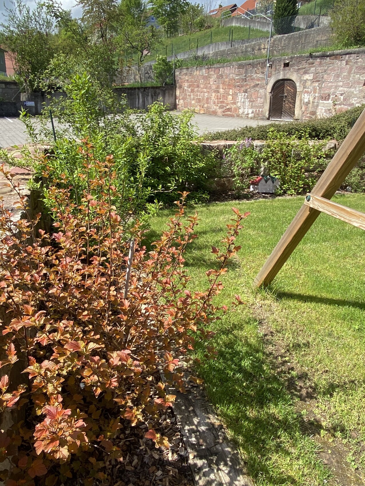

This is how it currently looks.
So it will take a few years.

Thank you for the suggestions and the lovely photos – it looks very nice, Haydee!
