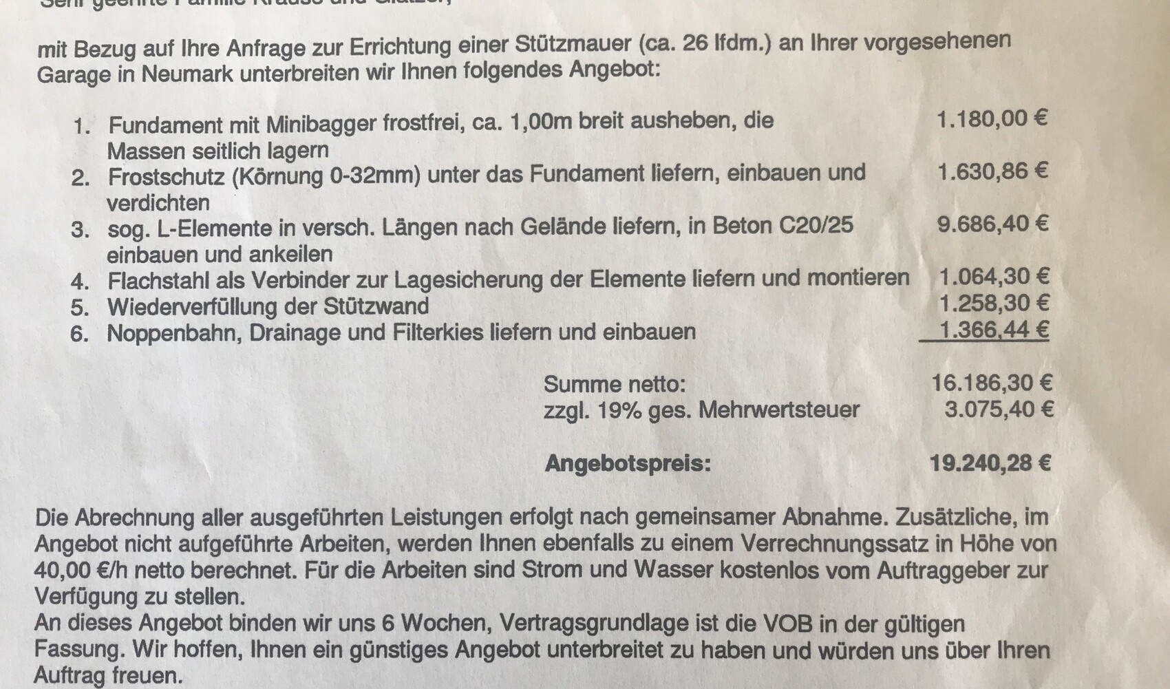

we received a quote from our garage construction company for installing L-shaped retaining walls for slope stabilization over 26 meters (85 feet). The installation will be done in 20cm (8 inches) increments, ranging from 2 meters (6.5 feet) down to 1 meter (3.3 feet), with approximately equal quantities at each height. Is a price of around 20,000 euros reasonable for this work?

Incredible amounts!
I built my retaining wall by myself.
Bought nice gray hollow blocks, reinforcement steel, mixed the concrete myself because it had to be used quickly despite delays.
Four days of work for 30 meters (98 feet) cost me and a friend about 2,500. Paid my friend a 500 € (about 550 USD) allowance for his effort. May I ask which hollow blocks you used?H
