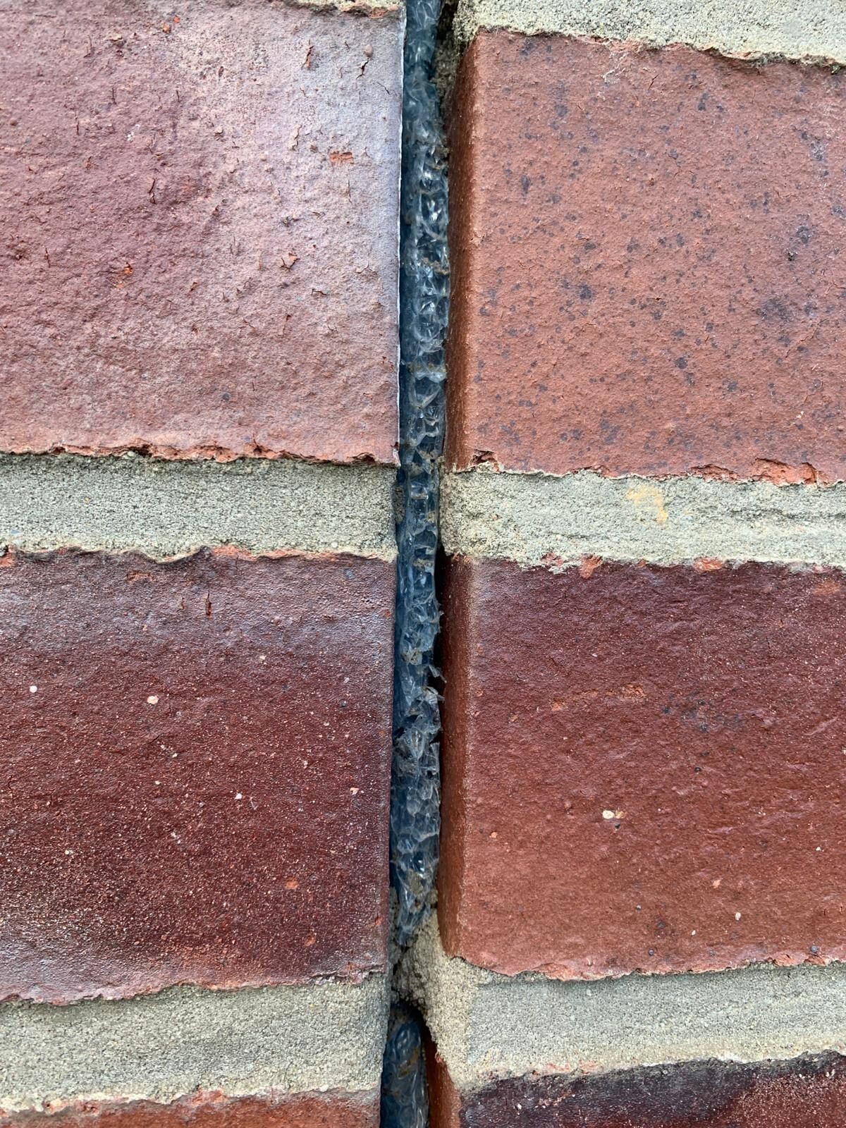

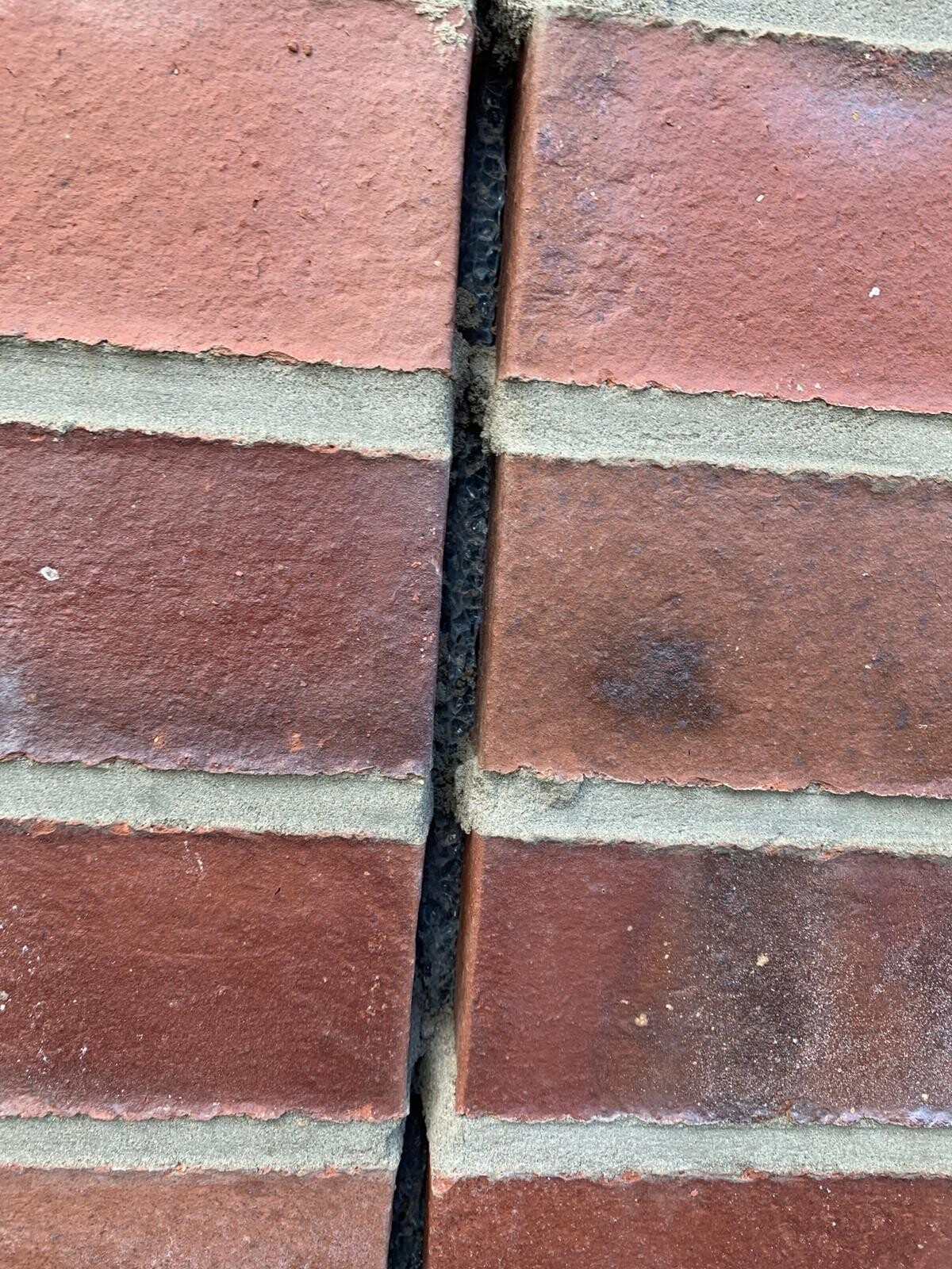

- Party wall is double-layered with a separating gap (on the outside you can see something in the gap)

knalltüte6 Jul 2020 09:18It could also be something as simple as mortar residue in the very narrow joint. This would acoustically connect both semi-detached houses. Presumably, a professional could determine this with some effort.
Alessandro6 Jul 2020 10:17I am a layperson regarding semi-detached houses, but this looks to me like a serious defect. ops:
Wintersonne6 Jul 2020 10:26Does it look like the edge strip used with screed?
Alessandro schrieb:
major defectA defect is a deviation from the required standard. As long as the required standard is unknown, interpreting a defect is pointless. Therefore, @Denex07 should first clarify what the landlord is initially obligated to provide regarding soundproofing. Relevant sources for this would be the rental agreement, property listing, building specifications, etc.Snowy36 schrieb:
Purely out of interest: what could be wrong with the foundation slab to cause this issue???The separation joint, which is done in the facing brickwork, must run continuously from the bottom (foundation slab, footings) up to the top (roof structure).Similar topics
