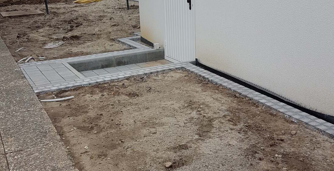

Our new garage has been standing in front of the house for about a year now. It has a door on the left side.
To avoid a steep driveway, the garage had to be set lower than the front door, so unfortunately we cannot enter the garage door at ground level. Almost at the last minute, and to our surprise, a step was created there.
We hadn’t thought much about it, and it doesn’t look wrong from a visual point of view.

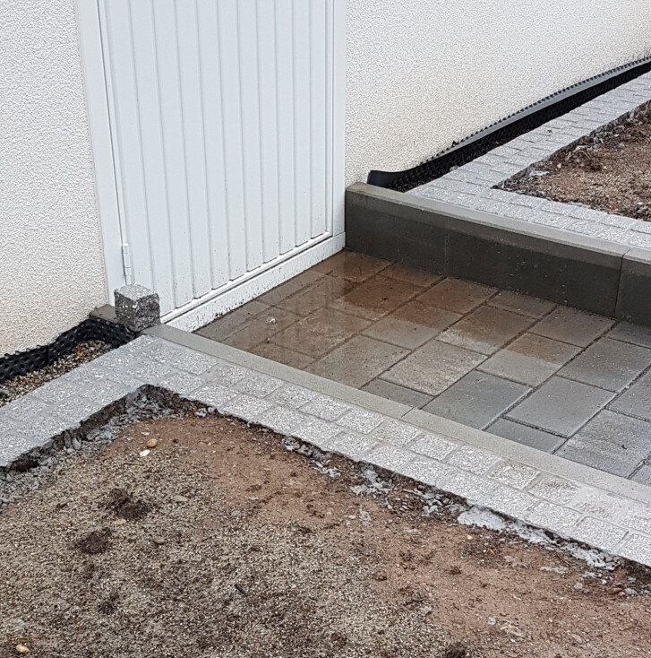

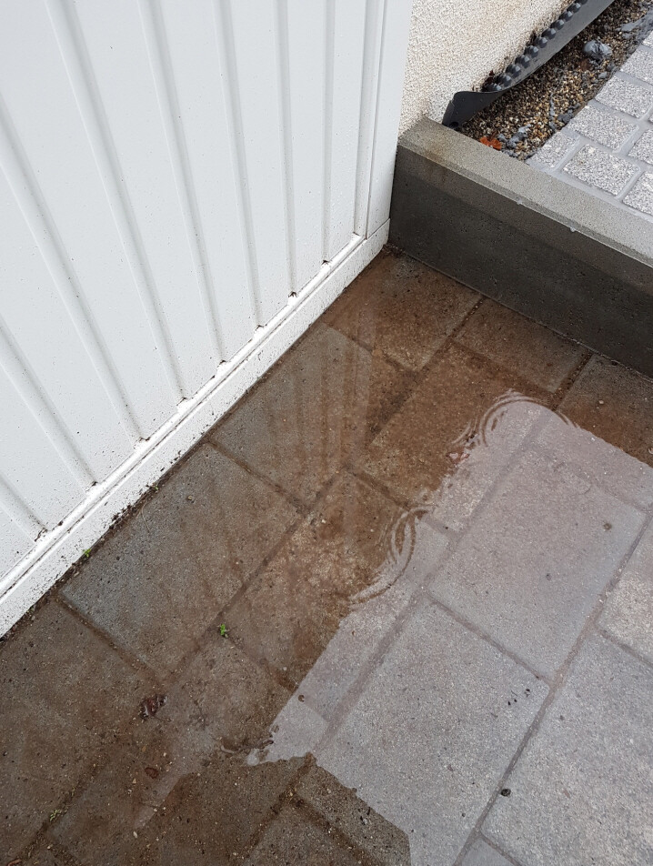

Last week, after two days of thunderstorms (not a huge amount of rain, just normal showers), I noticed that water was pooling in front of the garage door. It almost flowed into the garage. Only at that point did I realize there is no channel, drain, or anything similar there. I’m attaching pictures here.
A call to the architect revealed that the joints between the slabs are filled with "permeable sand." Due to the gardening work we are doing, these have now become blocked with dirt, and "they just need to be cleaned so the water can drain again." He does not see this as a defect or fault.
Could this really be the solution? Isn’t there supposed to be something at this garage door? The landscaping company currently working at our place said this is a clear defect and that we should file a complaint.
What do you think?
The door threshold is about 7 cm (3 inches) above the stone surface at its highest point.
Thanks and best regards

The "small" minimal solution would be a channel in front of the door that simply drains into a gravel bed below or beside it... The channel at least prevents splashes of dirt from reaching the door (which you can already see happening) by breaking the water flow.
However, a gravel bed is only a partial solution, because once it’s full, it’s full... A better approach would be to connect the drainage to the rainwater system (or another outlet).
