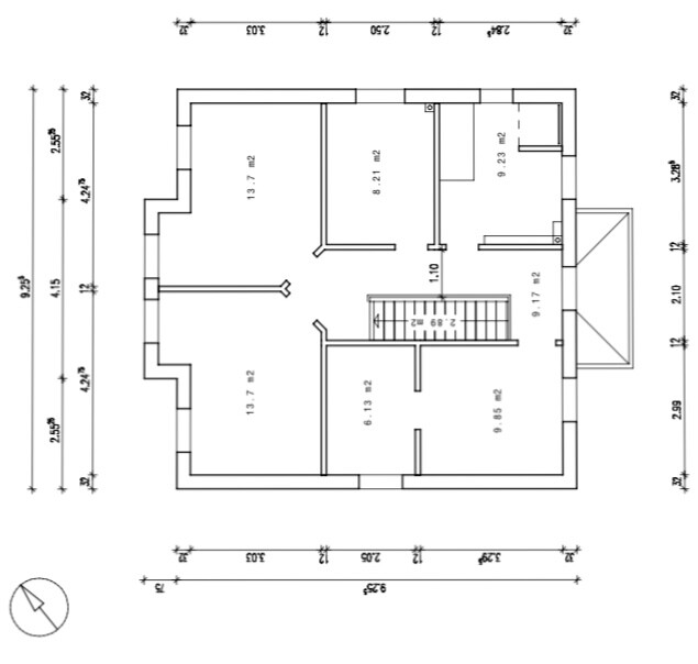

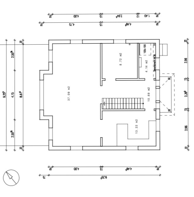

Is the hallway on the ground floor wide enough to accommodate, for example, a wardrobe, or should we plan an extra closet niche by recessing the utility room wall? The shower in the guest WC will definitely remain. Upstairs, the children's rooms are reduced to about 13sqm (140 sq ft) to enlarge the sleeping area and office, and the bedroom is extended to about 3.6m (11 ft 10 in). Is the bedroom then large enough for a 1.8m x 2m (5 ft 11 in x 6 ft 7 in) bed considering the clearance around it? There is at least 90cm (35 in) around the bed – is that too tight? Is the dressing area of about 1.95m x 3m (6 ft 5 in x 9 ft 10 in) sufficient in your opinion? Should the window in the dressing area remain or be removed to gain more wall space?
We plan to reduce the hallway width upstairs to a 1m (3 ft 3 in) passage, to provide more space for the office and bathroom. Is 1m passage width acceptable, or which width would you recommend? On one side of the hallway is the stair railing, so it probably shouldn’t feel too cramped, right?

Could you please upload a site plan?
Always furnish floor plans with the existing or desired furniture.
What is the bay window in the living area intended for?
The utility room is very small. I wouldn’t reduce it any further.
How big is the staircase? It seems quite short to me.
I find the hallway too narrow for a wardrobe.
I would choose a different staircase.
Is the kitchen meant to be laid out as shown?
What is the bathroom on the upper floor designed for?
The walk-in closet is a bit narrow.
Is this really a developer, meaning are you buying the land together with the planned house from them?
Where do the unusual wall thicknesses come from, that is, what materials are the walls supposed to be made of?
I suspect a lack of understanding of the actual dimensions – realistic furniture layouts can help reveal this. By the way, room names are always welcomed in discussions.

By the way, the plans are unfortunately not readable.
