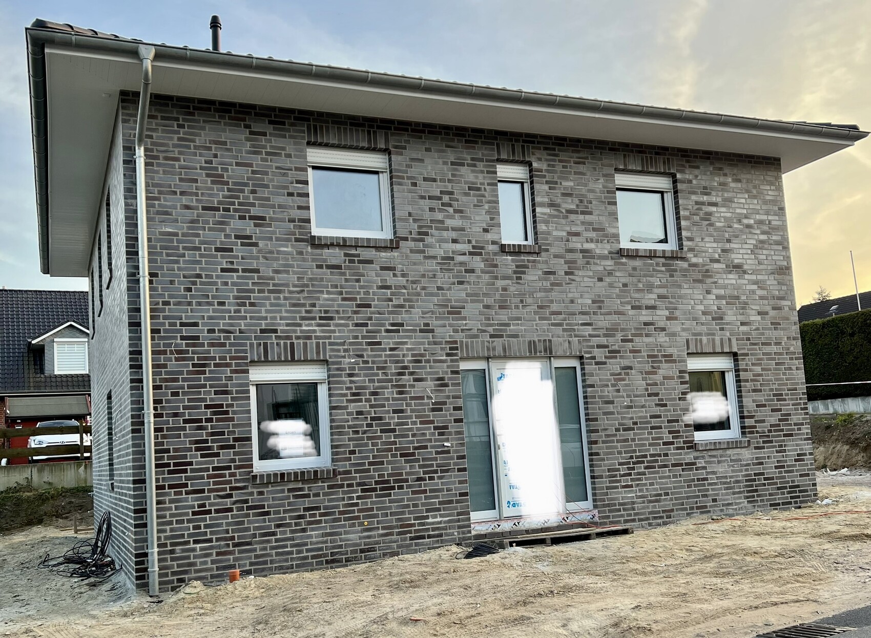

Our house construction (knock on wood) is still going great; the expert is satisfied, and so are we!
The screed was installed on Monday, as scheduled.
The kitchen isn’t arriving, or at least not fully, within the planned timeframe. The floor installer also has availability much later than requested, and the ordered furniture (which might work out) has a 15-week delivery time.
At the moment, everything around the construction is really more frustrating than the building itself…
Update from my side 🙂
The screed has dried, and the calcium carbide (CM) measurement was successful.
The walls in the guest bathroom and main bathroom were already tiled, and since yesterday the tiler has been back and finished the utility room, the HVAC room, and the guest bathroom. Currently, he is tiling the shower, and it looks like it will be completed as planned. He was scheduled through Monday.
On Tuesday, the staircase will arrive, and from Wednesday onward, the door frames and doors will be installed. The temporary front door will then be replaced with the actual entrance door.
Electricians and plumbers will also come back for the final installations.
We are really excited because on April 8th, we have the inspection of our very own dream home 🙂
Floor coverings will be installed on May 16th, followed immediately by the furniture. The kitchen is planned for June 2nd. If all goes well, we want to use Whit Monday and spend that weekend moving most of our belongings.
The handover of our current house is planned for June 30th.
