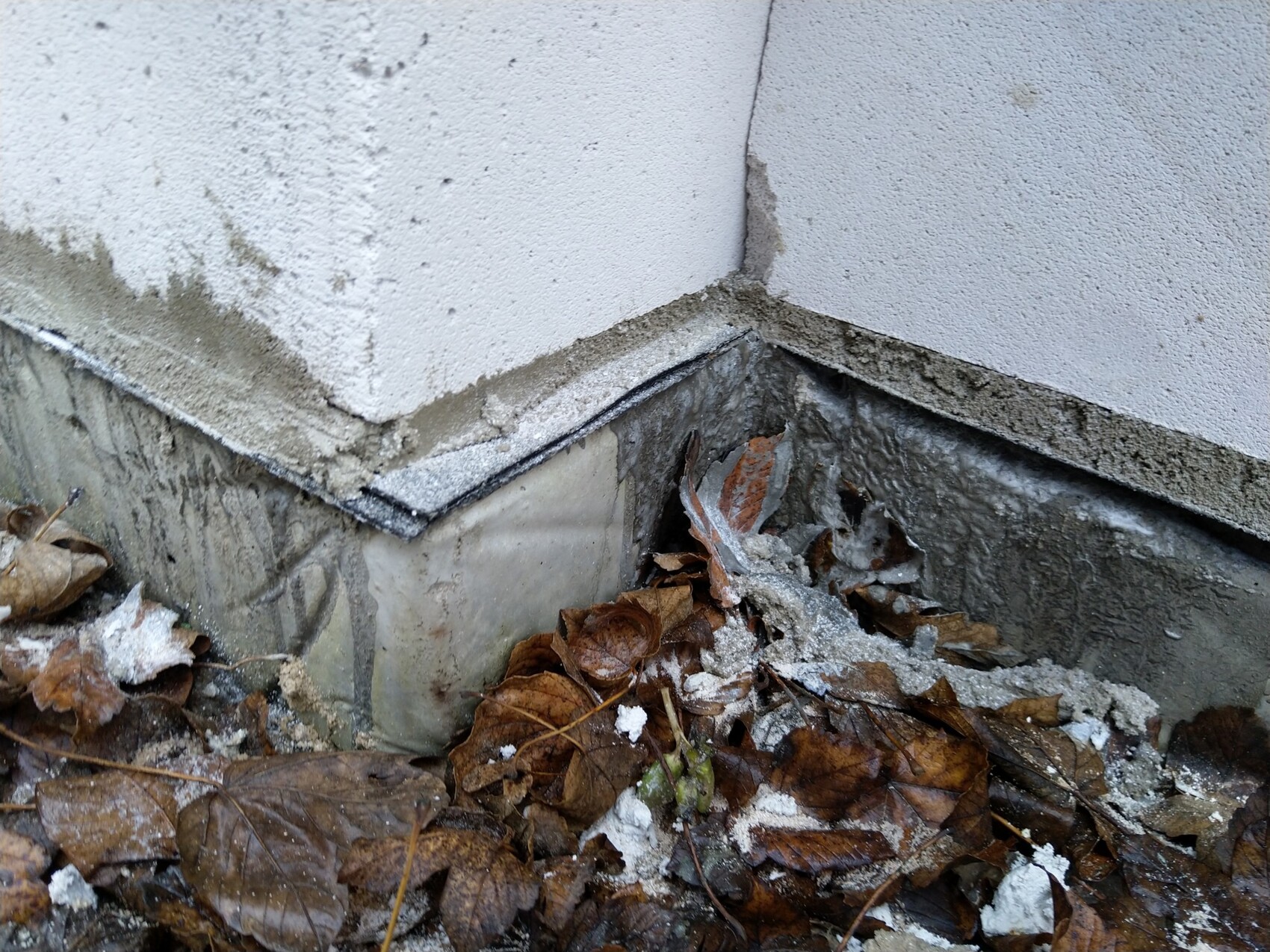

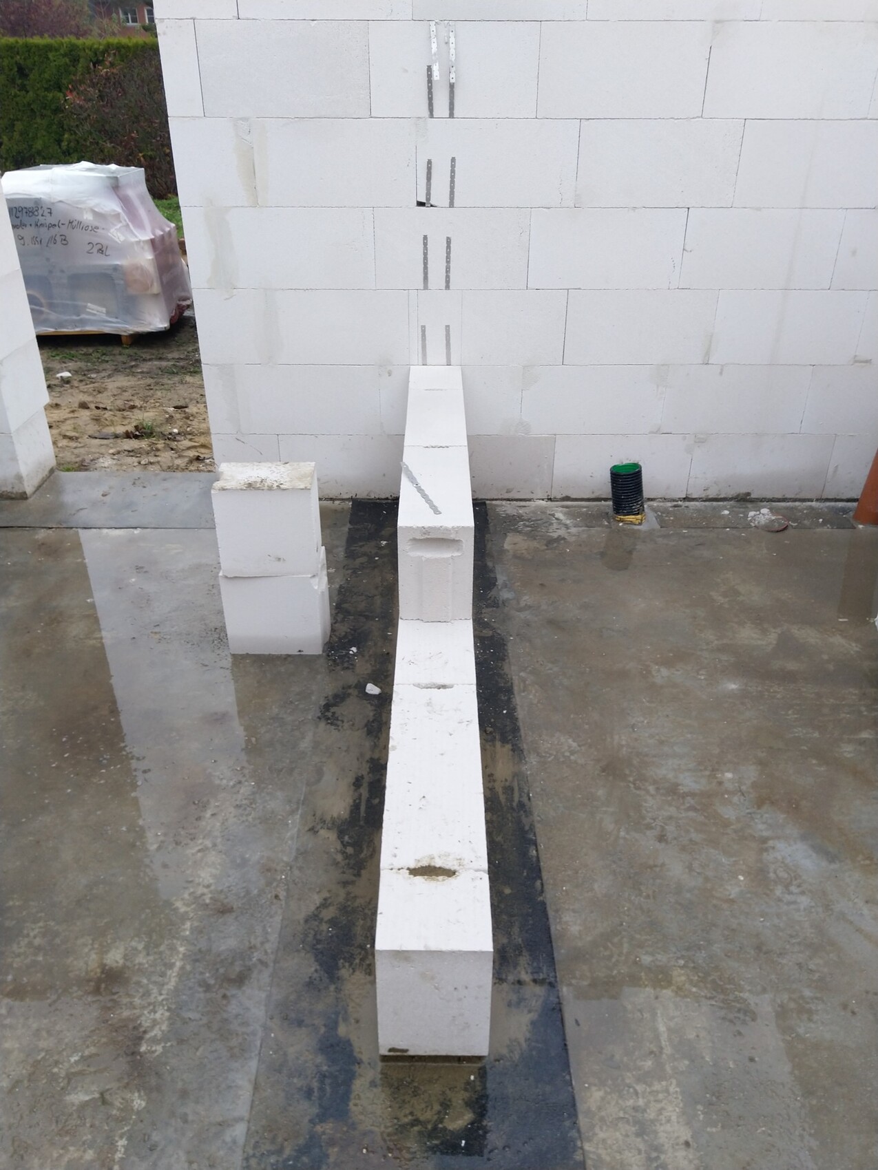

seat883 Feb 2020 13:43
Are the walls built on waterproofing membranes? Raising them up is not necessary; whether you want to insist on that is up to you, but I think your builder will be unlikely to agree with you on this...

It seems that the damp-proof membrane is also missing.

Yes, what did they put under the masonry?

Something can be seen beneath the masonry
Corner at the house foundation with crumbling plaster, exposed concrete edge, and autumn leaves.
Construction site: White blocks stacked in front of the wall, wet ground, pallets in the background.
