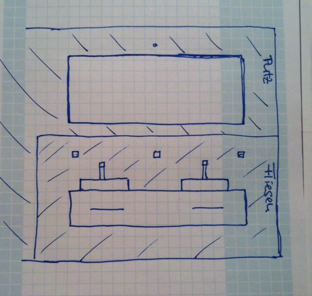

tutterchen9 Jan 2016 19:06Perhaps I may suggest a third option: We have two rectangular washbasins mounted on a custom-built vanity. The vanity is approximately 150 cm wide (59 inches). The tiled backsplash behind it is 180 cm wide (71 inches) and 115 cm high (45 inches), meaning it extends 15 cm (6 inches) wider on each side than the vanity. The mirror is set within stainless steel frames and is exactly as wide as the vanity, also aligned with the tiles. The remaining wall area is plastered. The mirror, plaster, and tiled backsplash behind our vanity together create a smooth, even surface.
In precise measurements, the height layout is as follows:
Up to 115 cm (45 inches): Tiles
115 - 120 cm (45 - 47 inches): Plaster
120 - 195 cm (47 - 77 inches): Mirror
195 cm (77 inches) to ceiling: Plaster
For lighting, we have recessed spotlights installed in the ceiling and a junction box centered above the mirror. The light fixture above the mirror matches its exact width.

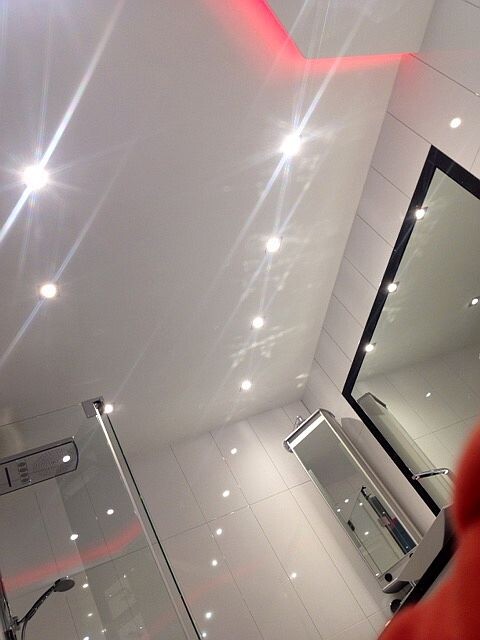

Lighting: We have four dimmable 5-watt warm white LED spotlights with phase-cut dimmers installed above the 170cm x 100cm (67 inches x 39 inches) mirror.
They are positioned 30cm (12 inches) away from the wall. The bathroom is 2.35m (7 feet 9 inches) wide. We have the same number of spotlights “in front” of these (two rows).
I’ll check later regarding a photo. I find flush-mounted fixtures the most attractive, as they create a calm look without protruding frames or similar. With this arrangement, you don’t need an additional light strip.
