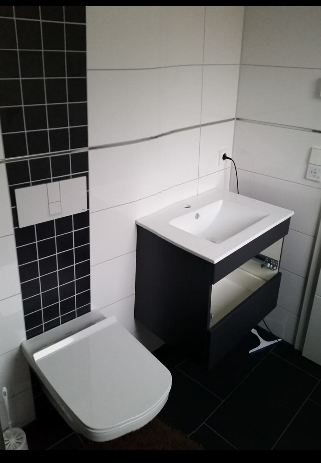

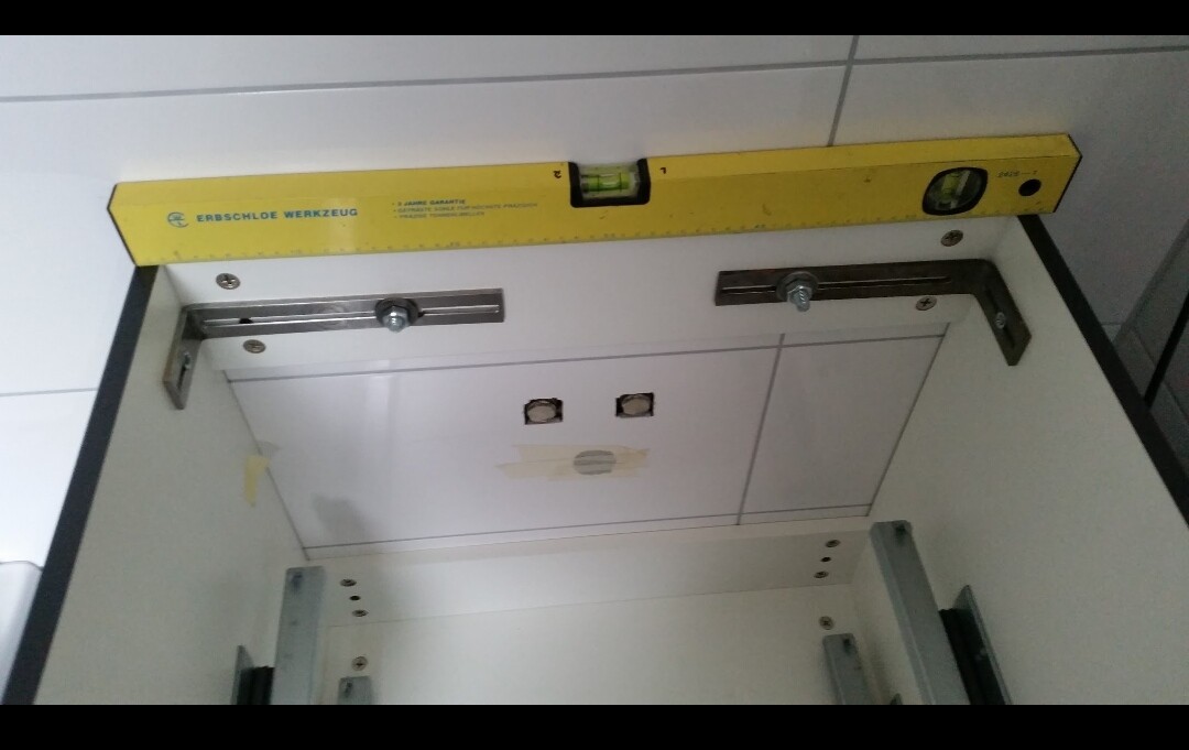

tomtom7922 Apr 2021 09:27
Be creative.
We discarded the sink; for that amount of money, I could have bought two.
The holes in the wall remain, so make sure you have a way to secure it properly.
This is how I solved it.
The base cabinet has a horizontal wooden crossbar at the back, which I drilled through and screwed together. The brackets are just an additional support.

Chris1990
22 Apr 2021 09:38
