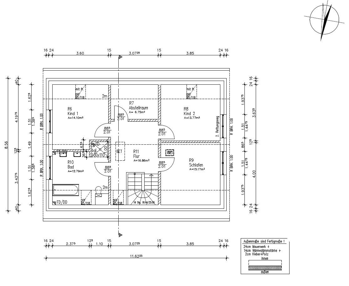

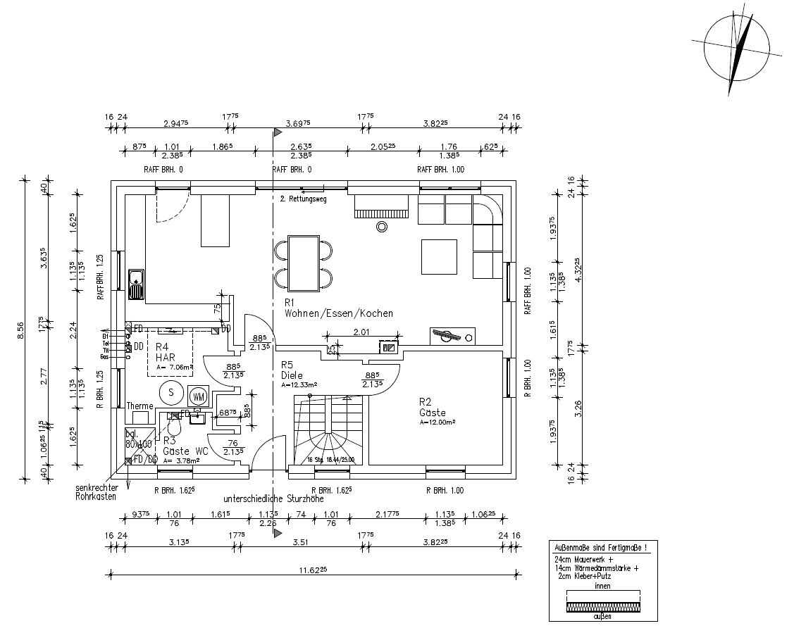

Here is the original floor plan:
Wasn’t this the final result after weeks of discussion:
Floor plan of a house: rooms such as bathroom, hallway, bedroom, child room 1, child room 2, storage room, staircase.
Floor plan of a residential house: living/dining/kitchen, foyer, guest room, stairs.
