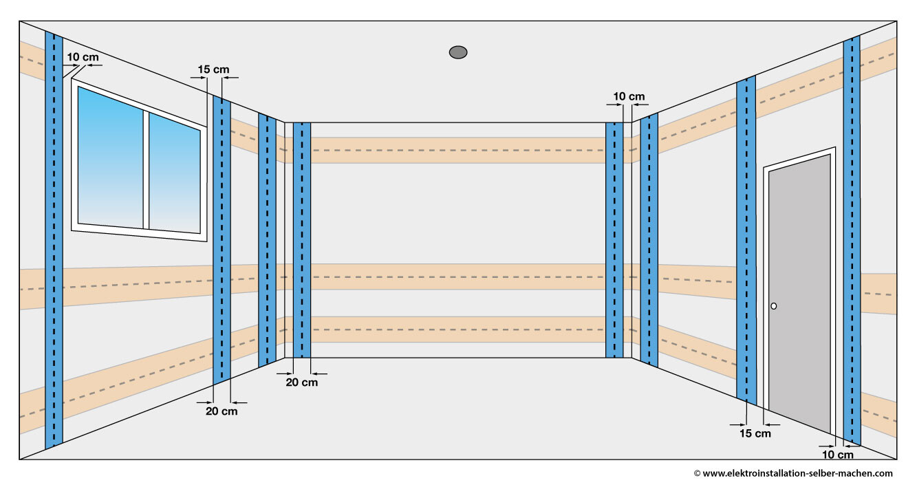

With 36cm (14 inches) blocks, almost anything is allowed when making channels for wiring, both vertically and horizontally. However, there are designated installation zones. I have some experience with electrical work, but mostly in the industrial field, so I’m not very familiar with typical residential installations. Therefore, don’t take my statement as absolute fact.
I would do it the same way as you plan to do it in your house. The proper way, however, is to stay within the installation zone. I’ve attached two photos for you. Fasten the cables either with nail clips or just some plaster. Something will be applied over it anyway later on. The main thing is that the cable doesn’t fall out. The channel depth is, as mentioned above, almost irrelevant. Even 3cm (1¼ inches) should be fine with 36cm (14 inches) blocks as far as I know. Since you only have one cable going left and right, I would use a 1cm (½ inch) channel.

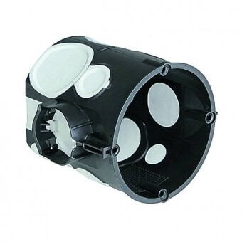

That depends on your judgment. I would probably go with a single junction box anyway. The light fixture will be installed there later on anyway. It is important to use airtight boxes and ensure the sealing remains intact. In the end, just feed the cable through. Just search “Kaiser outdoor junction box” online. I’m attaching a photo of one as well.
