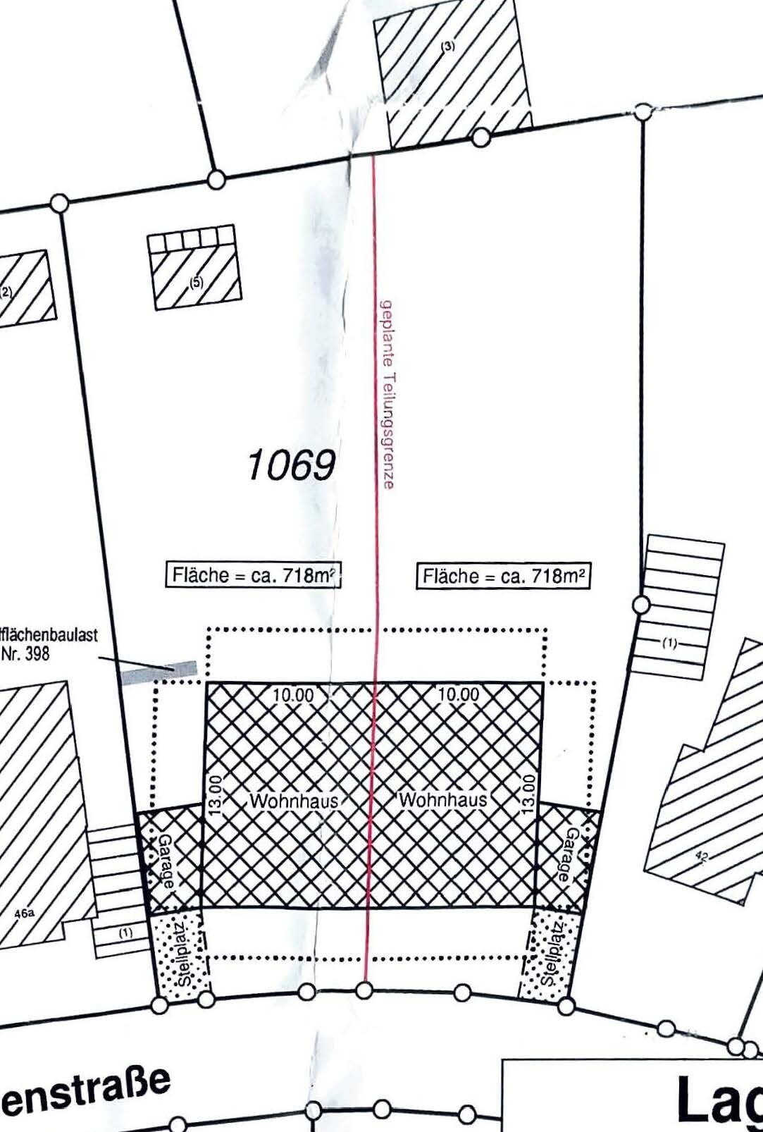

It would be best if you also showed a land registry extract of the plot so that the divisibility can be visualized. Do both halves have direct access to the street?
No problem! Both plots will have direct street access after subdivision. The area shown for construction here represents the maximum possible considering the building encumbrance. We won’t fully utilize that because our semi-detached units will each have only about 115m² (1235 sq ft) of living space. A bit of background info: it’s a sloped site, so the plot rises towards the back. We will therefore need to build with a basement, which will serve as the entrance level.
Location plan of a plot with residential building, garage, and boundary lines
