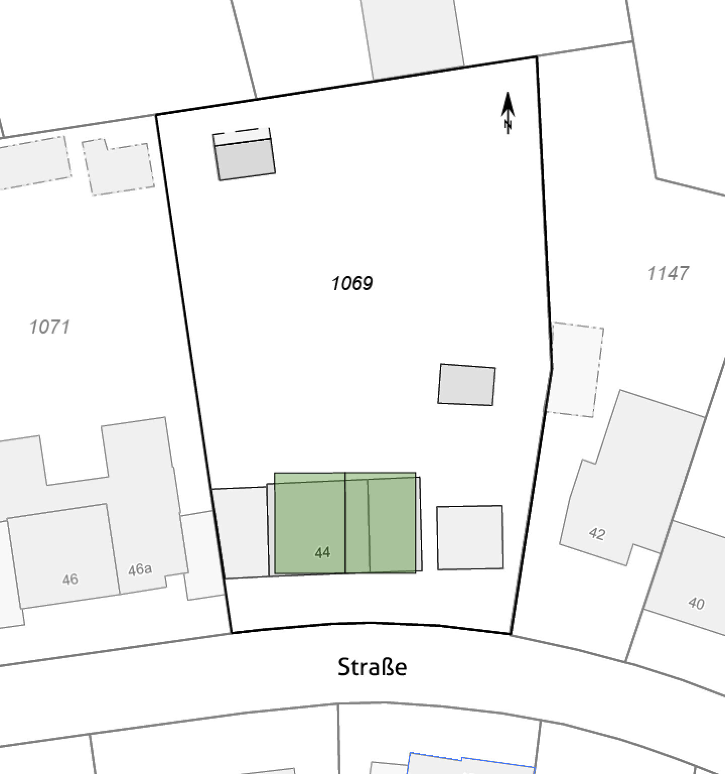

There is a developed (currently unoccupied) family property intended for a new build. The property will be transferred to my wife and her sister-in-law in the coming weeks. The existing building from the 1930s cannot be renovated for less than 75% of the cost of a new build. In addition, the size, layout, and location on the plot are not suitable for a possible conversion into a kind of semi-detached house. Currently, we are planning to demolish the house and build either a semi-detached house or two semi-detached halves on the plot(s). To do this, the plot will be divided into two equal parts. This leads to my first question...

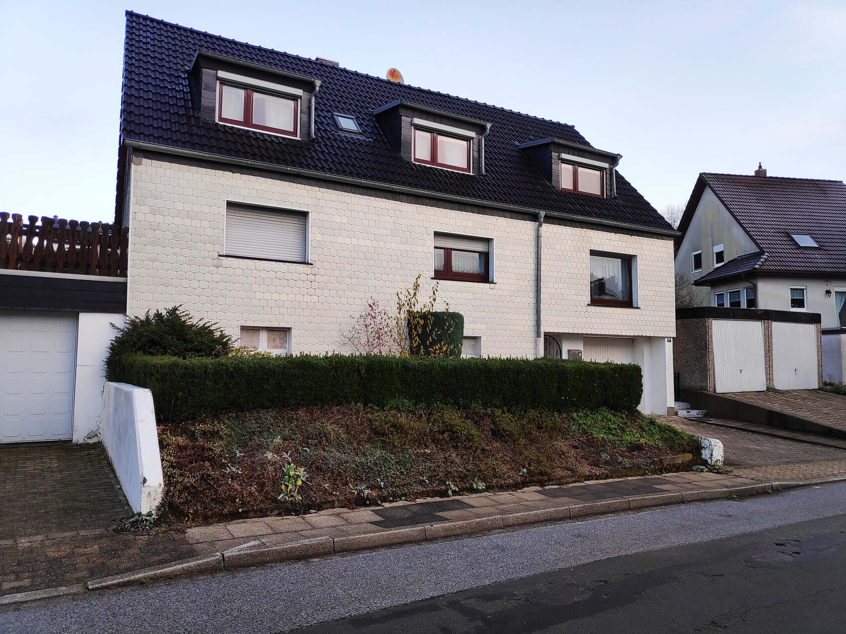

Compare the planned building with the existing one in terms of building volume.OK, let’s do that:Here, I’m assuming a footprint of 7 meters (23 ft) wide by 10 meters (33 ft) deep for one of the new semi-detached units, which could be increased if needed, since the lot size allows it. So regarding the house size, there won’t be a big difference in the streetscape.
To illustrate the situation, here is a photo of the existing house:
The current basement or lower ground floor has a very low ceiling height; at my height of 1.86m (6 ft 1 in), I almost hit my head on the ceiling. So that would be raised somewhat. What clear ceiling height would be appropriate there if the entrance area is also planned for that level—around 2.35m (7 ft 8 in)?
The existing attic is also rather low. Overall, the house would probably be about 1 meter (3 ft 3 in) taller than it is now. Since the plot lies in a slight dip (the street slopes gently upward on both sides), raising the building might align its height more closely with the neighboring houses but not necessarily exceed them.
From my subjective perspective, a reduced roof pitch would also fit in nicely.

To give some context with pictures, this is the existing house: Yes, pictures definitely help to get an idea.
I took a look around the area. The planning regulations are quite disorganized, which actually works in your favor. You can pretty much do whatever you want, as long as you don’t exceed the eave and ridge heights of the neighboring houses.

Your neighbor on the left appears taller in the pictures. Or is that just an illusion?
From where are you taking the measurements? The street seems to rise slightly to the left, doesn’t it?
I hadn't realized it was such a sloped terrain.
Escroda schrieb:
You can almost do whatever you want, as long as you don’t exceed the eave and ridge heights of the immediate neighbors.
kaho674 schrieb:
From where are you measuring? Yes, there is room for debate whether to compare absolute heights above sea level (NHN) or relative heights based on a reference point. In the latter case, it could also be argued whether to use the terrain at the house, the street level, or the midpoint of the property boundary. Since §34 is only a rough guideline, the building authority is unlikely to reject a reasonable plan with a coherent proof of integration.
If you look at the buildings on the parallel street, such a rejection is not expected here. Even in the immediate surroundings—with the recessed house on the adjacent property, a two-story building two lots away, several houses about 100 meters (330 feet) away with shallow roof pitches, extensions with flat roofs, and various types of roof structures everywhere—I would not expect significant restrictions.
