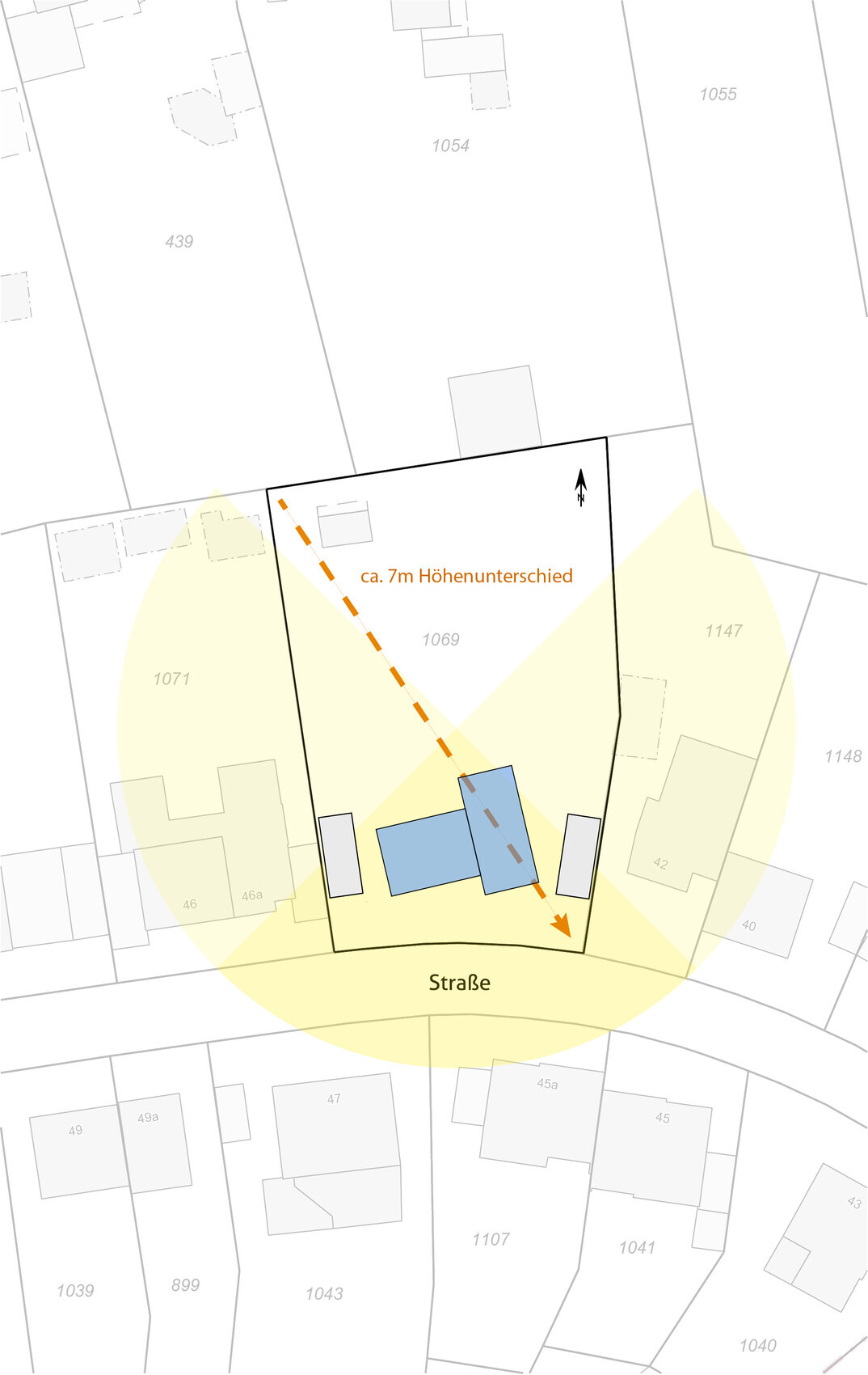

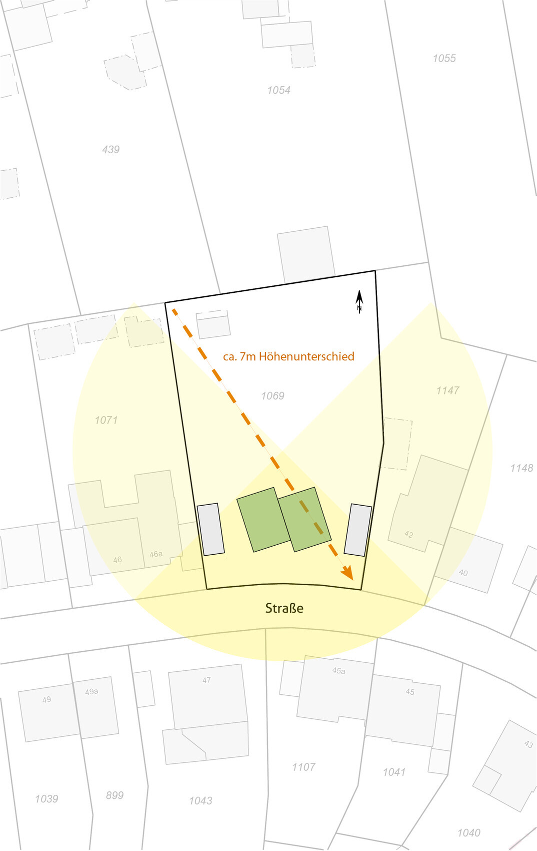

After nearly another month of additional research and gathering demolition quotes, I would like to continue this thread a bit further.
I took the comments from @11ant to heart and did some "drawing":
1.
2.
3.
4.
Please don’t take the sketches too literally. There is still room to adjust things if my naive ideas don’t fit. Also, I haven’t yet considered how the garages might or should be positioned; for now, I just placed them along the plot boundaries.
Option 1 – The Standard: Probably doesn’t need much explanation. The right half has relatively little light in the entire living and kitchen area in the evening. The same applies to the left half in the morning.
Option 2 – Staggered: This way, a window on the west side could provide the right half with a bit more evening light. Unfortunately, this somewhat reduces natural light on the terrace of the right half during the evening hours.
Option 3 – Staggered & Rotated: An attempt to eliminate the downside of Option 2 while retaining its benefits.
Option 4 – Freeform: I’m not sure if this is realistic at all. Because this would likely require two different ridge directions. Whether this complies with §34 in the street remains questionable.
What do you think? Do you have other ideas for a layout that provides good natural light to both sides? I think it’s not possible to balance light equally on both sides due to the fact that the houses are built attached.
