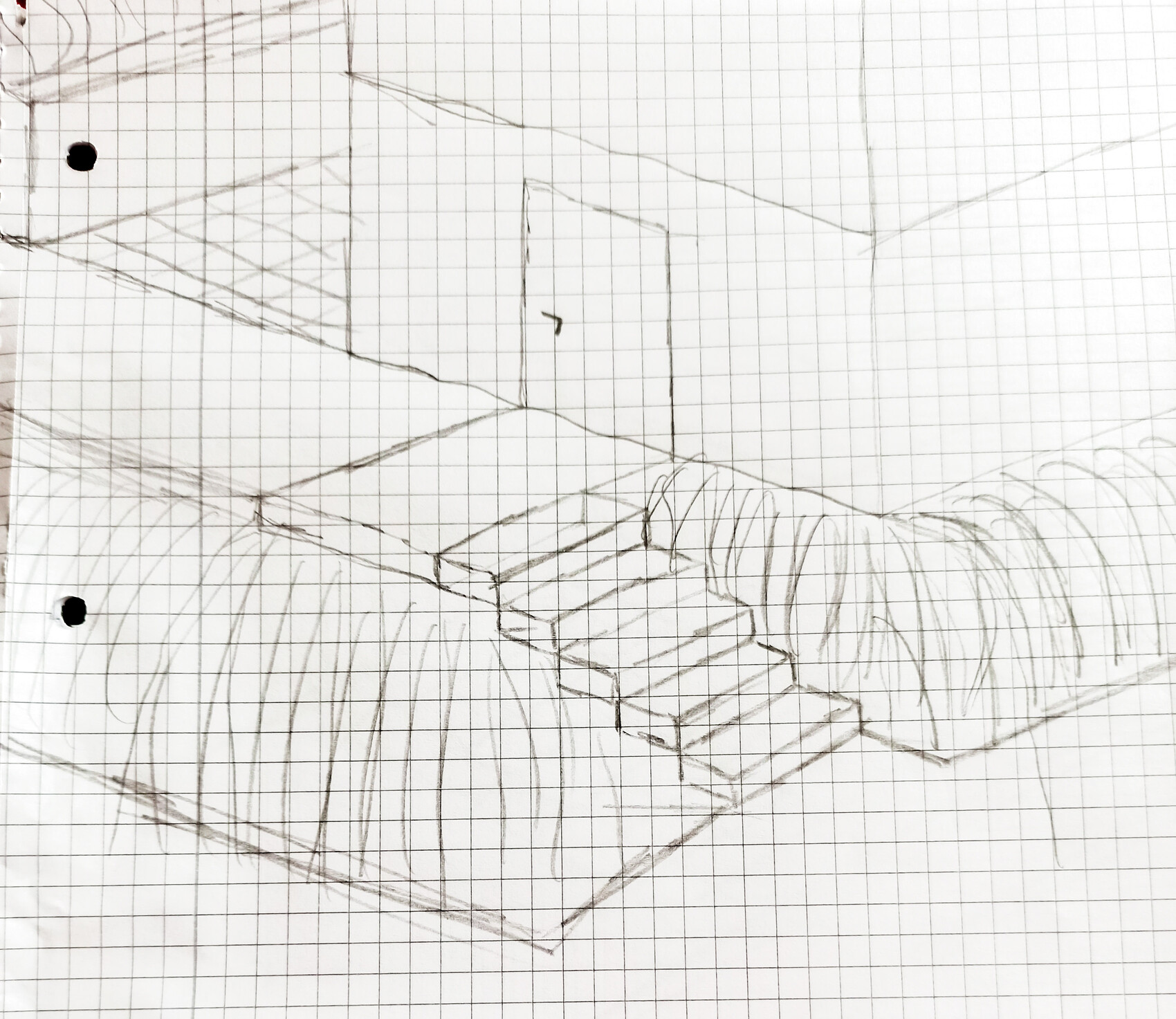

Today we had a follow-up meeting with a prefab house supplier. I’m happy to share details if we eventually choose this provider. However, they came up with a new idea if we wanted to skip the basement due to costs: build a slab foundation on a plateau, so you would basically first have to climb stairs to the entrance.
With this sloping site, stairs up to the living area are unavoidable anyway. And a basement finished as living space will likely be more expensive than just a slab foundation. But in my opinion, the additional benefit is worth it. It simply creates extra space, so the overall size of the house does not have to be as large, which can save some costs and allow for investment in the basement. I also like the possibility of going directly from the car into the house without stairs (for example, bringing groceries straight into a storage room in the basement).

You could also build a slab foundation on a plateau, so you would basically have to go up a set of stairs to reach the entrance first.
With a sloped site like this, you won’t be able to avoid having stairs to the living area. And a basement finished as living space will probably be more expensive than just a slab foundation. But in my opinion, the extra benefit is worth it. It simply creates additional space and means you don’t have to make the house as large overall, which saves some costs that can instead be invested in the basement. Also, I like the option of being able to get directly from the car into the house without stairs (for example, bringing groceries straight into a storage room in the basement).
Sorry, could you sketch that for me? How do you get from the car to the plateau without stairs but still have a basement? I’m not quite following. ops:First, a correction to my sentence
And I also like the idea of being able to get directly from the car into the house without stairs.
Yes, it was a bit mixed up. Let’s clarify briefly:
This is roughly how I envision the implementation with a basement / lower ground floor:
Of course, this is not to scale and is intended only to illustrate the method of integrating into the slope. The terrace is flush with the ground floor, and then the slope is somehow retained. Here, this is indicated with L-shaped retaining walls. This would be the entrance to the ground floor inside the house. Most likely, an additional external staircase to the garden would be planned.
The plateau concept was probably meant like this:
You create a raised building platform that can only be reached by an external staircase, so you avoid having a basement. However, the house would then need to be somewhat larger to accommodate all the desired rooms.

kaho674 schrieb:
I’m not quite following right now.
