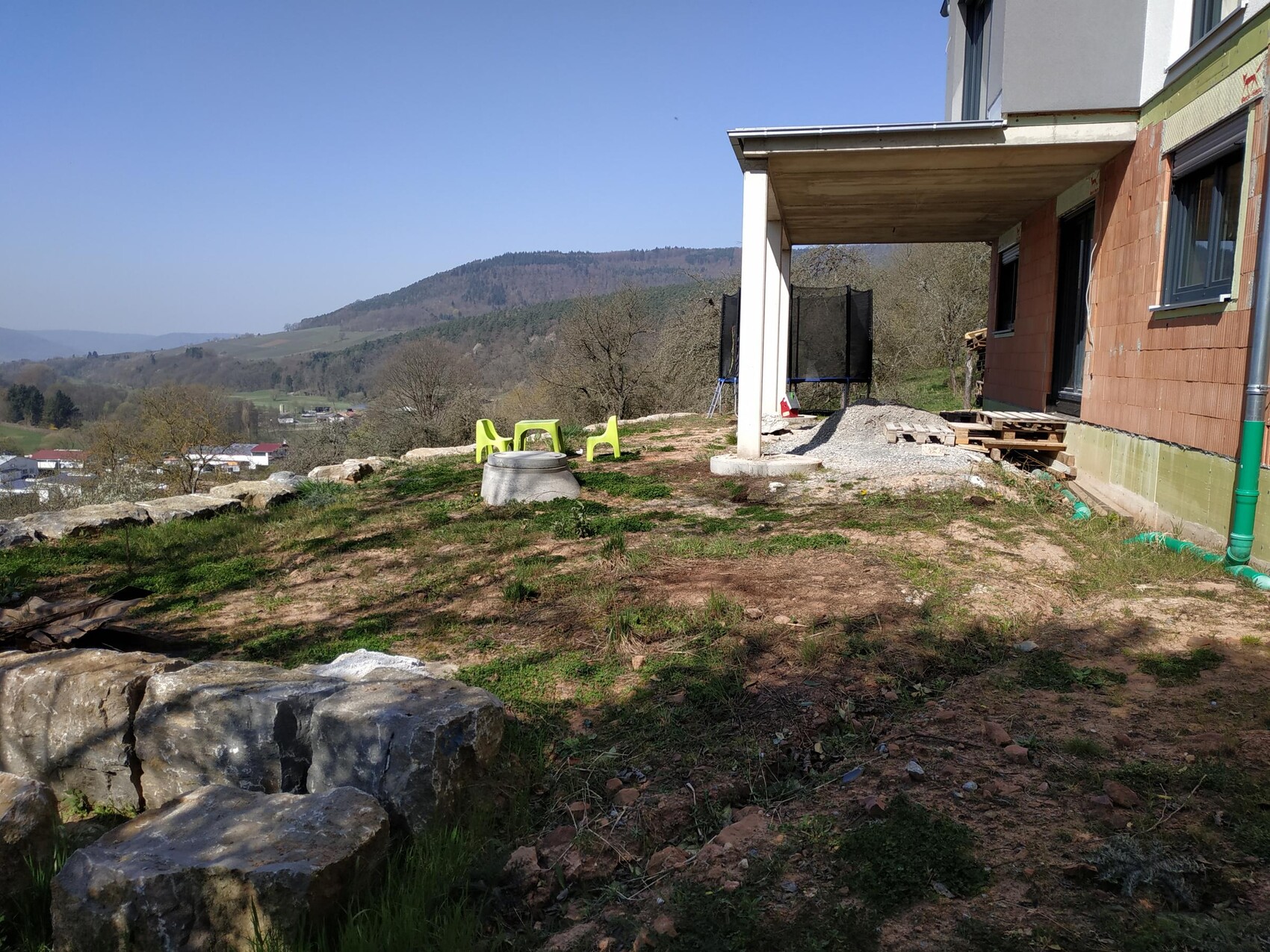

The backfilling will be done above the retaining wall. The terrace itself will be properly supported with frost protection, while the rest will be grass. The area near the wall needs to be sloped.
Unfinished exterior construction of a house with brick wall, pallets, trampoline and garden chairs on uneven yard
The area below the wall will be left as is but will of course be mowed regularly. For this, it will be leveled. In the photo, it looks steeper than it actually is.
