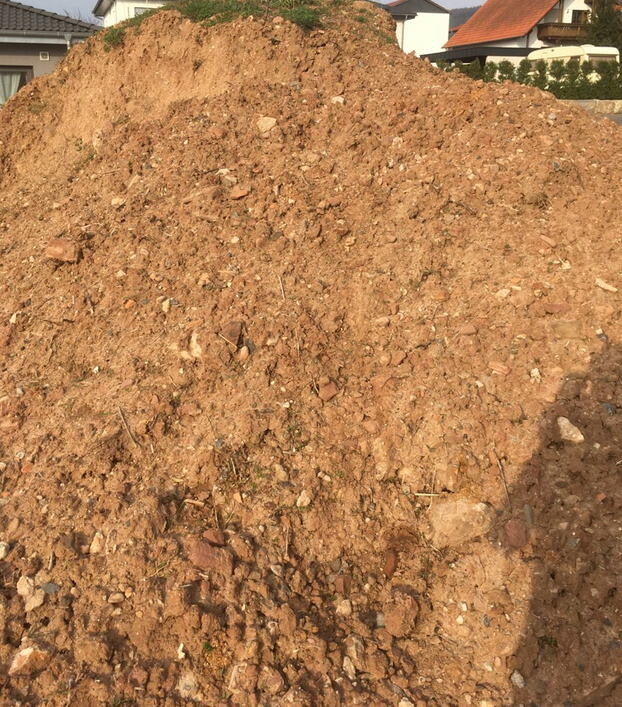

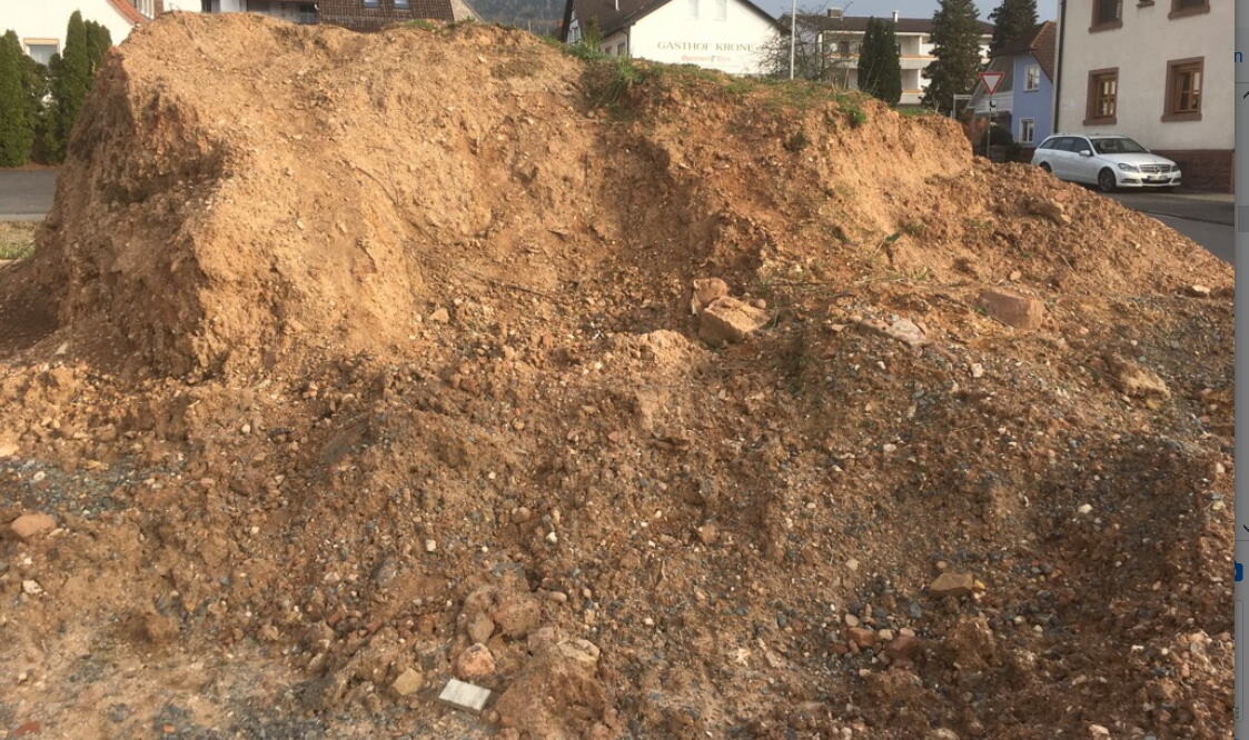

I need to raise my terrace by about 70cm (28 inches) to make it level with our house. This will include 50cm (20 inches) of fill material and 20cm (8 inches) of topsoil, which corresponds roughly to 90 cubic meters (118 cubic yards) and 35 cubic meters (46 cubic yards). Permits are already in place.

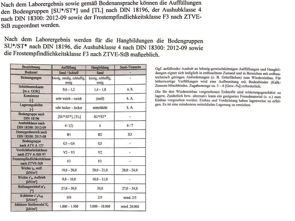

I would like to have the fill material delivered from another construction site. There is a soil report available, which I will summarize as follows:
Here are some recent photos:
The soil is described by the owner as clayey. Do you think I can use this material safely for the fill? The note about soil moisture in the report is a bit concerning to me.

Reini12347 Apr 2020 12:12I need to ask again:
Is the sentence "Reinstallation only in a damp state" not a dealbreaker in the soil report?
