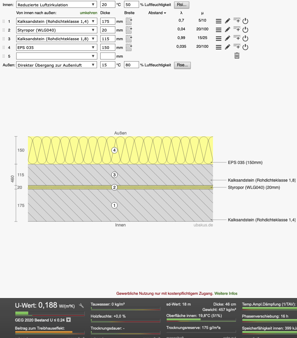

Without external thermal insulation composite systems (ETICS / external wall insulation), I don’t see a heat pump working for you. Gas or possibly pellets would be more suitable. But if I understand correctly, I only need to install 150 mm (6 inches) of EPS insulation, and that should provide more than adequate thermal protection, right? Would a heat pump then make more sense, especially with an existing underfloor heating system? Regardless of the heat pump, it would probably be sensible to insulate the façade here, wouldn’t it? Or should the priority be to insulate the roof and the basement ceiling first?

But if I understand correctly, I only need to install 150 mm EPS insulationYep, then everything looks quite different.bestens schrieb:
Would a heat pump make more sense then, considering there’s already underfloor heating?That depends on the design (pipe spacing) of the underfloor heating system.bestens schrieb:
Regardless of the heat pump, it would probably make sense to insulate the façade here, right? Or should the roof and basement ceiling be insulated first?Insulating the property is definitely not a bad idea, but just insulating alone isn’t the right approach. I recommend consulting an energy advisor, so you can also check if you qualify for any subsidies. It’s no use insulating the façade if heat escapes through the roof, windows, front door, or basement. Also, if the pipe spacing in the underfloor heating is too wide, you will still need hot rather than warm water flowing for it to heat properly.Similar topics
