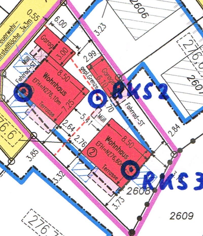

Personally, I think two important background details are missing for your question: a site plan of the plot showing, first, elevation points or contour lines, and second, the locations where the borehole samples were taken. Both are important for interpreting the report, and the first one also serves as a “statement” on the “basement question” (which—even if you are clearly against having a basement—would still be valuable information).

For your question, I personally find two important background details are missing: first, a site plan of the property showing elevation points or contour lines, and second, the locations of the borehole sampling points. Both are essential for interpreting the report, and the first is additionally important as a “statement” regarding the basement issue (which, even if you are clearly against having a basement, would still be a valuable indication).
The property is flat, and we plan to build on a slab-on-grade foundation. The property is being sold by a developer who intended to build two single-family houses on it. I’m not sure if I am allowed to post these excerpts here? The borehole points are, of course, also marked in the report.

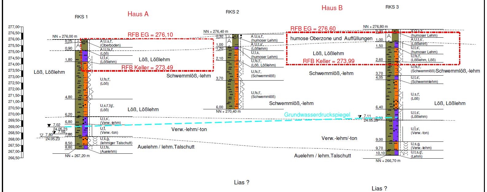

Exactly – well summarized. I’ve posted more information. As I said, I’m not sure if I’m allowed to post this just like that, since I didn’t commission the soil investigation.
What other information would be relevant for an assessment?
Here are the detailed results of the boreholes.
Many thanks in advance to everyone who has contributed here.

Infiltration is common for clay soils. I would avoid a soakaway if possible; if one is required unnecessarily, it should have an overflow to the sewer. Under the driveway, it’s better to use a generous layer of crushed stone, especially if you install permeable paving.
Regarding the foundation, I don’t see anything particularly negative at first glance. Soil replacement is probably not necessary (only if weak layers are encountered). According to the report, you will need a stronger concrete slab, which is not a big issue. They actually recommend only 30–40 cm (12–16 inches) of gravel under the slab.
As a non-expert, it looks fine to me, similar to our building ground. I would only build a basement in such an area using a waterproof concrete shell (“white tank”), and definitely not skimp on the gravel. When landscaping, pay attention to the slope, as water can flow downward underneath the driveway through the gravel. Hello WilderSueden,

What would you want there?Strip footings.
We also have unusable clay up to 2.5 meters (8 feet) below ground level.
Just dumping gravel, compacting it, and pouring the slab on top wouldn’t work for me.
This method, known as "DST foundation," was option 1 in my soil report.
It would probably have been much cheaper but has the disadvantage that you need a 60 cm (24 inches) cushion all around, where excavation work is very limited.
Option 2 was strip footings down to 3 meters (10 feet) deep, reaching the load-bearing layer. That’s what we went with.
And that turned out to be a good decision because when the contractor started digging the trench for the rainwater pipes to the cistern, he began right next to the house without asking.
That’s not allowed with option 1...
