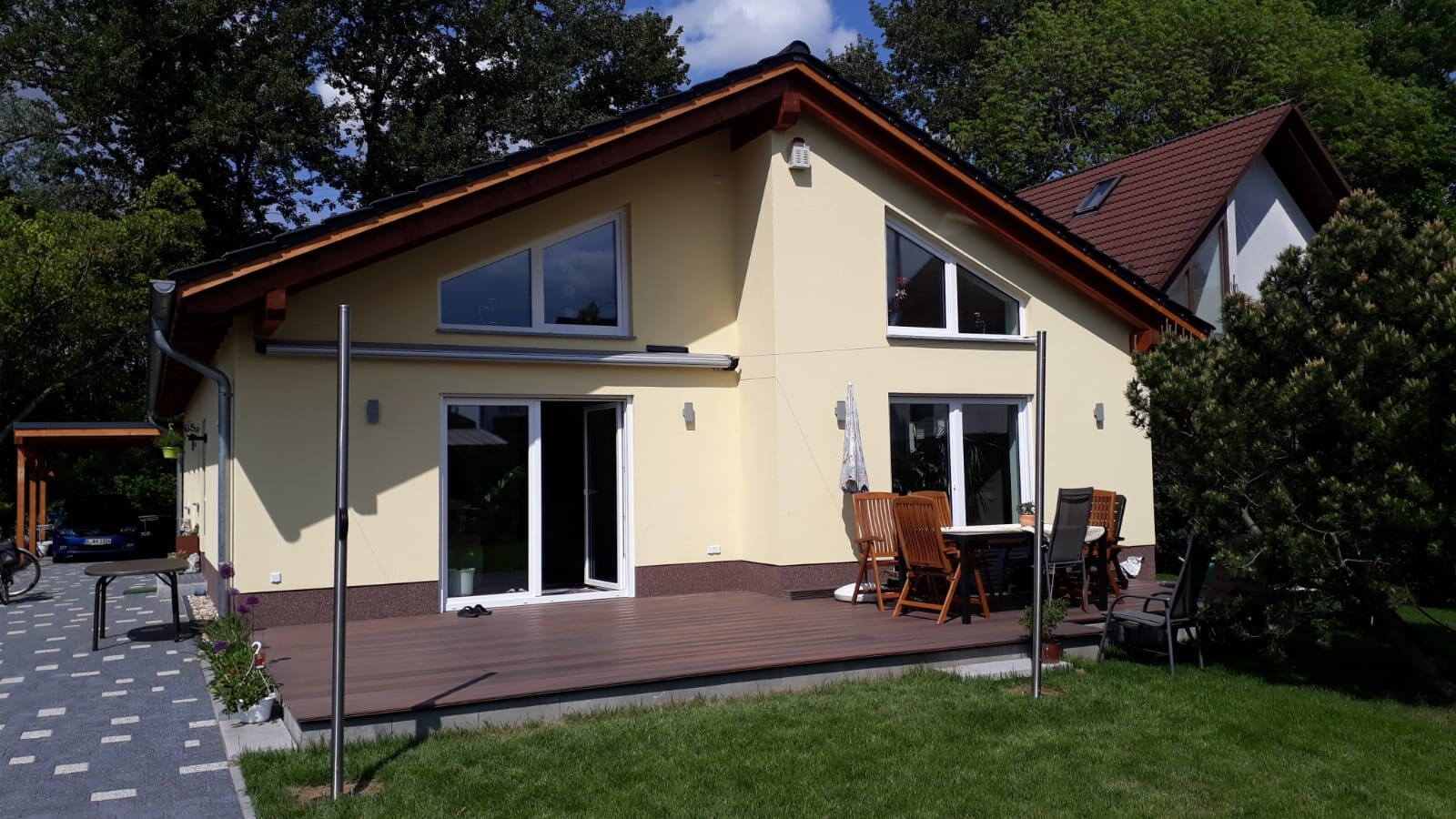

Hans-Maulwurf21 Jul 2020 13:33Nida35a schrieb:
Our sail does not have sensors but is electrically powered with remote control. The maximum extension is 4.8m (16 feet), and the larger the sail, the less the person has to move to stay in the shade.Hello Nida, could you share some information about the manufacturer of your sail, possibly also the costs and maybe one or two photos?
We are also looking.
Thank you very much.
I think that looks good for you. We were considering an awning so that no additional support posts would be needed... otherwise, it ends up looking like a collection of different supports (balcony, awning...). My idea now was possibly to use the balcony post for a glass canopy with a retractable awning/shade underneath on guide rails. That way, only one additional support post would be needed on the far right. But then you have to consider if that really makes that much of a difference... otherwise, the roof would need to extend significantly further out. Or you could try to make it somewhat continuous, meaning what I just described but also extending the balcony as a roof with shading underneath. However, I suspect that would be extremely expensive. The two quotes for two awnings each (uncovered area and balcony) are already around 7000-8000€ (7,700-8,800 USD).
Nida35a schrieb:
@Effe2020
Our alternative was the Weinor Plaza Viva pergola awning,
not too bulky either, just try visiting sun protection exhibitions,
with your photos on your phone What is the approximate price including installation, etc.? What size?
