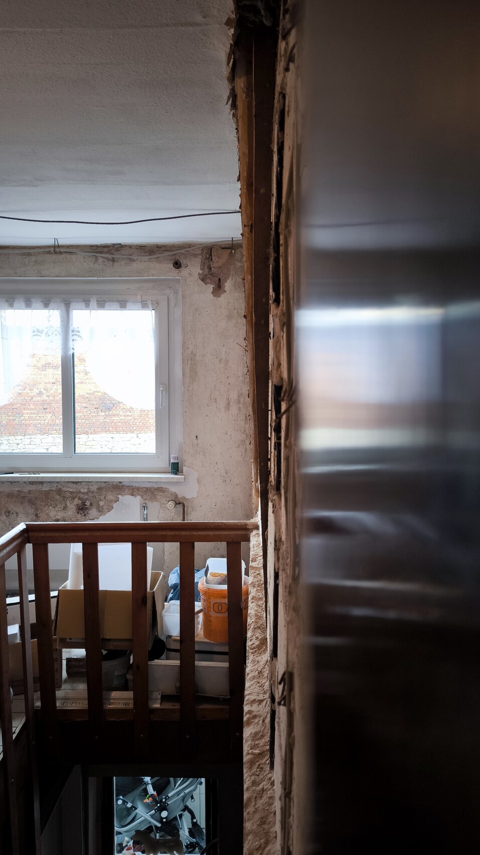

Good evening,
it seems that a beam in our house was installed crookedly. This is now causing the problem that I can't get a straight wall there.
Do you have any ideas on how to fix this?
Best regards, Jens

11ant15 Apr 2025 00:20
Jens Kaufmann schrieb:
At our house, a beam was apparently installed crookedly. This is now causing the problem that I can’t get a straight wall there.
Well, what exactly does a crooked beam mean? To me, that looks like a perfect roof rafter, viewed from the side in a room with a dormer or similar. The rafter is probably hand-hewn, not as perfectly straight as modern milled timber. What’s the problem if this is covered again with an authentic plaster that’s not perfectly smooth?

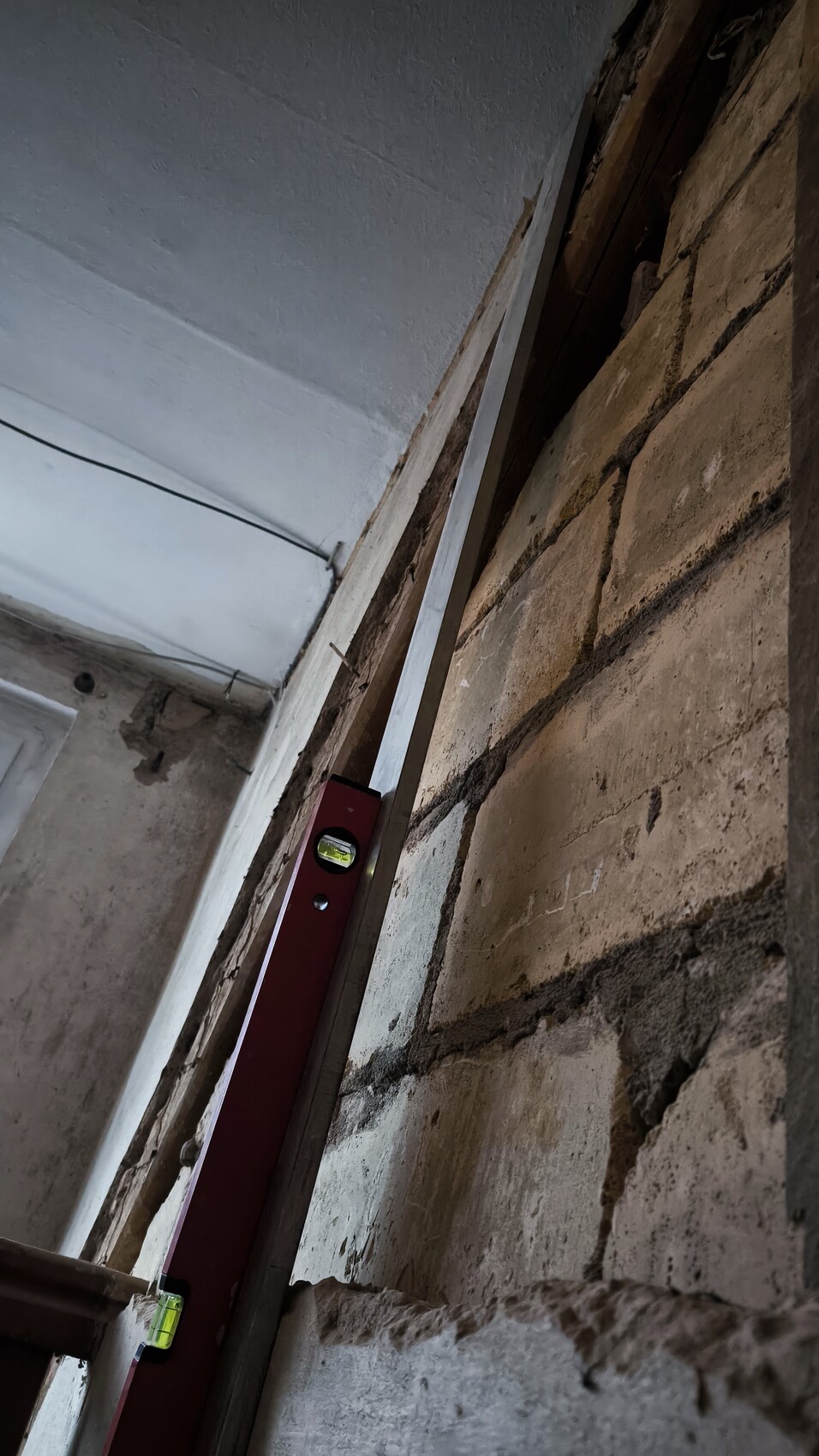

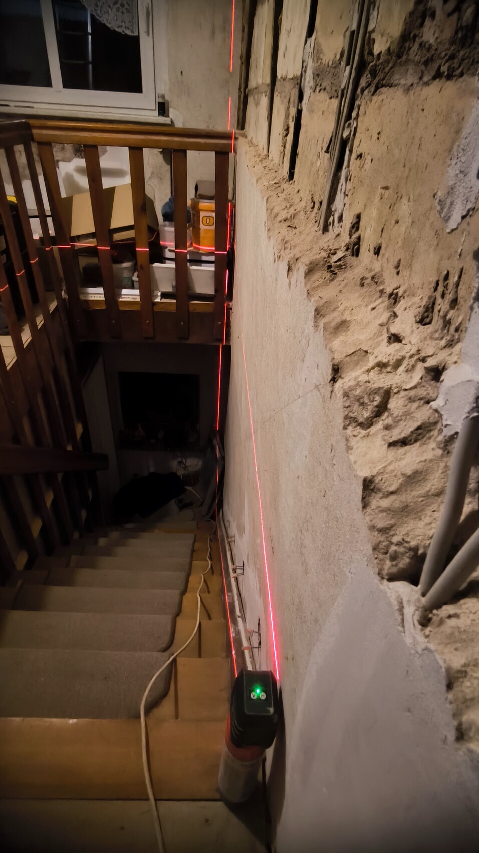

A plasterer can do it exactly the way you want.
There are also people who manage to get it straight using drywall (plasterboard). It can be installed on a supporting battens or glued.
For DIY, the batten method is probably the easiest.

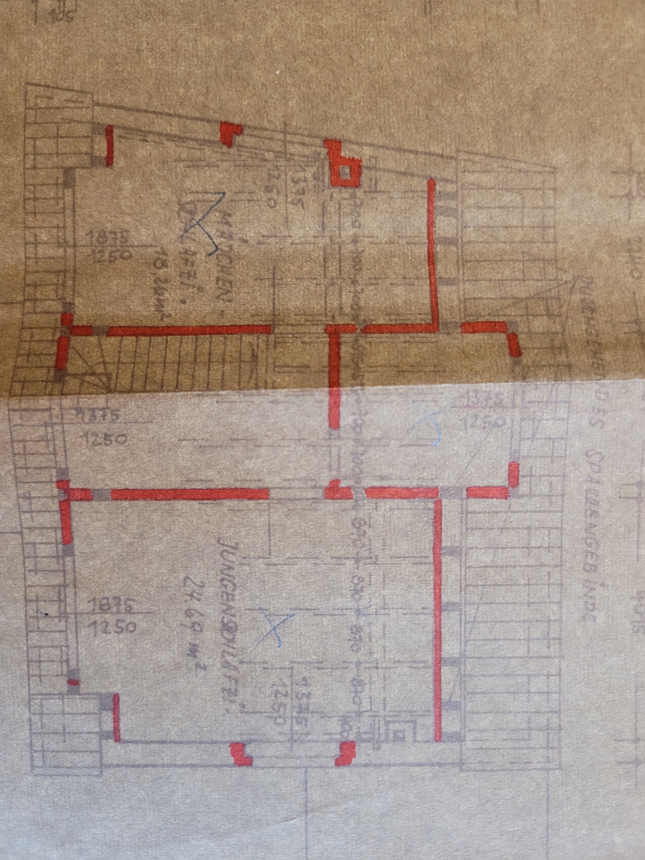

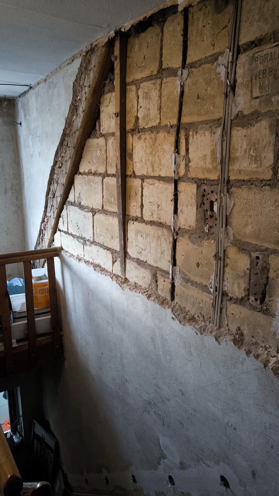

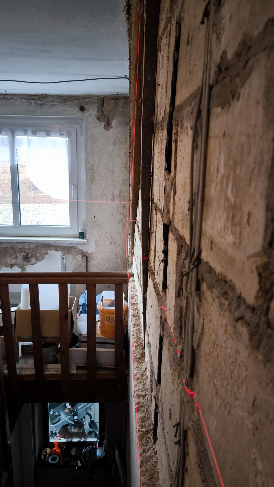

16 Apr 2025 21:48
I only have the building plans from 1972. The rafters are marked in red. The rafter should run parallel to the staircase, but unfortunately, it does not.
Even if I extend the wall up to the staircase frame, the rafter would still protrude at the top (see photos).

17 Apr 2025 09:24
What speaks against leaving the beam permanently exposed? It can be carefully finished and highlighted with color. It should be visible that the beam is technically necessary.

17 Apr 2025 09:56
hanghaus2023 schrieb:
What speaks against leaving the beam permanently exposed? Clean it up nicely and highlight it with color. You should be able to see that the beam is technically necessary.
I see it exactly the same way, and in my opinion, this actually gives an old house more "character." I would therefore focus my energy on how to make it look nice or integrate it into the design, rather than trying to hide it. There are surely many ideas for this. The beam could possibly be sanded down a bit and maybe used as a base for a rope lighting system for the staircase, or the wall around it could be creatively painted, and so on.
