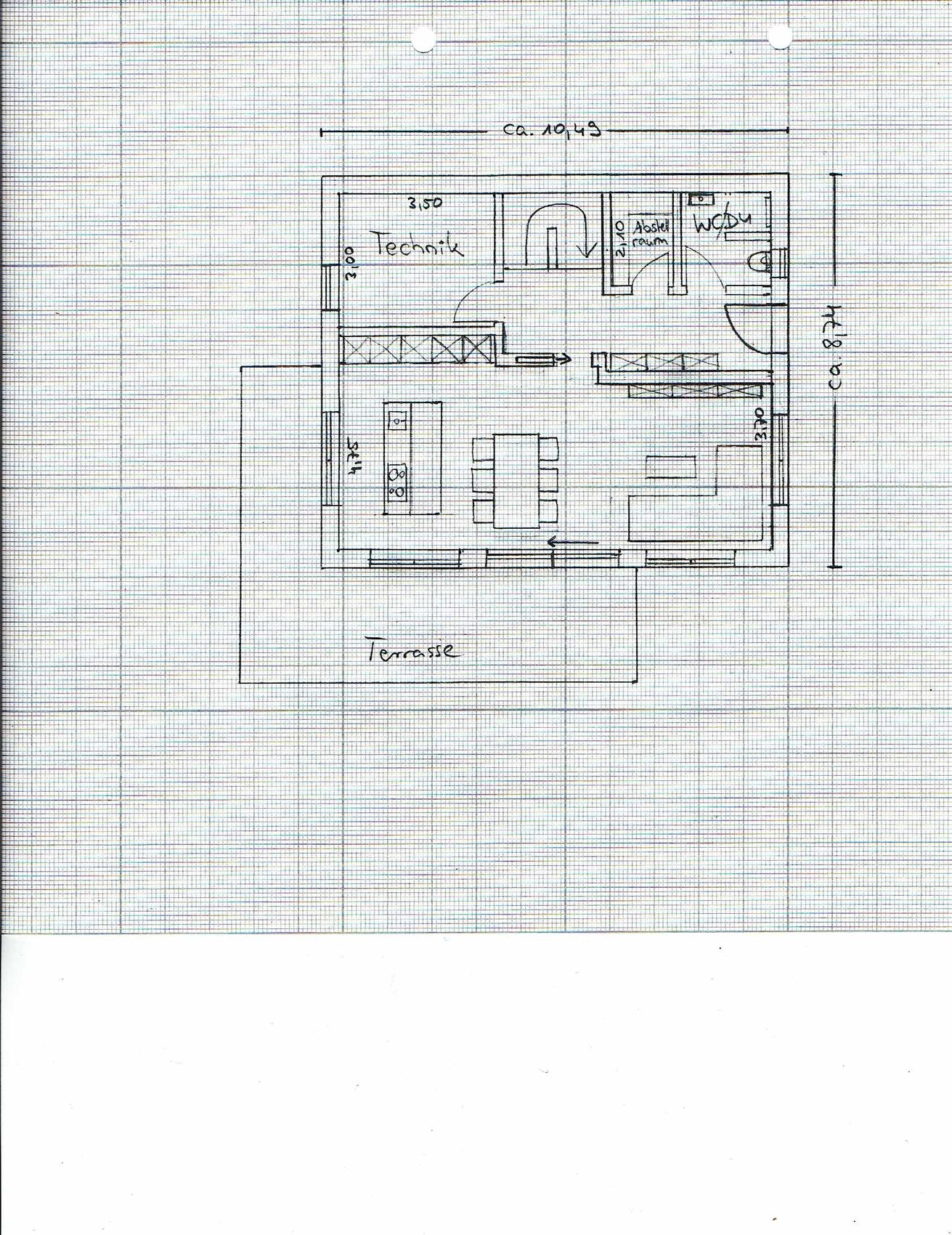

So, we have now drawn up a new design. Compared to the first draft, we mainly changed the following:
- House is overall 25 cm (10 inches) wider
- Living room and kitchen swapped
- Hallway slightly wider
- Office on the ground floor removed
- Small storage room added on the ground floor
- Office instead of walk-in closet on the upper floor
- Children’s room and bedroom swapped on the upper floor
