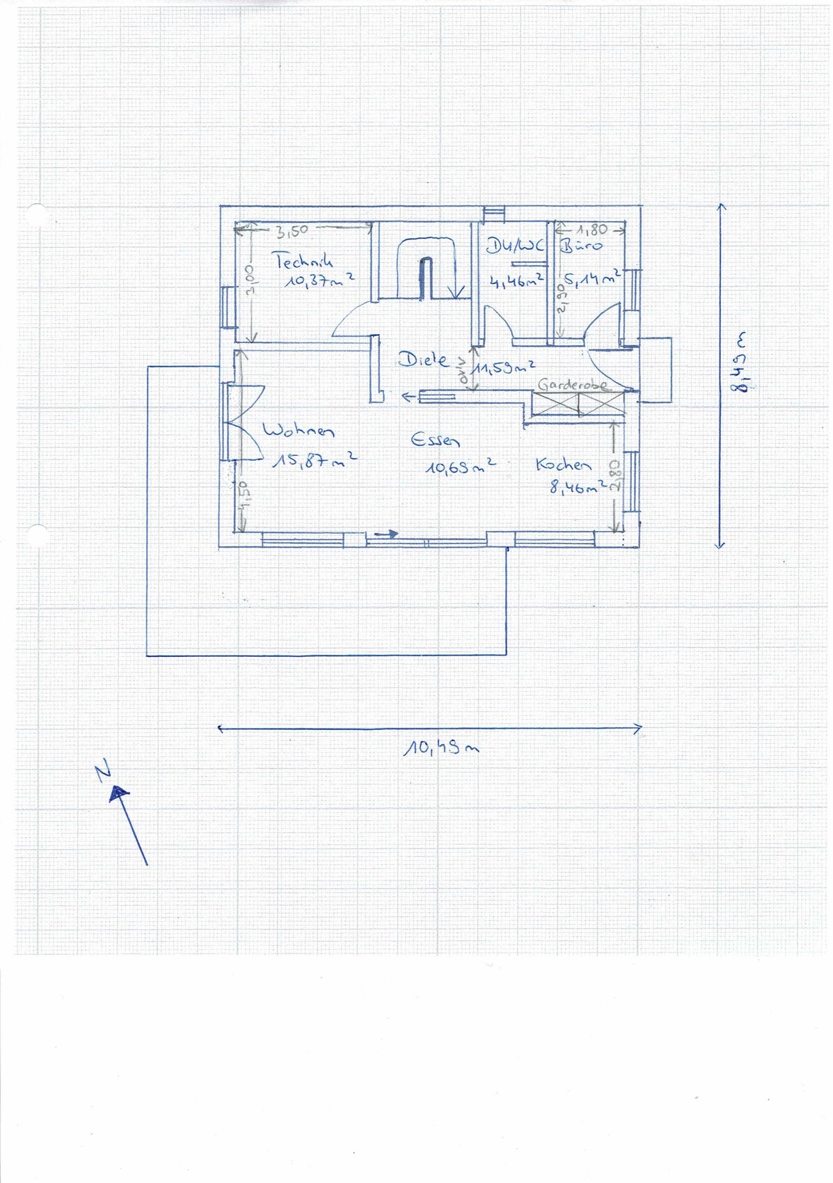

After a long search for a suitable plot, we have finally found one. We are buying a turnkey house from the developer, who provided us with three floor plan options. Two of them were immediately dismissed by us, and the third one comes closest to our ideas, but we are still not fully convinced.

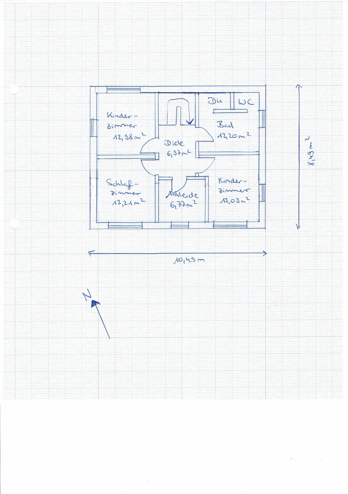

We like the layout of the upper floor and would like to keep it as it is.
However, the ground floor is causing us some headaches. Specifically, the area around the living room/dining room/kitchen. The current plan features a U-shaped kitchen, but we would prefer a solution with a kitchen island. For that, we would need more space. In our opinion, there is too much space in the living room to accommodate this. The distance from wall to wall is 4.50 meters (15 feet), which, in our view, makes the distance between the sofa and the TV too large. (Note: Our current living room measures 3.40 x 4.50 meters (11 x 15 feet), meaning the distance between sofa and TV is 3.40 meters (11 feet), which we consider optimal.)
We have therefore considered swapping the living room and kitchen. This would allow the kitchen with an island to fit, but the living room would then be too small because the width there is only 2.80 meters (9 feet), due to the wardrobe recess. We do not see another place for the wardrobe, as the hallway does not offer much space.
We are hoping for suggestions or ideas for improvement.

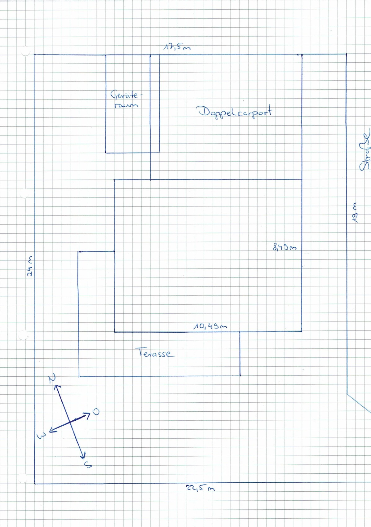

Plot size: approx. 430 sqm (4,630 sq ft)
Slope: no
Site coverage ratio: 0.35

Garage, carport: double carport

Does it make sense to swap living room and kitchen (see problem description above)? If yes, where else could the wardrobe be placed without making the hallway too narrow? Is the office size still adequate?
We would appreciate any suggestions or ideas for improvement from you.

I think the floor area is too small for so many rooms on the ground floor. That’s why you’re having difficulties with the kitchen and the living room.
One idea would be to give up the office (which might not be used much anyway) and turn that space into a cloakroom. This would allow the cloakroom area to be set back again. If it stays as it is, I definitely don’t see space for a kitchen island. But of course, that’s not always necessary.
We have a similar layout. Our house is 50cm (20 inches) wider but 25cm (10 inches) shorter, and because of the space, I would never have thought to squeeze in an office there (and you still have a utility room).
tomtom7928 Oct 2018 16:33
Entrance area is too narrow, consider swapping the guest room and moving the bathroom back.
Upstairs, I would skip the walk-in closet because once furnished, it doesn’t really add any benefit.
Better to make the children’s rooms larger.
Otherwise, the layout is quite good for 130m² (1400 sq ft).

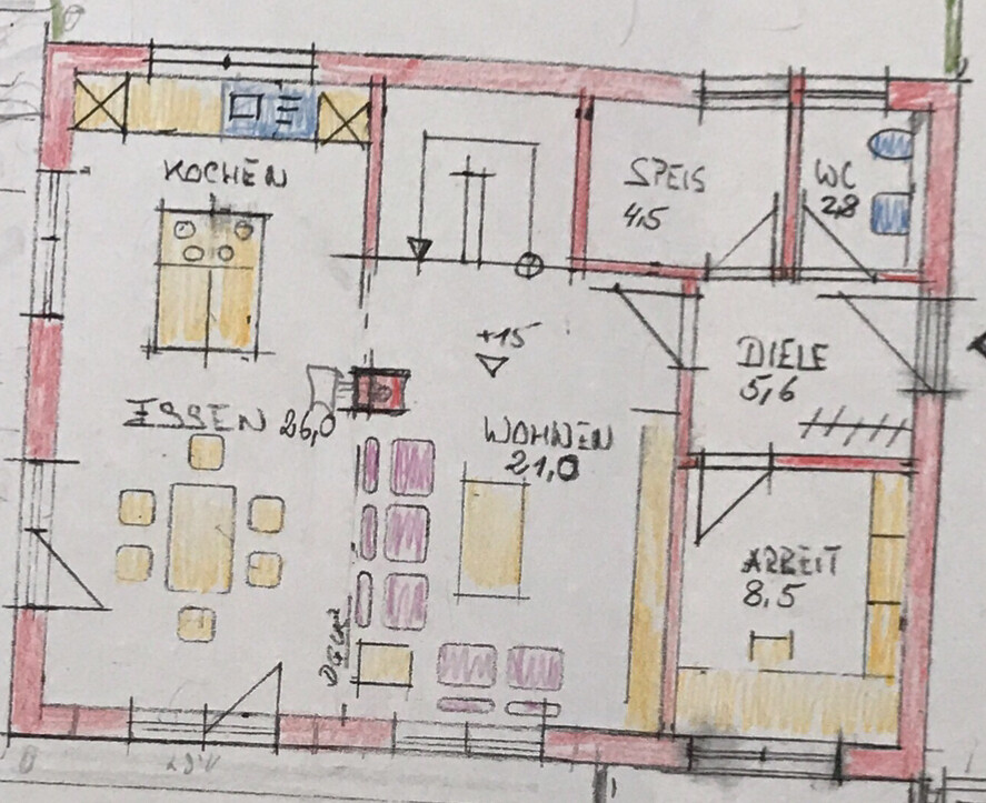

To give you a few more ideas, here is our first draft.
Now imagine the fireplace removed. Move the hallway door as far down as possible and enlarge the pantry, also known as the utility room, and the guest toilet. The drawing is based on a floor area of 11 m x 8.25 m (36 ft x 27 ft).

1.10 meters (3.6 feet) is the hallway width on the ground floor... that is far too narrow. In our terraced house, we had about 1.30 meters (4.3 feet), which was still too tight for comfortable entry and exit.
When you open the coat closet door, there’s no room to move. A stroller makes the hallway impassable.
34 square meters (366 square feet) for the living, dining, and kitchen area is too small for an island.
What is the ground floor shower for? With a house this size, guests usually stay in a hotel. The staircase should be closed off so that a storage closet can be placed underneath. Instead of a dedicated office, there’s a laptop on the sofa and no walk-in closet. Possibly, there could still be a storage room upstairs, which is necessary.
haydee
28 Oct 2018 17:24
I would skip the island.
Painting the home office won’t work; it’s so small that it would feel cramped.
Paint the shower area on the ground floor.
Upstairs, I would paint the walk-in closet. In return, make the bedroom a bit larger so that a wardrobe fits.
