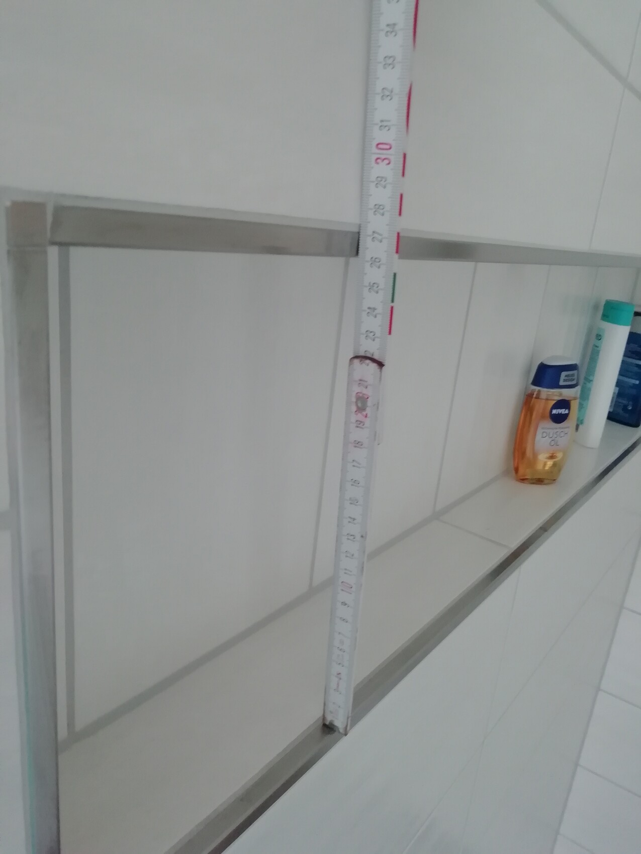

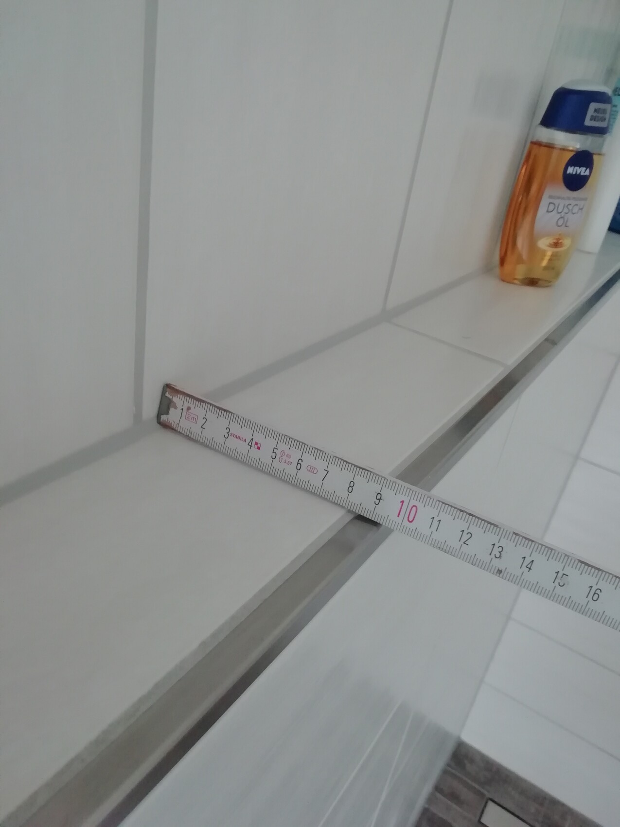

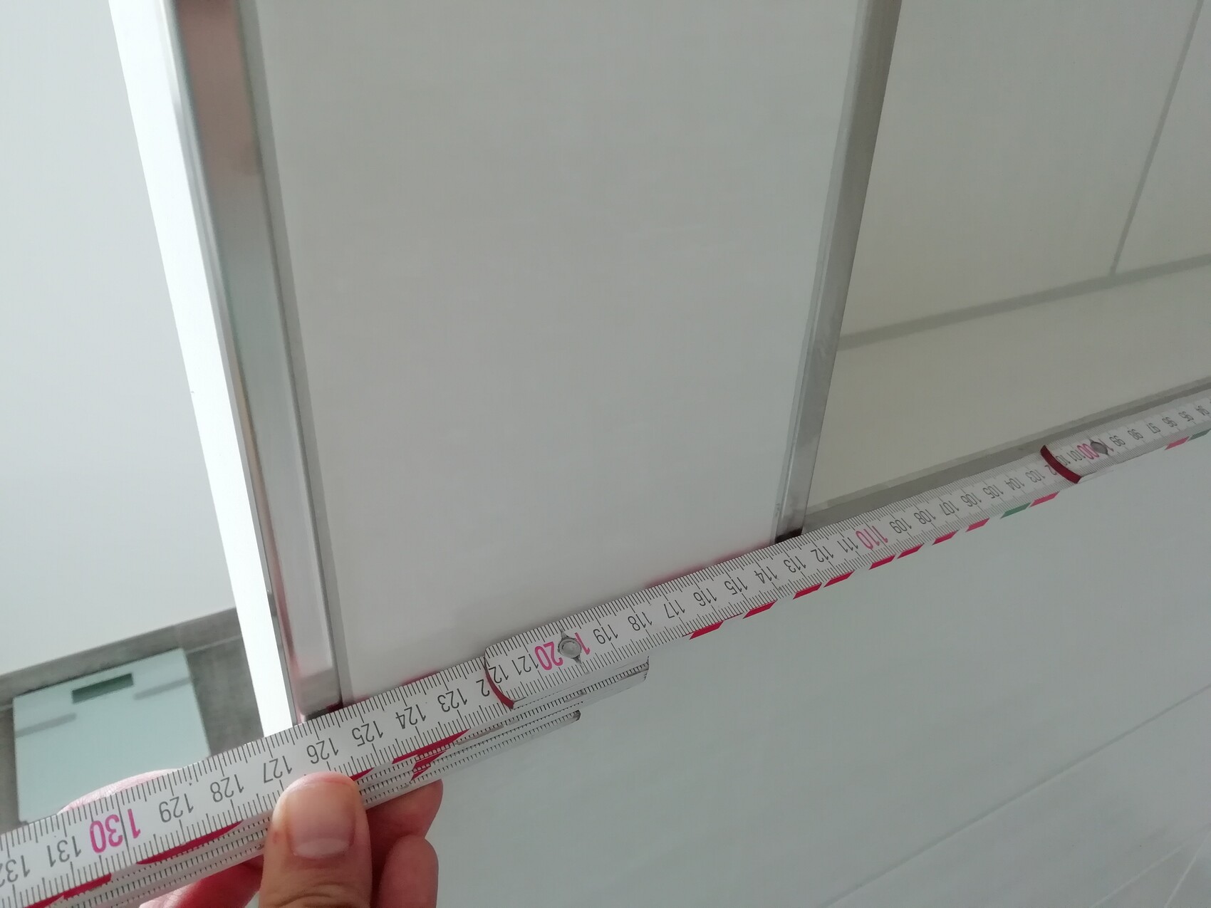

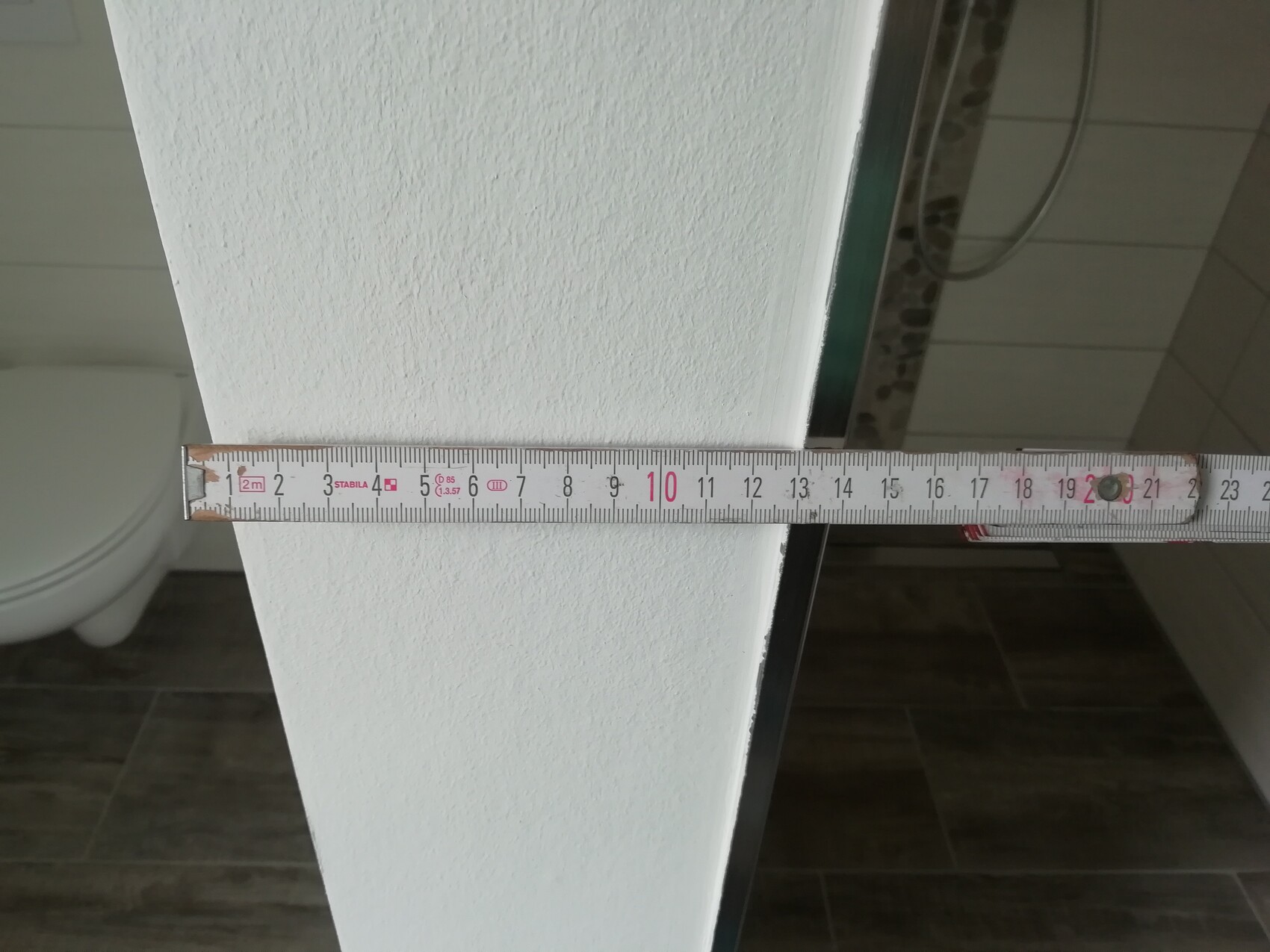

[ATTACH alt="IMG_20190705_214253.jpg"]36504[/ATTACH]I like something like that too. How thick is the wall with the niche?Andre77 schrieb:
I like something like that, too. How thick is the wall with the niche?Freshly measured, attached.
The last picture shows the width of the niche.
I don’t think it’s possible to implement something like this in an 11.5cm (4.5 inch) interior brick wall. Even if the recess were a bit less deep, there’s basically no material "behind" it towards the other room. Or does anyone see this differently?
