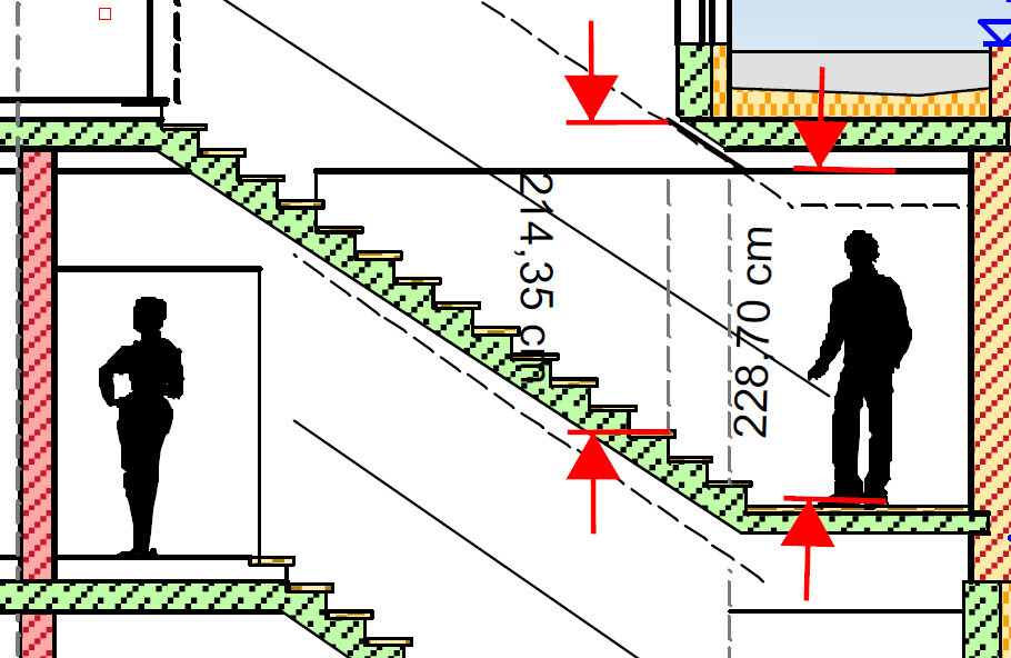

@hasa222 ... then you haven’t fully understood the problem with the staircase yet:
Your clear ceiling height is about 12cm (5 inches) higher than in my drawing. However, in your floor plan, the fourth step—not the third—is already located right under the edge where it opens up. In other words, 202 + 12 - step height = approximately 195cm (77 inches). So, if someone is coming down from above and stands on the fifth step, they will basically hit their head on the edge.
EDIT:
For a clear ceiling height of 270cm (106 inches), it still seems to me that too few steps are shown.

hasa222
14 Oct 2016 08:13
kbt09 schrieb:
@hasa222 ... then you haven’t fully understood the staircase issue yet:
Your clear room height is about 12 cm (5 inches) more than in my drawing. However, in your floor plan, under the edge where it becomes open, it is already the fourth step, not the third step. So, 202 + 12 - step height = approx. 195 cm (77 inches). And if someone comes from above and stands on the fifth step, their head will basically hit the edge.
EDIT:
For a clear room height of 270 cm (106 inches), the number of steps shown still seems too few to me.
I have attached our stair section. Do you really think the indicated headroom is too low or that the staircase looks odd because of it? To ease the whole situation, the only options I can think of are:
- Reduce the riser height (which would eliminate the landing)
- Extend the run (however, this would make the entire building larger or alternatively reduce the size of the living room / hallway / terrace)
