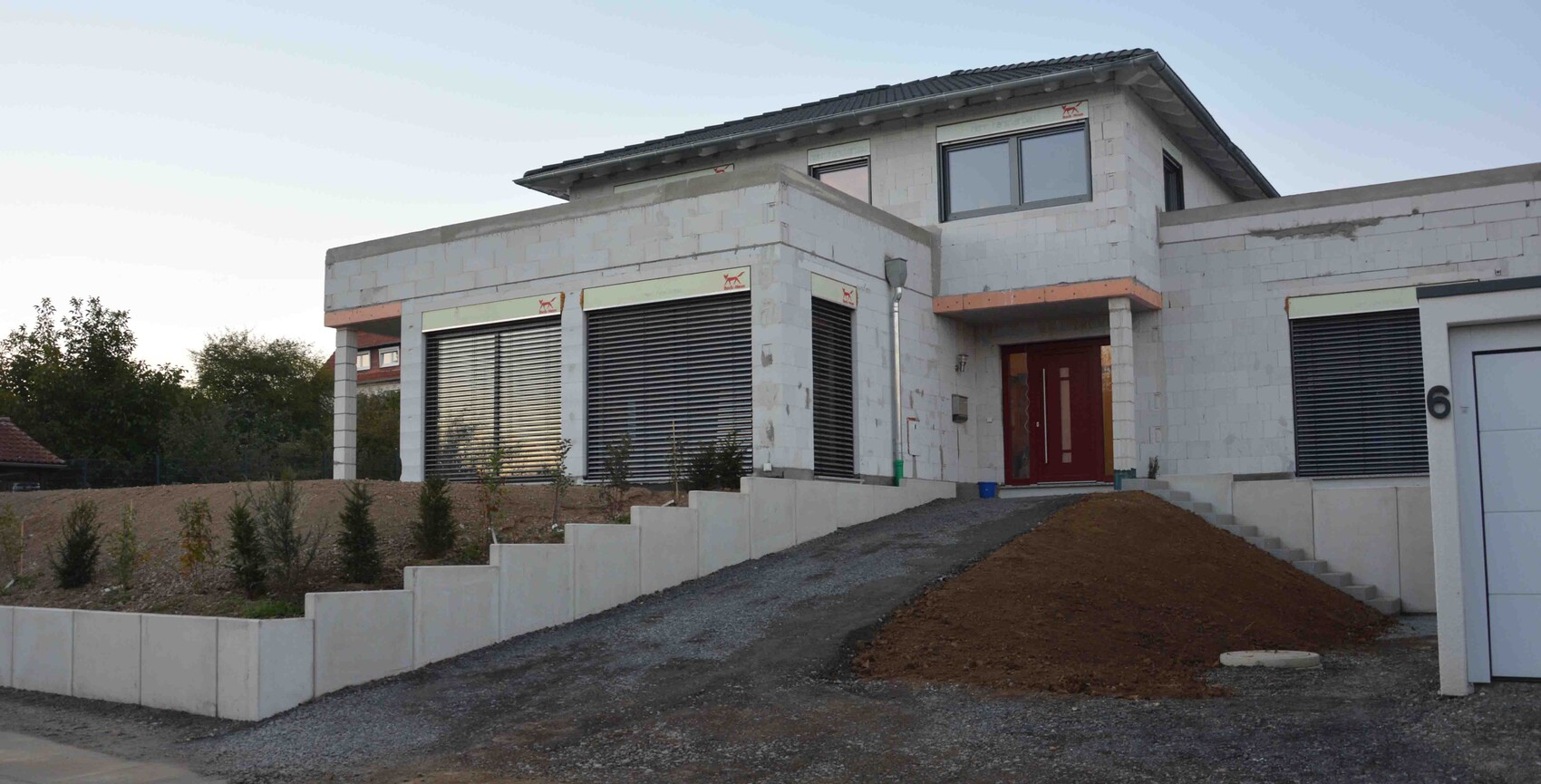

AxelH. schrieb:
We did something similar. The garage is located significantly lower. Our L-shaped retaining blocks behind the garage are 1.30 meters high (4.3 feet). From there, you can either take the stairs or the ramp without steps to the house. In between, we also have a slope.
Axel
Yes, it will be similar for us too (with a different overall layout), although we have to overcome much less height difference.
I think you used the L-shaped blocks well... they don’t look as ugly as one might usually expect.
Yosan schrieb:
Yes, something similar (with a different overall layout) will be the case for us as well, although we have to compensate for a significantly smaller height difference. I think you used the L-shaped concrete blocks well... they don’t look as ugly as people often fear. Thank you very much for the compliment. I also believe that L-shaped blocks can be quite effective. Of course, they need to match the style of the house. Since clear lines and geometric shapes define the overall design in our case, they actually fit very well.
Regarding the height difference: we had to raise the house that much because we have a basement and wanted to avoid using a pump for drainage. Pumps can fail, but a natural slope always works.
Axel
