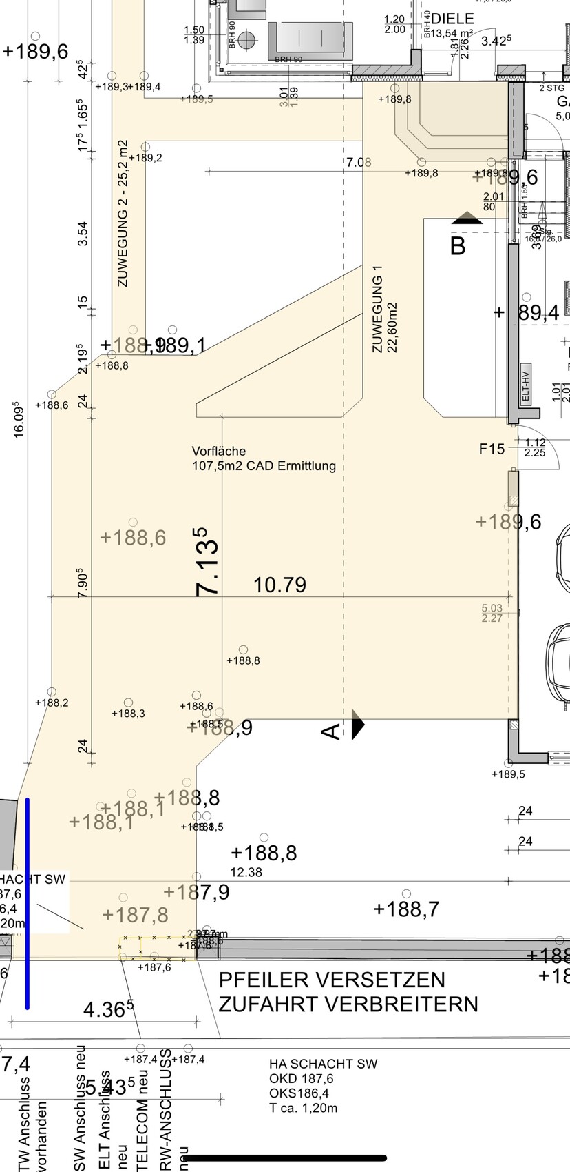

Originally, we planned a solid construction house with an architect. Due to the uncertain market situation and potential cost increases with individual contracts, we have now decided to go with a prefabricated house provider and are therefore switching to timber frame construction. The floor plan remains largely unchanged, but the new construction method requires some adjustments:
The architect planned two or three steps as well as a concrete slab with a raised edge in the outbuilding. The prefabricated house provider rejects this, arguing that both buildings must be at the same level. Direct contact between the exterior wall and the foundation/reinforced concrete wall would lead to moisture and long-term damage. The height difference is small and is better compensated through the foundation.
However, the section shows a critical height offset. Possible solutions would be:
Elevations, sections, and floor plans are attached – I look forward to your feedback!
Thanks in advance!
- Lowering the house (possibly with disadvantages for drainage, daylight, and appearance),
- Separating the garage and designing the transition with steps,
- Or leveling the front height already and building the garage higher (steep driveway)
Thanks in advance!

The slope leading to the garage is manageable for any car without problems. 😉 In my opinion, the paver doesn’t really care whether it’s a 2% or 5% gradient.Well, the slope in our case would be almost 19%. That is a height difference of 1.8m (5.9 ft) over 9.5m (31 ft) to the garage. Or am I mistaken?
HeinzBosslauch schrieb:
Well, the slope on our site would be just under 19%. That’s a height difference of 1.8m (5.9 feet) over 9.5m (31 feet) to the garage. Or am I missing something? I’ll take a look at the rest shortly. For now, regarding this:
19% is quite steep purely based on the numbers (if still current), and it might get even more challenging. You would need to flatten the start and end of the slope so that cars (depending on the type) don’t scrape the bottom. The consequence: the rest of the slope would become even steeper.
Slopes over 20% (which you will likely reach here due to flattening at the beginning and end) are definitely tricky. It becomes especially difficult in snow and ice conditions.
I would recommend seeing this kind of slope in person (somewhere with similar inclines) to get a feel for how manageable it is. Also keep in mind that in winter weather with snow and ice, driving up could be very problematic.
(I used to live near the Sauerland region where there were several slopes like this. With an underpowered small car, it was only possible to climb them in snow if I had enough momentum. Starting from a stop or crawling uphill slowly was not an option. Since I no longer live there, I haven’t been able to test it with a standard car.)
Is that height difference still accurate according to the current plans? If the house and garage can be positioned slightly lower (if feasible), it would significantly reduce the slope gradient.

Is this elevation difference still accurate according to the latest plans? Even lowering the house and garage somewhat on the site (where possible) would reduce the incline noticeably. Yes, I have seen something similar near us, and it’s really not ideal. They installed heating in the driveway, but due to the steepness alone, it’s still not perfect regardless of the season.
Our plan is to have the designer review this thoroughly and, if necessary, lower everything a bit. I think lowering by about 20–40cm (8–16 inches) would help, but there’s always a trade-off with the terrace behind the house and the transition to the garden.

Thanks for your feedback. Here are the elevation details from the plan.
hanghaus202329 Jul 2025 21:00In my opinion, it is 1.5 m (5 feet) by 15 m (50 feet), which is 10%. That is still acceptable.
